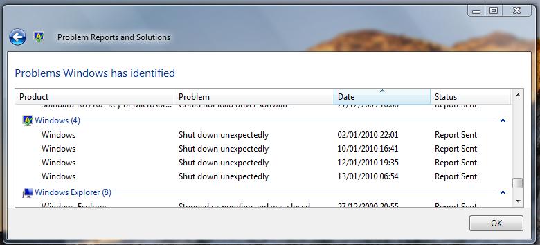

But AidenShaw's brochure says Windows BSOD is only a myth these days??? :confused:
In accordance to the scripture of a devout Mojave's Witness. :p
BSODs are as rare as kernel panics.

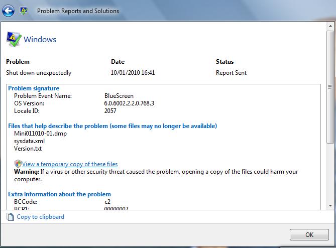

So rare, that Windows actually has an event/error called "BlueScreen." :)
O'rly?
(I was wrong tho, it was 3 BSOD's in 4 days and one on my Birthday - January the 2nd)
Not a single Kernel Panic on the hackintosh side of things either.... Strange.

Any progress on the blue screens?
Had another one yesterday but I have no ideas why they are happening. :(
I've sent the reports off but there is no solution from Microsoft so far.
I shall await a response for one of my crash reports. Thanks for asking! :)
One thing to try - Windows has a "verifier" mode where it performs lots of extra consistency checks on the way that kernel APIs are called. If it finds a problem, you'll blue-screen in the verifier with the bad driver called out.
I helped a friend build a Win7 Core i7 system - it ran fine for about two weeks, then started randomly crashing (sometimes while in use, sometimes he'd turn the monitor on in the morning and a BSOD would be there). Memory testing (both with Windows built-in memory tester, and with Memtest86+) showed no problems.
Turned on the verifier, and it wouldn't even boot - crashed every time early in boot (at the fuzzy flag logo). The bluescreen said "error during verification" and showed the name of a driver for a gaming mouse. Removed, then updated that driver - happy now.
The verifier has a clever command name - "verifier". Read about it at http://msdn.microsoft.com/en-us/library/ms792861.aspx
Just pick the standard options - the optional tests are torture tests for out-of-memory and other conditions.
Note that if you're lucky enough to get an immediate bluescreen everytime on booting, you'll need to boot into safe mode and either turn the verifier off or uninstall the bad driver to fix it.

Dohoho.... virtually every BSOD is caused by third party drivers OR bad hardware.
I would tell you to look it up but it's not like if you were able to make sense out of this.
And "Windows 7 runs fine in boot camp but OSX kernel panics" or "OSX runs fine but
Windows 7 BSODs constantly" does not mean that it's not hardware.
When I worked at Digital in the '80s one of the mainstream MicroVAX systems would run VMS
without issues, but would crash frequently when running UNIX (Ultrix).
It turned out to be a hardware design error in the memory system, not a UNIX bug.
(SDRAM needs to be refreshed periodically or the memory cells lose state. A bug in the MicroVAX
memory controller would forget to refresh banks of memory that weren't touched for a second or so.
It turned out that VMS allocated physical pages of memory quite randomly, so it was very
unlikely that a bank of memory (containing many pages) wouldn't be touched.
UNIX was more "orderly" about allocating physical pages (even though there was no benefit to
doing that), and would frequently end up with big regions of physical memory allocated to a
single process. If that process were idle for a few seconds, it could wake up to find large
chunks of memory reset to zeroes. This would cause an application crash for userland memory,
or a system kernel panic if it were process-specific kernel memory.
The "fix" wasn't to change the hardware, but to put code into the timer routines (on both VMS
and UNIX) to touch each bank of memory often enough to force a refresh before data was lost.)​
Long anecdote, but it shows that the crashing OS can be blameless.
