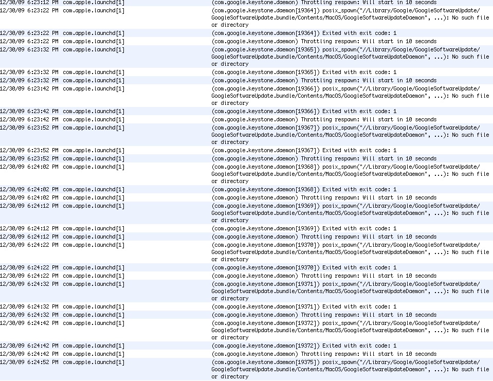

Hello,
A while back, I discovered that Google Earth's auto-updater was running CONSTANTLY on my 2008 MBP. My first instinct upon seeing the massive log in Console was to uninstall Google Earth. However, this didn't stop the updater from continuing to run, even tho I've got no other Google apps on my Mac - nor have I ever had any other Google apps on my Mac since day 1.
Ironically, I've Googled to find a solution to this problem. 🙂 I found a few suggestions, which I tried - but the dang thing keeps right on running. As you can see from the attached screenshot, it's an evil spawn!
Sure would appreciate somebody coming up with a way for me to get this monster off my Mac. Would like to still use Google Earth if possible, as it's a great app, but it's not worth the havoc it's causing to my system.

Thanks for the reply angelwatt. I reviewed that thread. I tried pasting the command into a terminal window (had found this potential solution elsewhere, and it didn't work before, but I tried it again anyway), but get a "command not found" response.
In the meantime, the updater continues it's irritating attempts to connect every minute. It's really obnoxious...if it were a rogue app, one would call it malware...
Thanks gr8tfly. That's a great page. I found it yesterday and was excited to see such complete removal instructions. I *knew* it would work! I went thru the steps as instructed, but after completing them, I was bummed out to see that the messages continued to come, as shown in my screenshot. That's when I decided I'd better look for help, and I came here.
However, in case I did something wrong the first time, I reinstalled Google Earth and then reapplied the instructions. My Console is *still* filled with Google's shenanigans.

So...what will stop this software from sucking my system resources with its nasty behavior? I don't want GSU to be running/attempting to run for the rest of the life of my Mac!

Thanks, BobZune for the link. I dl'd the uninstall app, and it seems to have done the trick! Woohoo!!! I'll just keep my eye on the console for awhile to make sure the problem is really gone.....

I rebooted (something I seldom do), just so I could see what might come up. What I found was 8 entries where GSU tried to run, but it couldn't find the keystone .plist, and the process quit. While not a perfect fix, it is certainly acceptable, and I'm quite happy with it.
