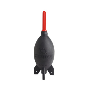

For something small like that, just buy a Giotto's Rocket blower ($6) and remove your lens, and go to town. Blow lots of air on it. 9 times out of 10 that will fix your issue. To prevent it from happening in the future, avoid lens changes in dirty environments and make sure your bag is clean before putting the camera in.
