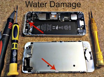

Didn't see any remarks about the tell-tail water indicators that CANCEL any warranty. If you shine a light into the headset port, at the bottom of the port, you should see a "white" indicator. It turns red if any water got into the port. I've also read that there are internal water indicators as well.
IF there is red, "truth in advertising" might be suggested. On any direct sale such as craigslist, an informed buyer will check this out. On any eBay sale, you may get a request for a refund.

Check the Water Damage / Liquid Contact Sensors
