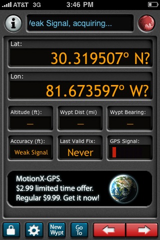

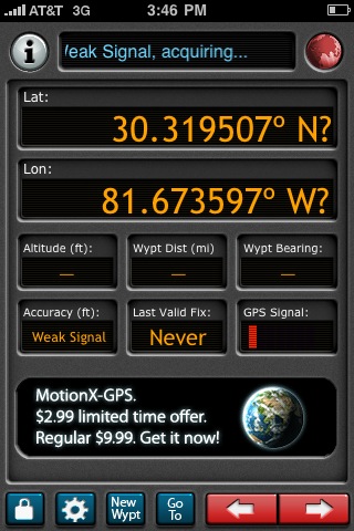

I downloaded MotionXGPS Lite as a test. It shows a little more information about what is actually going on under the hood. What is going on is that the satellites aren't really working, it's the triangulation that's working. The status goes from 'NO GPS SIGNAL' (triangulation only) to 'WEAK GPS SIGNAL' at best. This is when standing outside under a clear blue sky. What a POS!!
I think I may put 2.2.1 back on just for kicks to see if it is any different.
