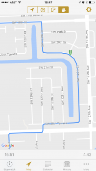

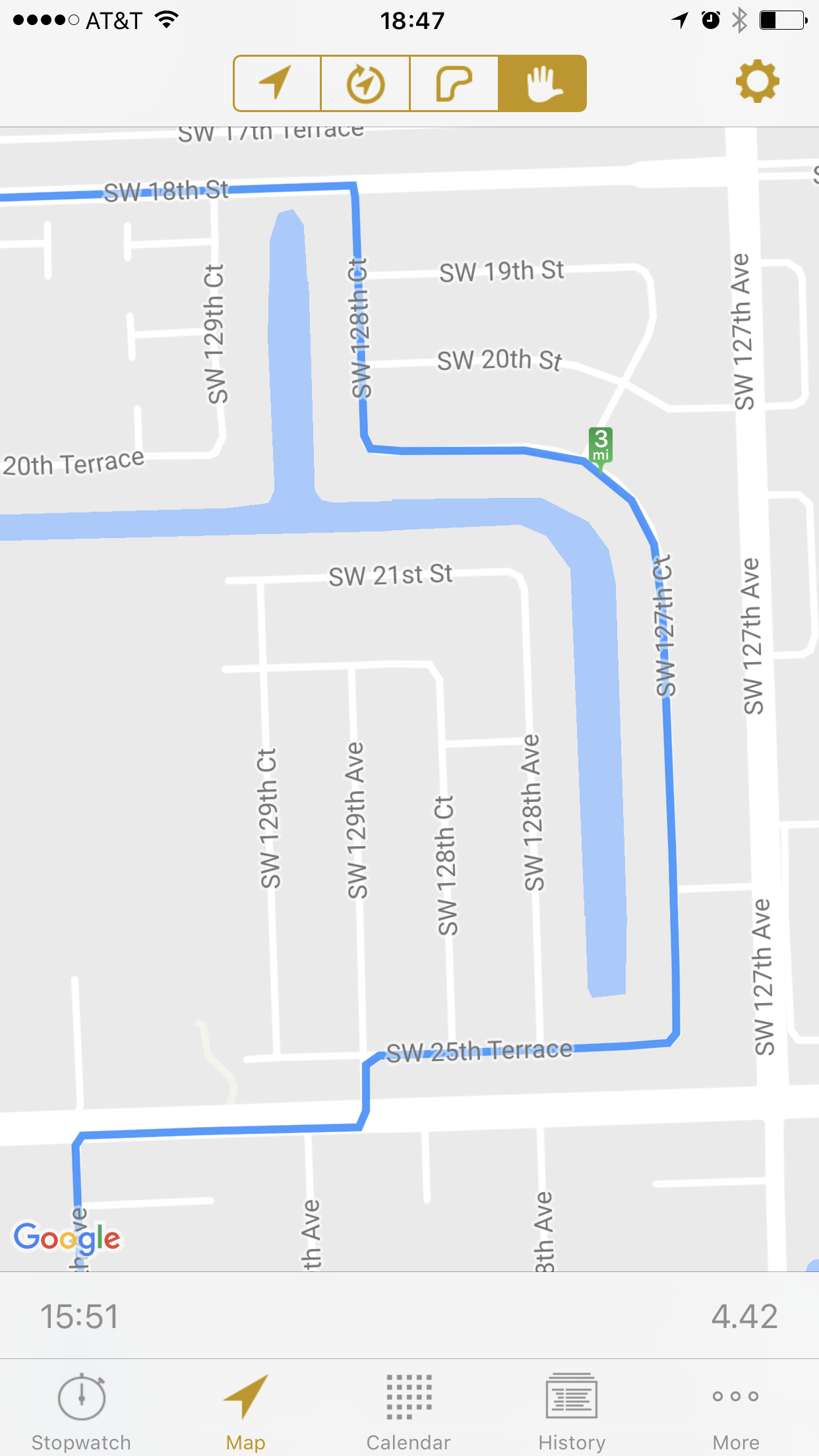

Well, here's a segment from a bike ride using Cyclemeter; my 7+ is spot on.
These problems are either regional, or some defect in a few 7 units.
