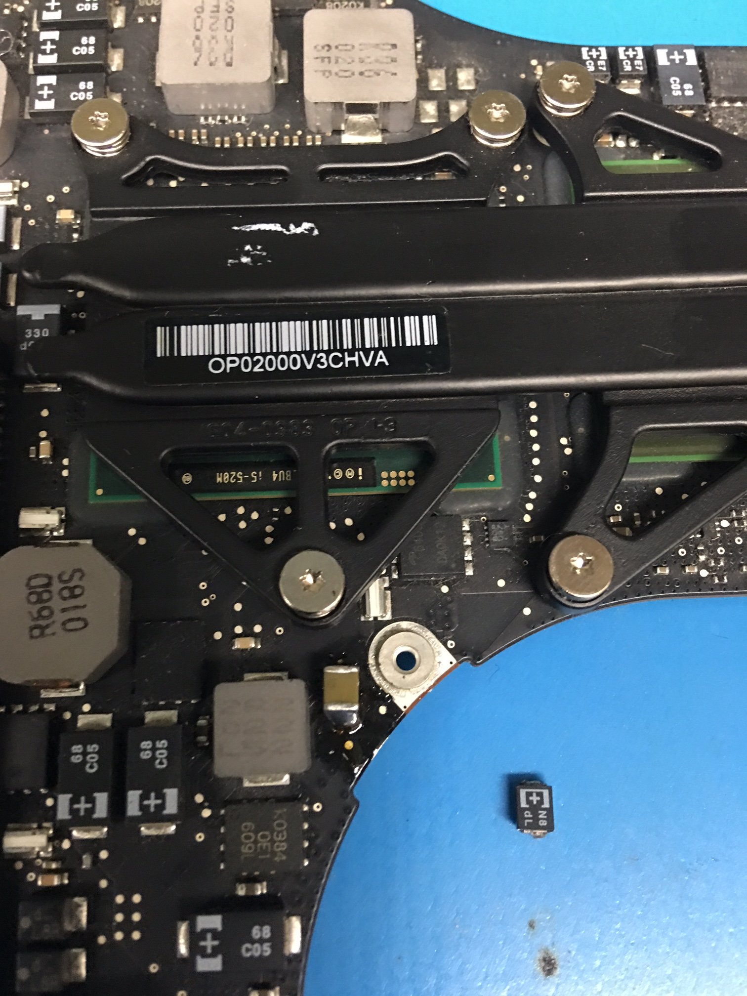

I was originally going to replace the capacitor but i didnt realize until it was too late that the capacitor is on the other side of the logic board, meaning the whole logic board will need removed 😵 so im going to stick with the Kext fix until either i decide to just replace the capacitor, or if the fix ever stops working.

[doublepost=1479961123][/doublepost]Capacitor - $3.27
Installation - $125
Fixing your MBP when the boyz at the jeanyus bar didn't know what they were talking about - priceless
Okay, it's been a week since I had the capacitor replaced, and I've had no kernel panics since. Winnah, winnah, chicken dinnah! I'm running an Apple Cinema Display external monitor, and it's working fine.
Here's the capacitor link,
https://www.digikey.com/product-detail/en/taiyo-yuden/PMK325AC6337MM-T/587-3976-1-ND/4950530.
It's non-tantalum with the small footprint that doesn't require scraping the logic board as referenced in other posts. I had it installed by Lou at DataLogic Computer Services in Orange County, CA. He's at 714-241-1913, in case anyone wants to contact him. Below is a pic of the board with the new capacitor in place and the old one removed.
Thanks again!

As an electrician for audio equipment, I always come across faulty tantalum caps - which is why Louise's explanation doesn't really surprise me !The tant. rating is only 2v, too close to the 1.8v rail it's positioned at... no wonder.
So big big thanks to Louis Rossmann for his great help and of course the constant support to the Macbook community !! and of course to japasetelagoas for bringing this in !! I think this thread should be really public somewhere, or at least summarized as a page so people who look for a solution can find it easily.
However, what I do not understand, is how it's possible that you guys are replacing the polarized cap with a non polarized one (and it still works). I would usually replace a tant. for tant. or a tant. for an electrolyte, but never a polarized cap for a non-polarized one... what am I missing ?
I have just ordered two tantalums in different physical sizes, 330uf 2v and 330uf 4v, and also the same type of electrolytic 330uf/2v cap mentioned here earlier (taken from a dead board). I ordered a few types so I have a few options while at it - based on which one can fit easier...
I'm leaning towards replacing the faulty tant. with a fresh tant., or at max. for a polarized electrolytic. Would that be correct ? I think I'm going to use the 4v rated once, so it takes longer for it to fail (if at all).
I was also wondering - will the SIP be set On again, if I switch out the existing hard drive for a new one (or place a new OS image on it) ? I mean - is the setting kept in the firmware or is it software based (and as such, loaded each time as the OS restarts) ?
Because this especific circuit design do not requires the tantalum usage specifically.
The coil L9560 output from PP1V8 framebuffer regulator has another one smd ceramic non palarized cap connected in parallel. The original design using this tantalum was underestimated. Proof of that, is the fail ever and ever in this specific cap. It's working at the limit to your requirement usage, obviously.
Otherthing, the Snow Leopard OS X did not require much power graphic, but the next (Lion and new ones..) they started to require more and more graphic power, so, more stress to this cap specifically.
So it, the panics started to occur more frequently (material degradation).
But, this is a specific case, and, therefore, tantalum and aluminium are not interchangeable in a circuit (good design), so your comment about ceramics replacing tantalum is correct.
To replacement c9560, I like this one, works great:
Aluminum Polymer Capacitor (polarized):
https://industrial.panasonic.com/ww/products/capacitors/polymer-capacitors/sp-cap/sx/EEFSX0E331ER

well, to soldering you have two other ways
like this:
https://www.dropbox.com/s/zk9m5j41gkstf1e/no scrapping.png?dl=0
adapting one wire (negative polarity)
or using one other model, like the LT Series. This model has two negative points.
https://industrial.panasonic.com/cdbs/www-data/pdf/ABE0000/ABE0000C57.pdf

Hi all,
I have just replaced the c9560 capacitor for a polarized electrolytic one (330 µF).
Sadly, this does NOT solve the problem.
Any idea ?
Thank you !
EDIT : I just watched the first video in post#230 : do I need to replace the C7771 too ?
Or is this for a Mid 2009 17" model only ?
Mine is a Macbook Pro 6,2 15" Mid 2010 with nvidia gt330m GPU.

Hi all,
Any idea ?
Thank you !
No. Only c9560.
What is the capacitor model?
The problem is not if it is a polarized or not.
Check if the soldering point is good, if it's clean all the contacts points (specially c9560, Q9560, L9560, R5413), and the polarity is correct.
I am considering that the capacitor is working perfectly.

Not very aesthetic but should work : http://hpics.li/c276702
I had no problem removing the old tantalum capacitor and fitting the new one.
I might open the Macbook again and check the soldering, that looked fine in my opinion, though.

Wrong capacitor. This model will not work properly (many reasons).
This model is slow, resistive and so on.
You need a new one SMD ceramic type.
Replace this cap to the old tantalum cap. Try the kext fix (read my old posts to check if the kext is loaded correctly). If work successfully, the new smd ceramic cap will work. 😉
Cheers!
