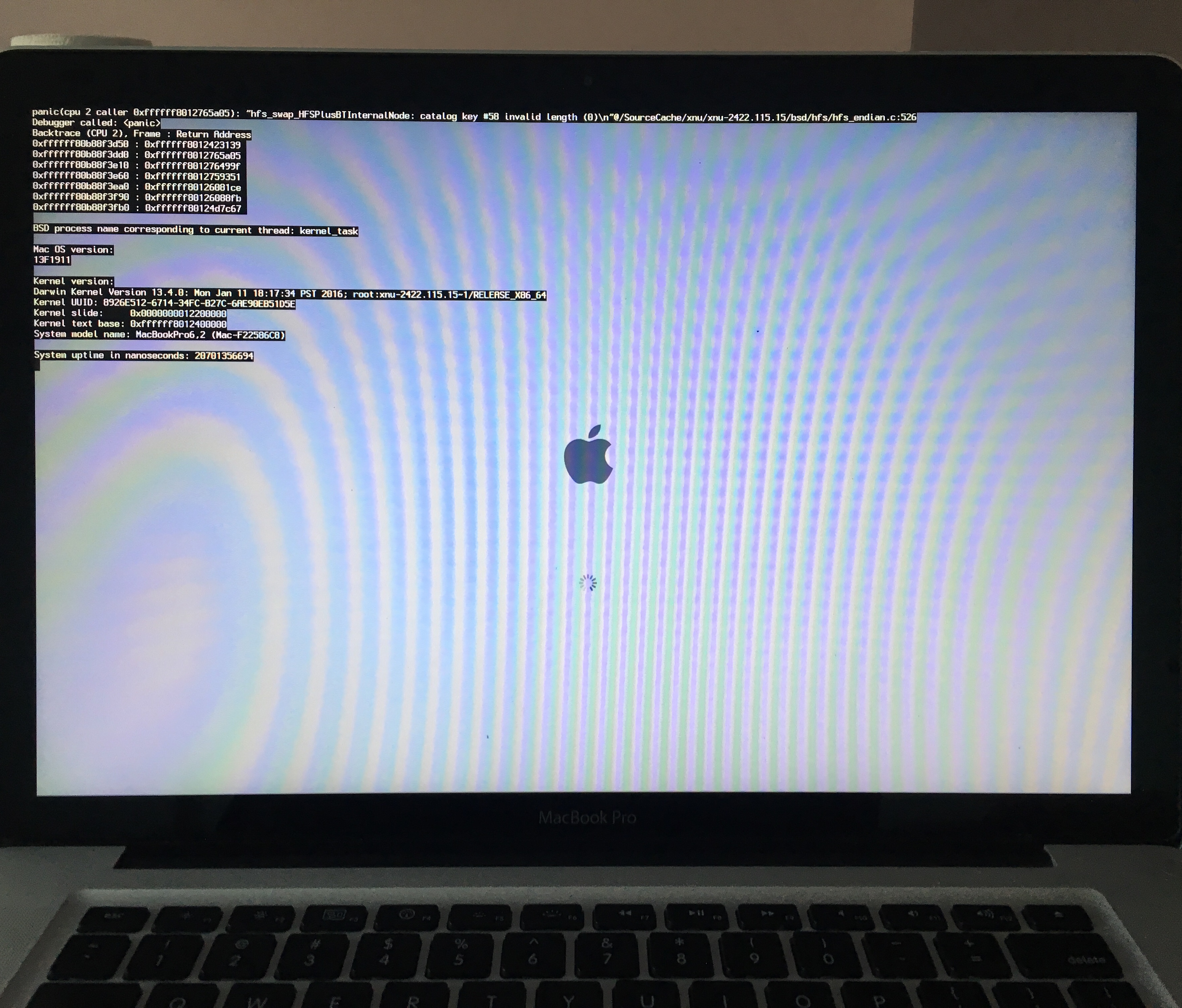

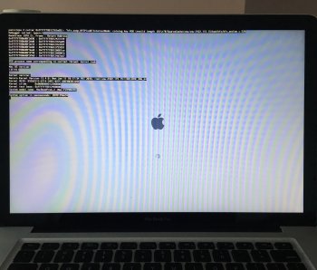

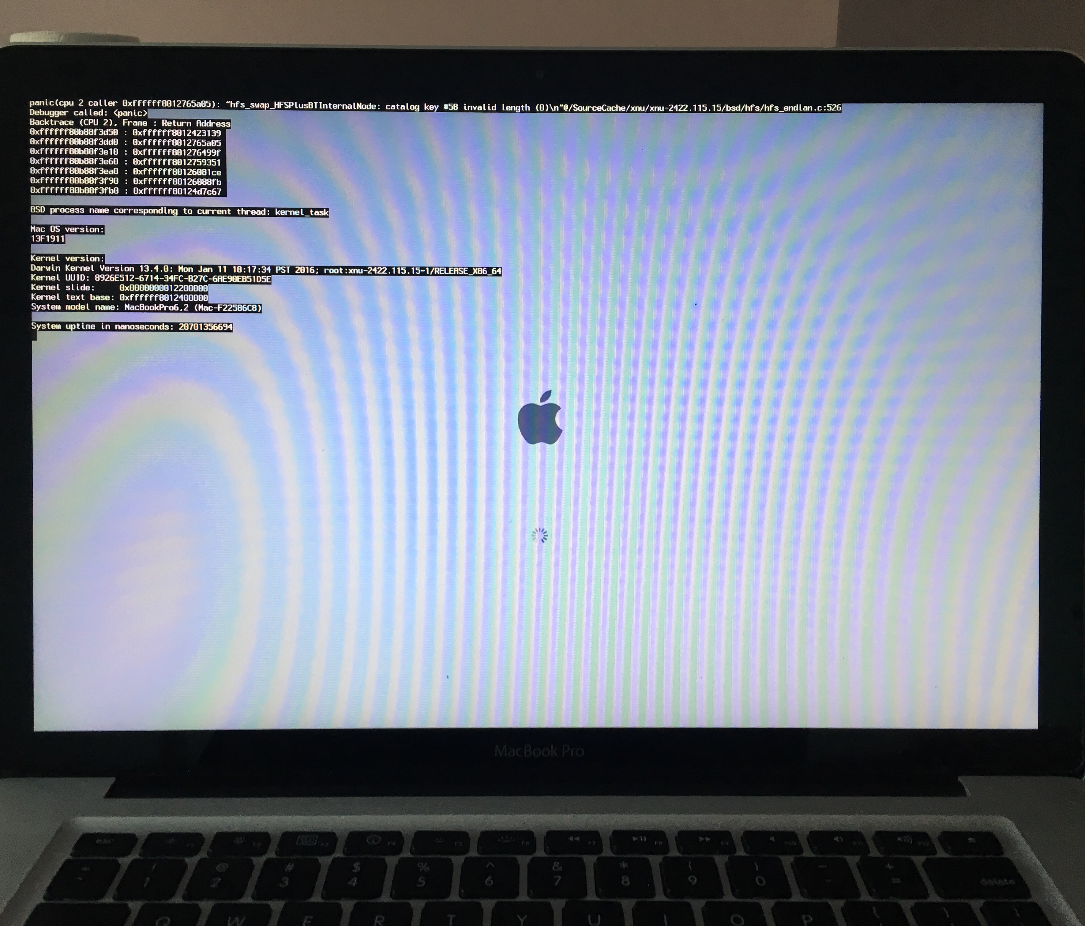

I got a 2010 i7 that was running fine on HDD with Lion in it but when I swapped the HDD with a SSD and did a fresh Mavericks install it kernel panicked.
Thought the capacitor gave up - saw on Louis' videos a long time ago - and replaced it but it would still the same. Got to a stage I swapped with a capacitor from a known working board and surprise the other board was happy with the swap and this one is still panicking - won't even load Sierra, it died mid-way and Mavericks does install but crashes (picture below).
Also tried to put the HDD back but it wouldn't even boot anymore…
So if it ain't the capacitor and I can't even run OSX what could be the issue here…?

Same problem with my bootcamp windows 10 partition, screen went blank even before login and couldn't enter safe mode, so had to re-install from USB stick, and de-activate Nvida in the device manager and re-built system from there manually, as soon as I would install the correct Nvidea driver, screen would go blank again. (enter safe mode, de-activate Nvidea, rinse, repeat...)
Hi Daniel,
I was hoping that the settings I changed in the nvram would stick once booted into Windows 10, too bad this does not work. What were exactly your steps to prevent the blank screen in Windows? I only can get into safe mode, anything else will give me a blank screen.
I would love to try replacing the bad capacitor, but I don't feel confident enough to not brake it definitely.
Thanks!
