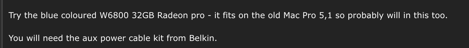

Try the blue coloured W6800 32GB Radeon pro - it fits on the old Mac Pro 5,1 so probably will in this too.
You will need the aux power cable kit from Belkin.
yeah, except that AMD specifically calls it out as not being "supported"' for Mac Pros. Hence I'd be curious if there's any "issues" with it - ie like it having more display outs than the Apple version.

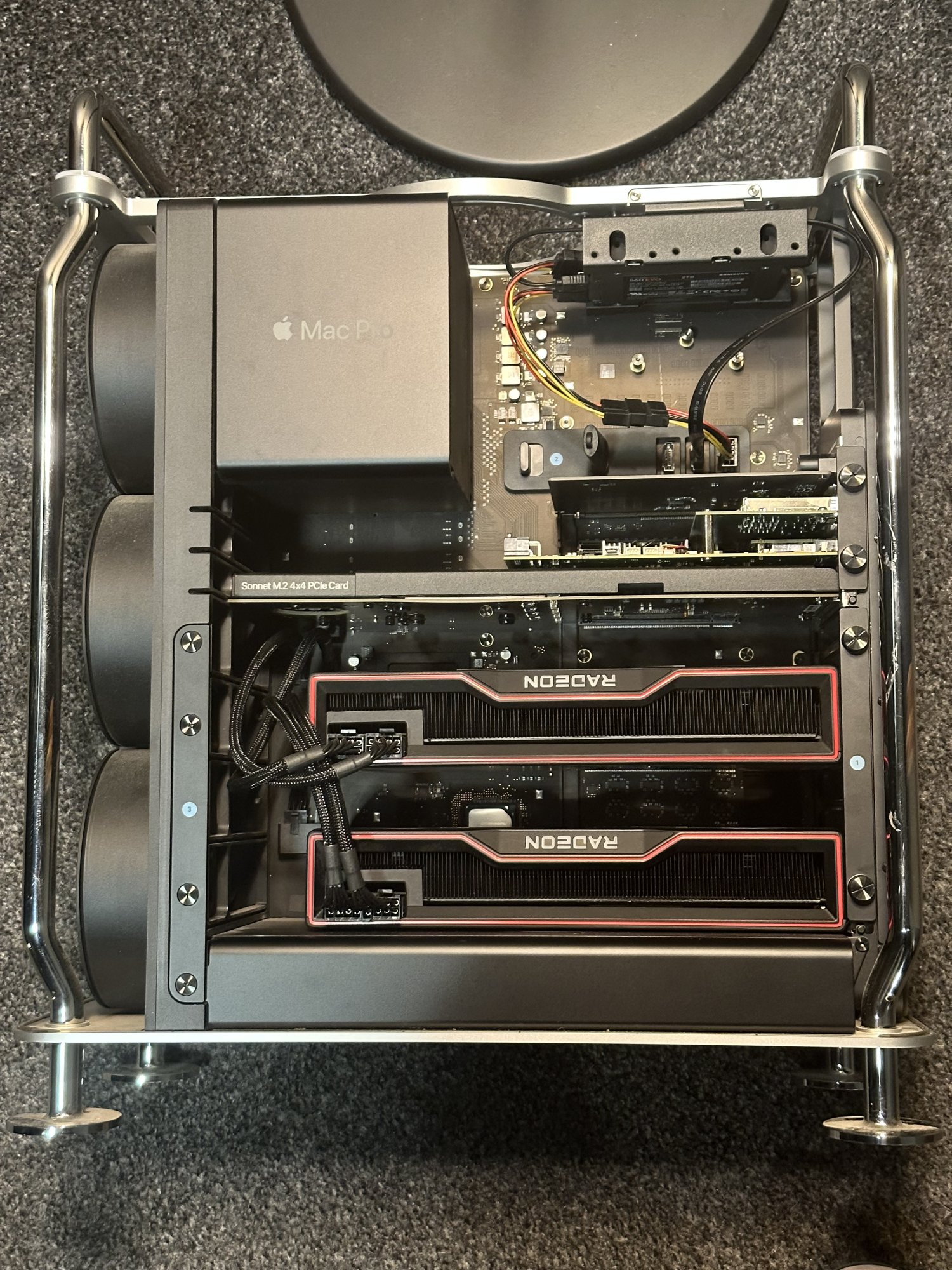

6900XT działa bez żadnych problemów.
Even two work great.
I assume you have multiple monitors? My 2nd GPU sits idle 99% of the time because I only have a single monitor for the 7,1. I tried changing settings in Topaz Video AI to allow for dual GPU but that caused my secondary GPU to run without fans for some reason? The 6900's reach temps over 230F = 110C which can't be good for other internal components. I bought this recently with dual RX 6900 XT's already installed.

I use only two monitors. DaVinci Resolve utilizes both GPUs very effectively. The 6900XT can indeed get quite hot, but the Mac’s fans handle it exceptionally well. My machine has been running under heavy load since April 2020 and is rarely turned off, yet I’ve never experienced any thermal issues.
Of course, the power supply is also under significant strain—at full load, it can draw over 1000W. However, in my opinion, the Mac Pro 7.1 is an exceptionally well-designed machine, capable of handling such loads for hours, weeks, and years. It’s an outstanding workstation.

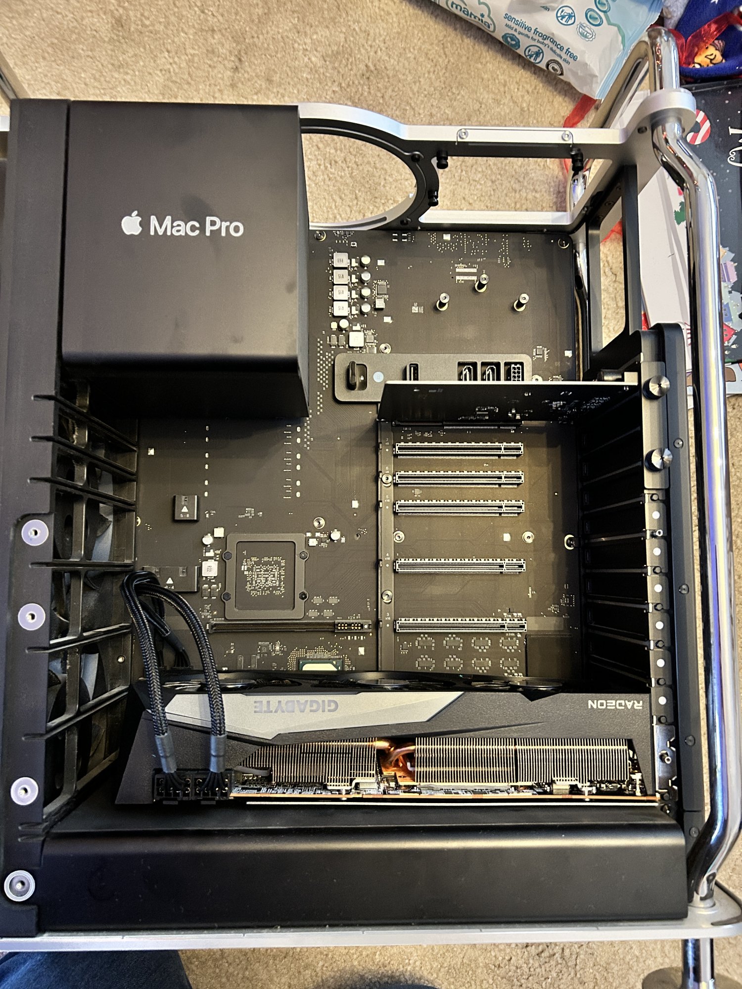

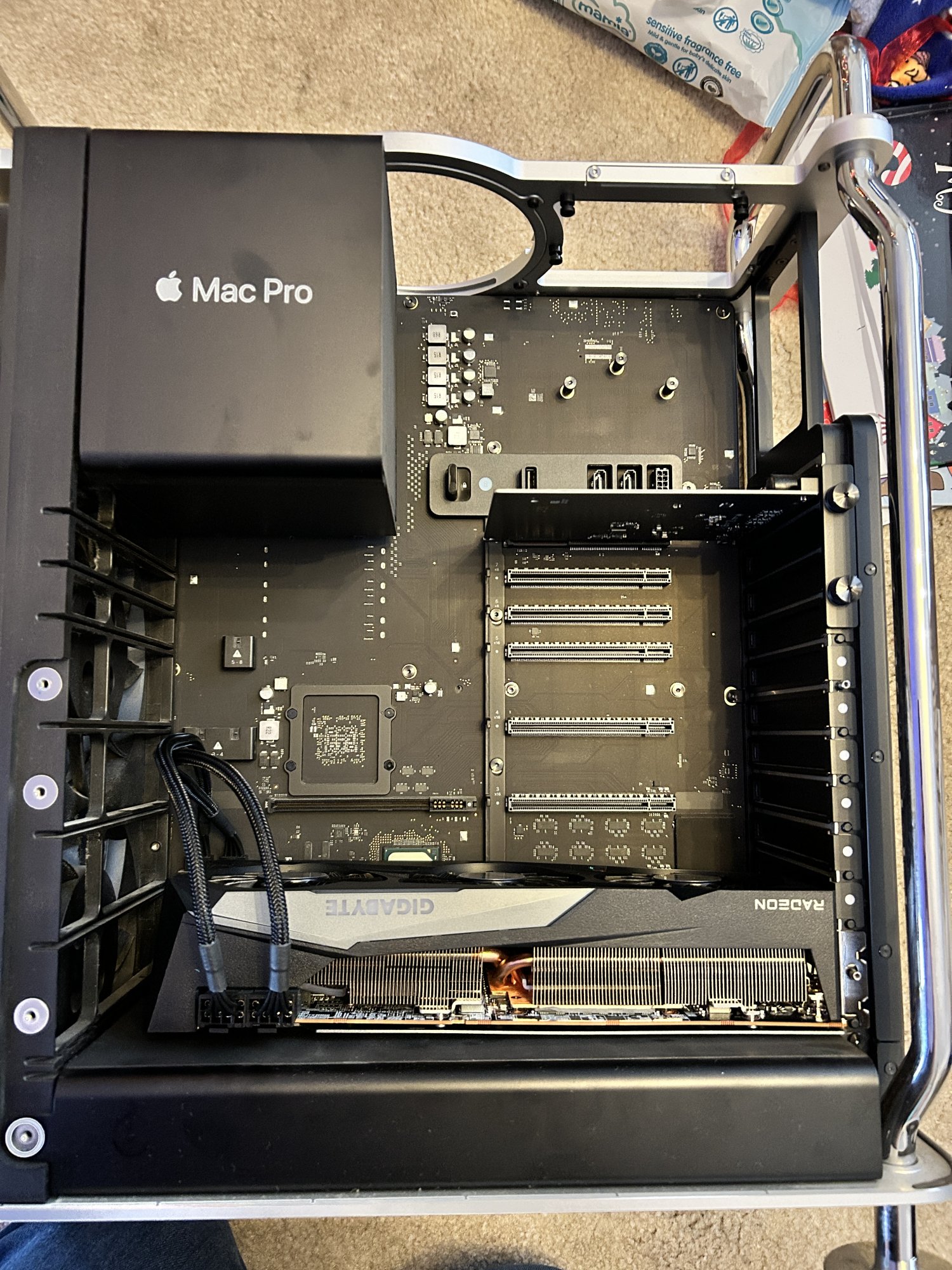

Gigabyte RX 6800 XT arrived today and works wonderfully in both windows 11 and Sequoia. Needed to uninstall the radon pro drivers and replace with adrenaline on windows.
Thank you for the help on this thread and the other. This community rules.
