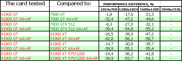

Or, if you wish to see the results directly between 7800GTX512 and X1900GT in WIndows, look here:
http://ixbtlabs.com/articles2/video/r580-5.html
(warning...kinda bloody, the 7800GTX512 wins by as much as 50% at high res and AA)
The image here is pretty self explanatory, from the linked article.
With far greater bandwidth and RAM, the 7800GTX512 leaves an X1900GT for dead.

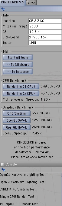

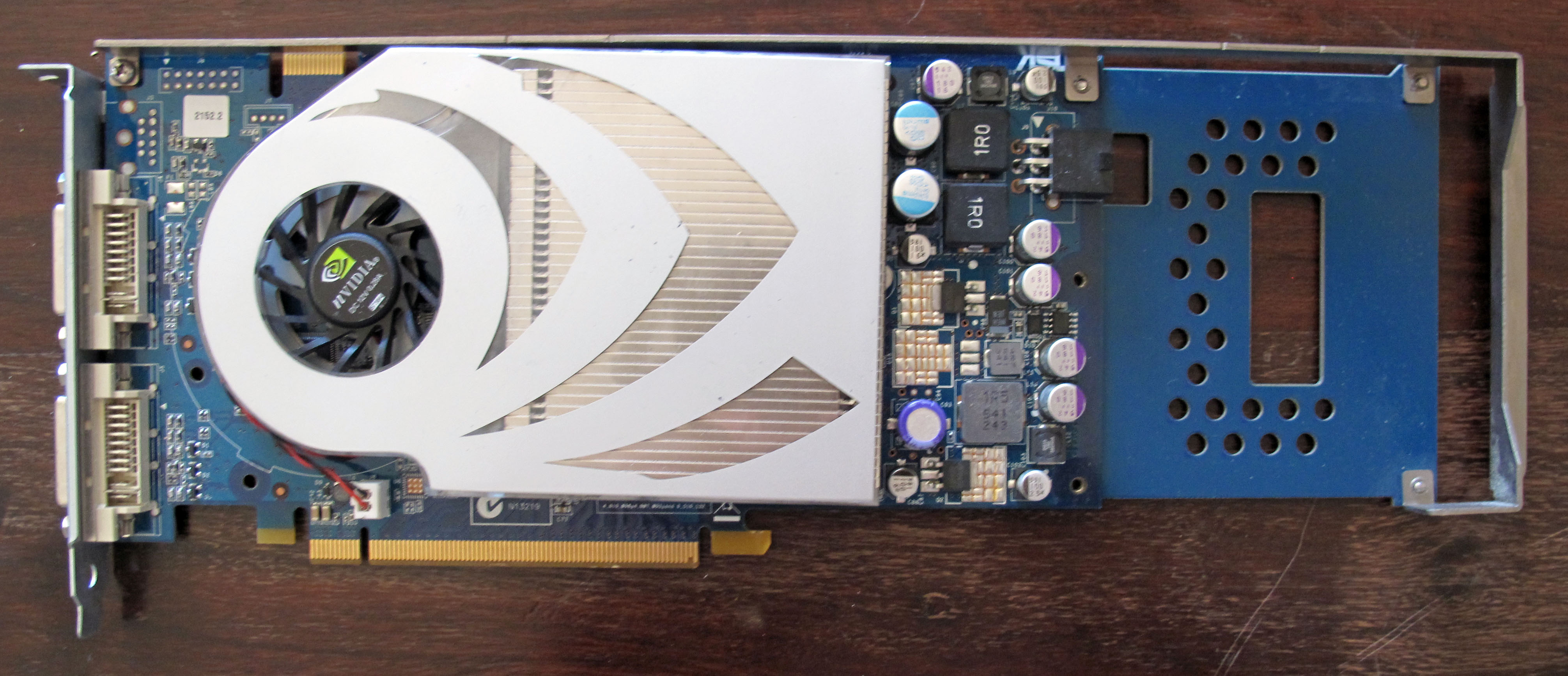

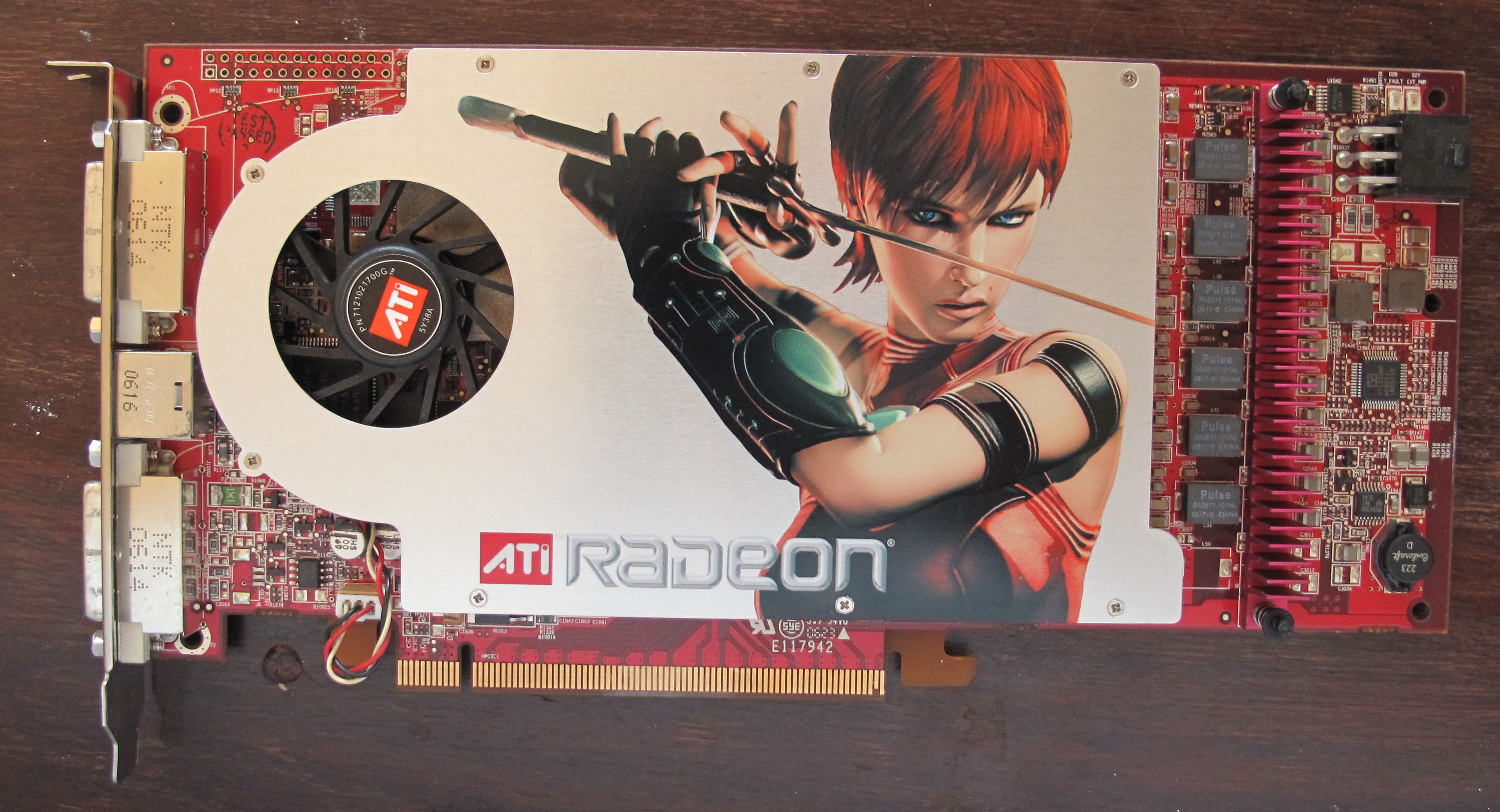

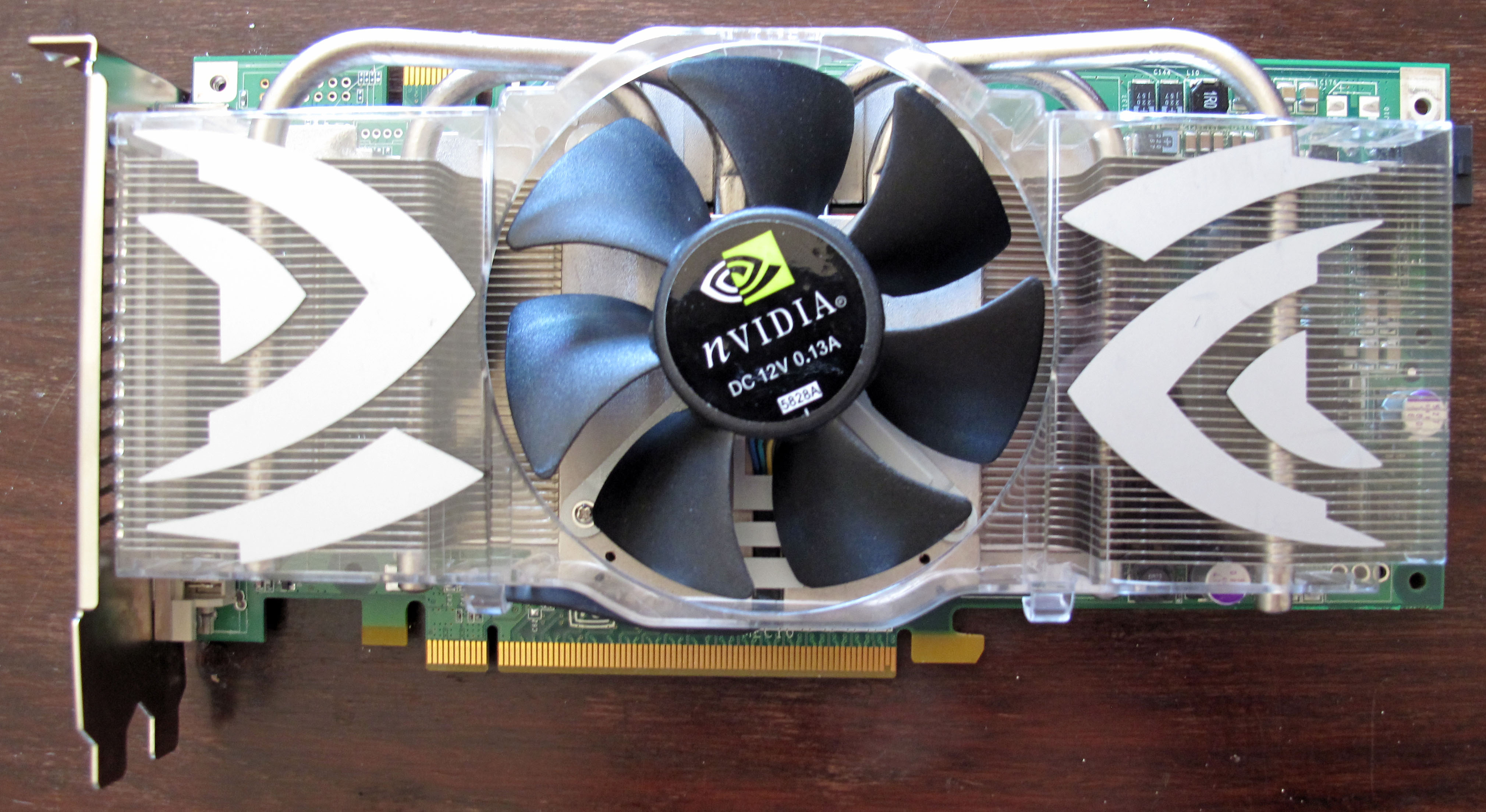

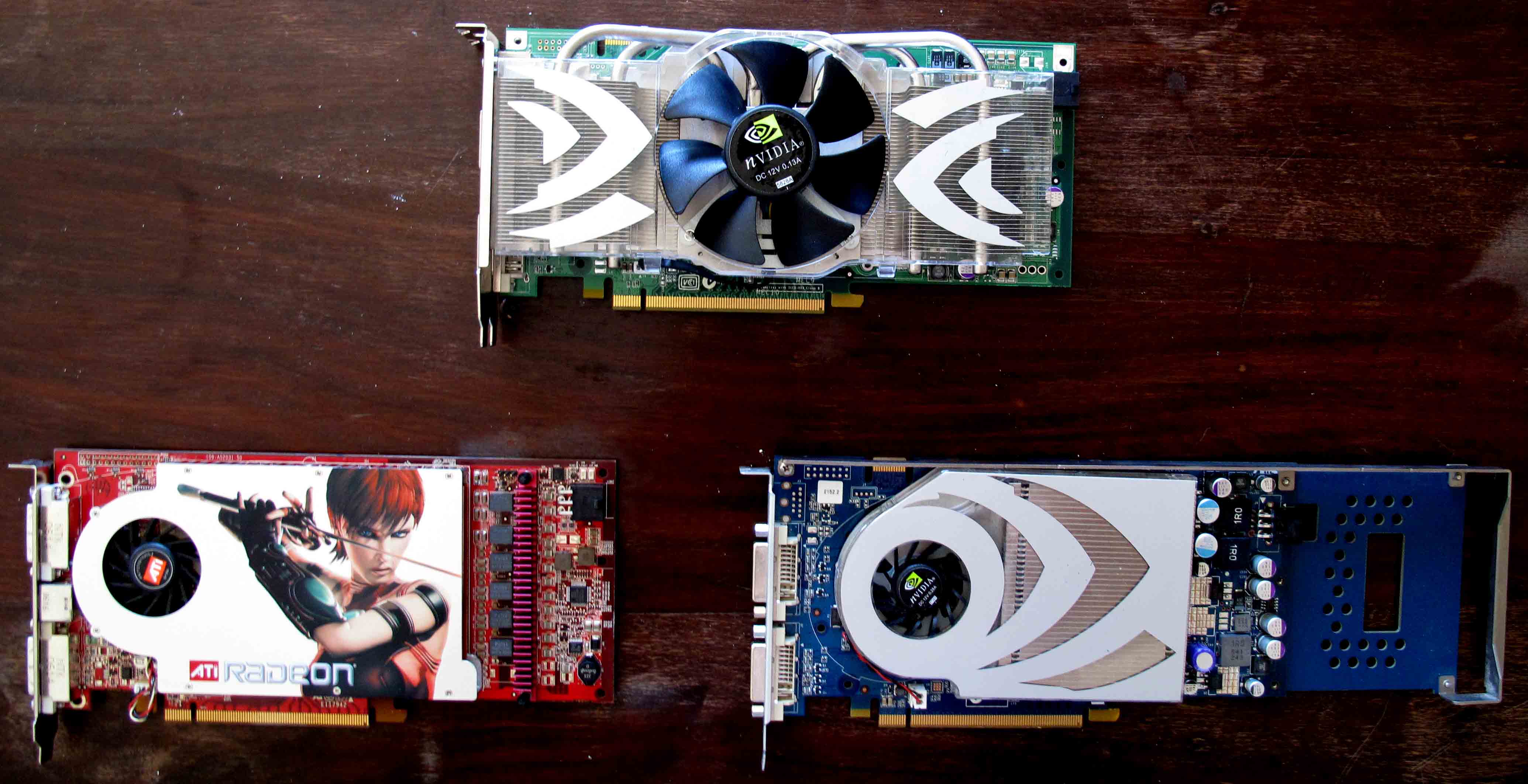

Mac G5 Video Card Showdown
Here they are, the contenders. I decided to include the "other" G5 upgrade, the 7800GT.
The X1900GT and the 7800GT are the official "OEM" versions, not flashed ones.
The 7800GTX512 is a flashed one, since there was no other way to have one.
I got these cards late today so actual testing will begin tomorrow.
