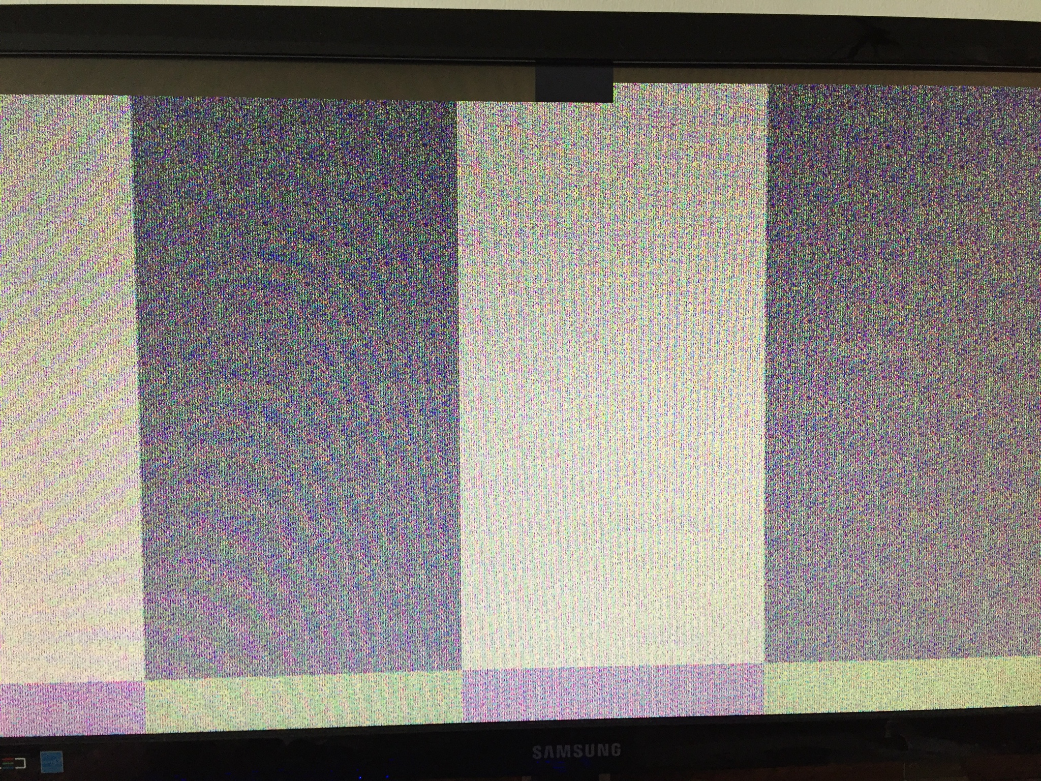

Been trying to get another os besides OS X on my Quad but no matter what I try it doesn't seem to work. I get a massive graphical error after install. Have tried Debian 8.7.1 as well as Fedora Server. Both once installed show the attached image.
Having thought it was my quadro I swapped back in the GeForce 6600 back but same result. Oddly enough the artifacting has some of my leopard install background (and that ssd isn't connected). Any help would be appreciated

[doublepost=1487395763][/doublepost]Hi there - I have Ubuntu Mate installed on my G5 (sorry do not have experience of Fedora or Debian, though Debian should be similar as its the same/similar base core as Ubuntu).
I had a 7800GTX in the machine originally and was having real issues with that so luckily as I still had the original 6600 I popped that in and it all worked pretty much flawlessly.
The fact the artifacting has Leopard bits in it is beyond strange....from your screenshot that is not a Linux background of course but Leopard so it looks like it's booting into Leopard and not the linux install at all (presumably you have a boot menu - what happens if you select Leopard from there - does it boot in OK?)
Assuming it's a boot issue then have a look at the link below I had to do this on mine to get around boot issues after installation (I also assume booting into the linux live CD works ok?) Good luck with your project its fun to get it working (and a real sense of accomplishment) and I believe with you having a Quad (jealous) will be quite a productive environment - there are some great apps - once you are through the linux install pain barrier 😉 https://ubuntu-mate.community/t/sol...tall-flashing-questionmark-g5-powermac/5782/5
Have you zapped PRAM and unplugged power and held the power button in? That desktop image must be stored in memory somehow?
I have unplugged the leopard ssd and simply installed the various distros to another ssd. I tried changing back to the 6600 but the same results. Even tried the reset button on the board. I will try again and unplug and zap pram but this is the strangest behaviour.
AFAIK From stock Debian does not have the correct Drivers for Nvidia PPC cards I recommend using some up to date distro of ubuntu 16.x as they have the correct drivers and work well with nvidia PPC cards

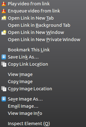

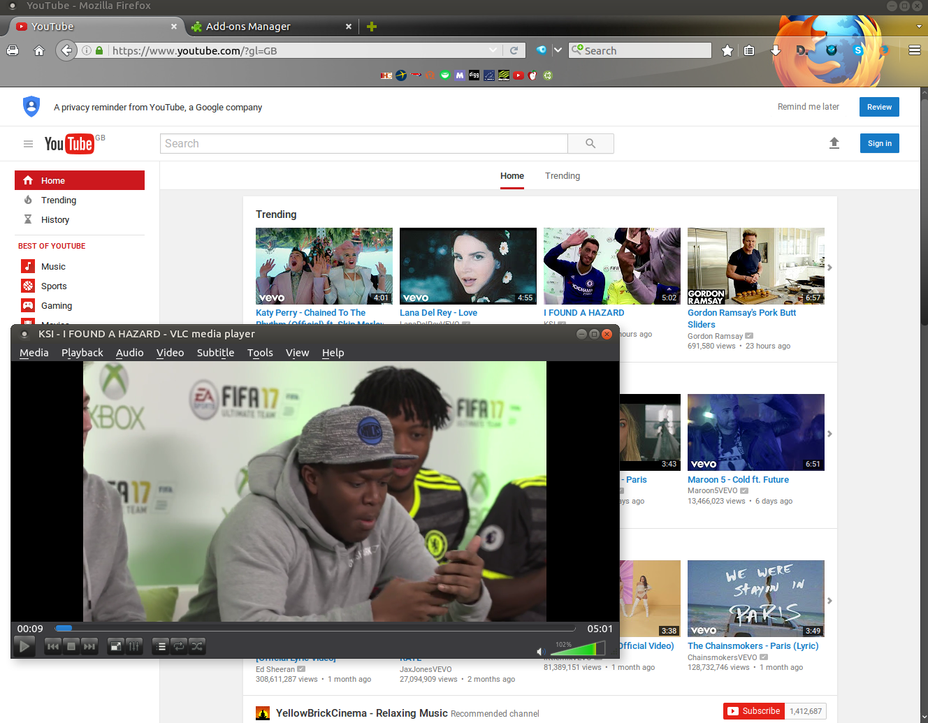

Here you go - hope this works for you - actually I have not installed the VLC-Browser-PLugin from Synaptic I just added the following extension into Firefox (Don't know why the first image loaded twice...) :-
Seems to work but playback is set to a full window

Also some videos don't play and I get an error in vlc
_____
You can solve the full window by going through VLC settings.
Re the other problem - apologies - I don't use the PM much (it's not my main machine, more of a hobby) I tried several Youtube videos and yes, I also found some that gave an error... I think it may be linked to this which affects all O/S apparently when playing YT through VLC - http://tricksnow.com/how-to-watch-youtube-videos-on-vlc-without-any-errors/ and will try tonight (copying the .lua file into the VLC directory).

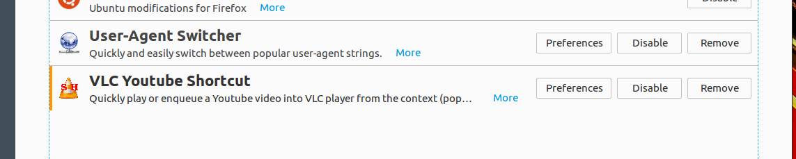

Update - Yep above is correct happens on all o/s with this plugin - fix detailed here - read review "Does what its supposed to" for details of how to fix.
https://addons.mozilla.org/en-US/firefox/addon/vlc-youtube-shortcut/?src=search
