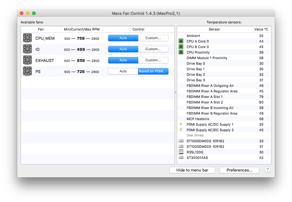

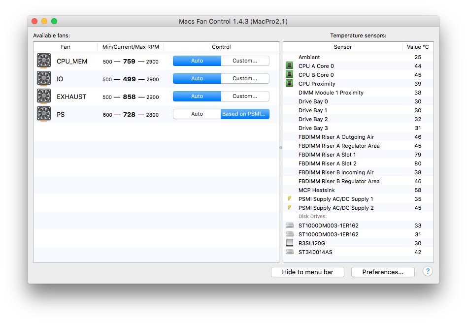

It has 4 fans: CPU/RAM, PCI slot, PSU and Exhaust. So, yes, it can be done and i would do it to, to see if there are some changes afterwards.

Thanks, I see you posted screen shot from Macs Facebook control, would that be a better program totry instead of smc fan control? As it looks like that program changes fan speeds based on what temperatures it finds parts are running at.
You're right, thats the program i use for three reasons:
- you have sensor based fan control so you can assign fan to temperature - i keep PSU under 50C, so fan starts speeding up at 43C and max allowed is 60C;
- you can type exact RPM you wish - iStat Menus has only sliders for fan speeds
- you can download Windows version also (from the same site) to use in your Bootcamp.

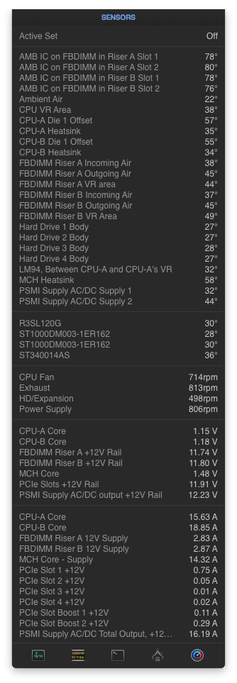

Not a problem at all. The other fans, as you can see, are all set to automatic.
Before i got 8GB (4x2GB) of Samsung RAM i used to adjust CPU Fan and Exhaust (since they are on the same horizontal path) to keep my Northbridge under 70C, but since the RAM i bought has temperature sensors in it, Apple's SMC i keeping those fans up by 150-200 RPM all the time so it just cools itself now. I also disassembled my Mac and blew the dust with compressed air, so the temp of the Northbridge went down by 20C by itself before i even got the ram.
IO or PCI/HD/Expansion fan i never touched. I have only GPU there, it first was Gigabyte 7950 Windforce and now it is MSI 7950, so they cool themselves enough, no need for help at the moment.

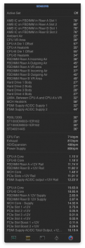

I am attaching screenshot from iStat Menus so you can see those 4 RAM sticks that have temp sensors and are not giving those two fans (CPU and Exhaust) to stay at stock RPM (500 and 600 RPM).
