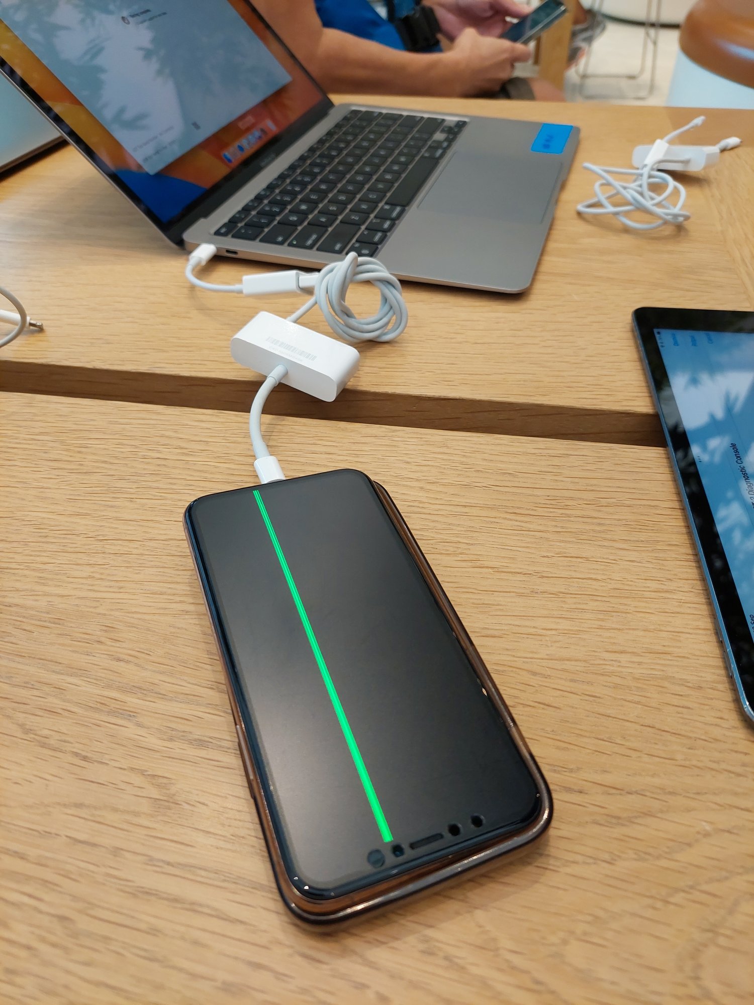

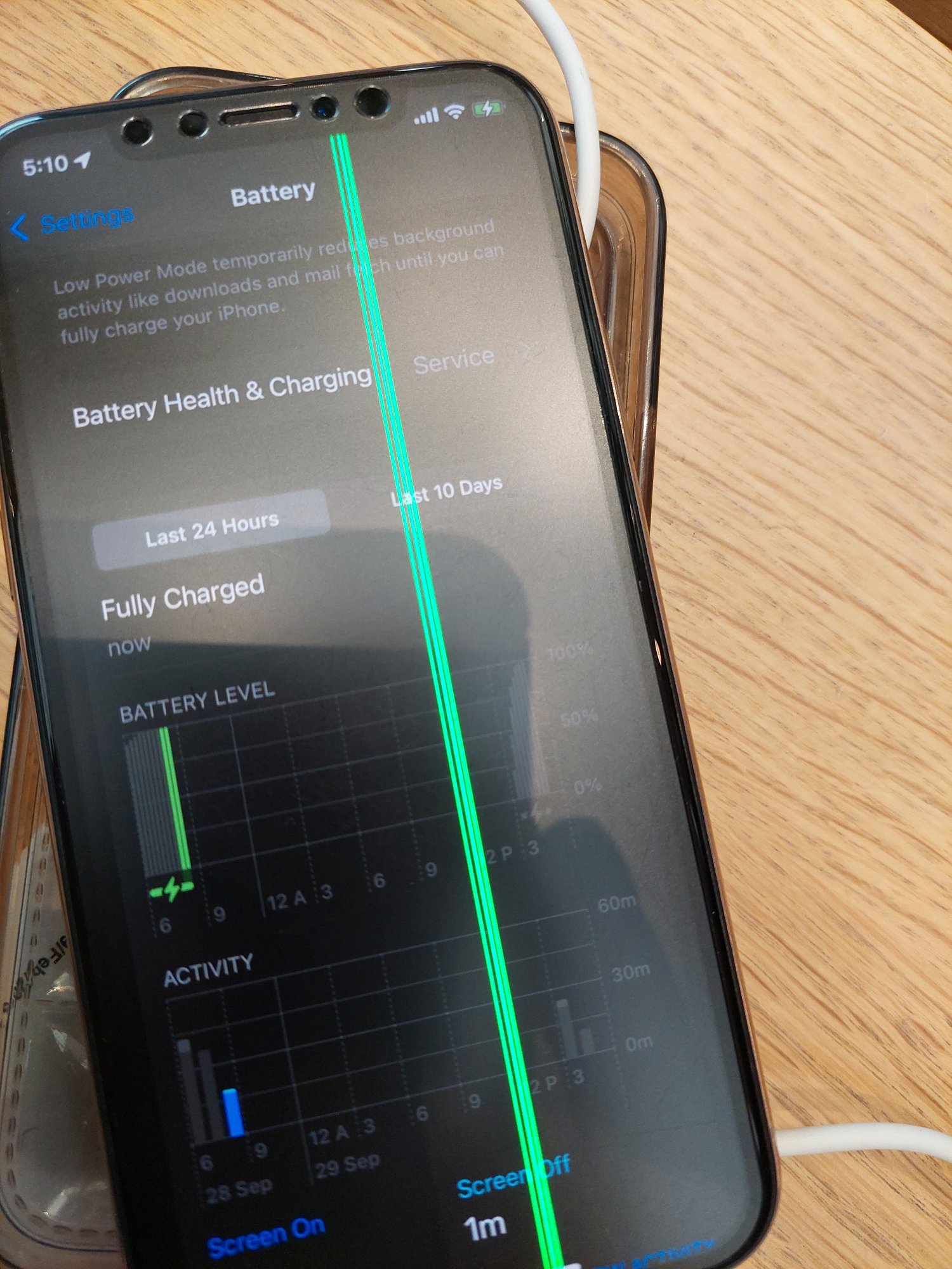

Dear OP, I also got a green vertical line on my 11 pro 64gb. It happened sometime around September, I did not drop my phone nor nada, pristine condition since day 1 with case, tempered glass and care.
I was using using my phone as per usual, pressed power button to sleep and place it away, and then to my SURPRISE, when I press the power button to wake it, a sudden green line spawned.
Went to apple store and the lead genius told me there's nothing they can do, other than quoting me $400 plus for the lcd replacement. I am really surprised by Apple's poor customer service, plus upon learning that my iphone is an old model, the genius probably gave zero f*cks about my case.
I would gladly share further details if anyone is interested . Here are some of the poctures. Anyway it went from 1 thin line to 4 lines , multiple thick lines, and eventually back to 1 line. It was still functional but freezes occasionally , restarts a d shows the apple logo , and then back to main screen again

Wow $400 for a screen replacement on an 11P seems high, since right now an Apple refurb 12P is $589
It is high assuming that's USD, a screen replacement on an 11 Pro is $279 and $329 on a Pro Max, so I suspect OP maybe embellishing or their phone needs more than a screen.
EDIT: I see their phone is also flagging that the battery needs service.

The picture you posted of your iphone 11 pro with the green vertical line, that is how my line looks as well except it is a bit to the right. The green vertical line you have is in the middle/right. So if the line was farther left or right, it wouldn't annoy as much right?
How long have you had the iphone 11 before the green vertical line showed up? How long have you been using it with the vertical line?
For me, it was a thin green vertical line. Then it was a large green vertical line. Then it was a very light green vertical line. Then it went away. Then it came back a very light green vertical line. Then a thin green vertical line. Then it went away. Then it came back with a large green vertical line.
