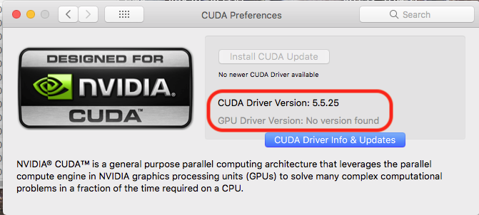

This looks very wrong to me.

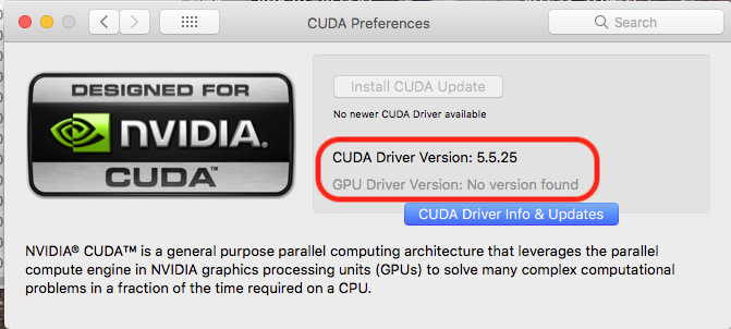

I suspect you are using a very old OS.
The Pascal card is only supported in 10.12.4 or later

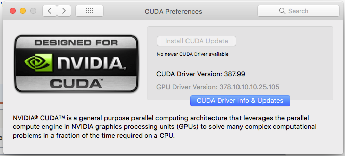

The correct one should show you the GPU driver version. The the CUDA driver should be much newer as well.

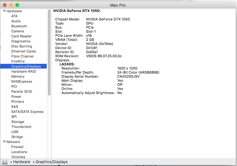

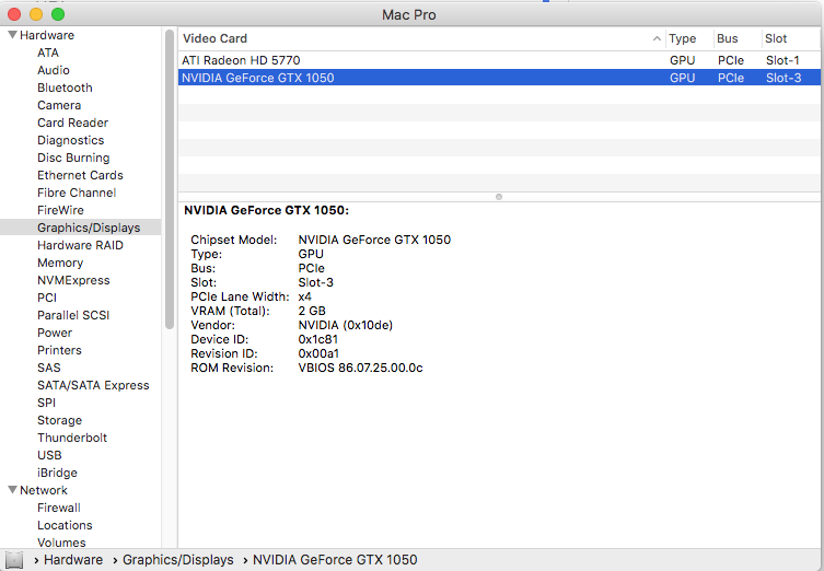

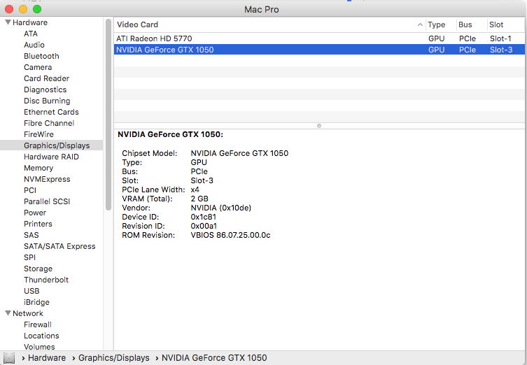

In System Information, is the card detected properly and does it use 16 PCIe lanes?

Here is my system

How do I update the CUDA driver ?

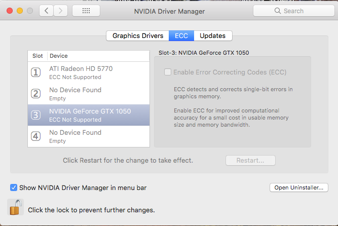

You're running your GPU in the slower port. Your Radeon HD 5770 is in your fast PCIe slot. Your Nvidia card only has 4 lanes to work with, and the Radeon has 16.
You should go to Nvidia's website and download their latest drivers and install them again. Whilst your CUDA driver is also outdated, it's not the biggest issue. It's your display driver that matters the most in terms of, well, the visuals. CUDA is for GPGPU, and whilst you certainly also want that updated, it's not the pressing issue

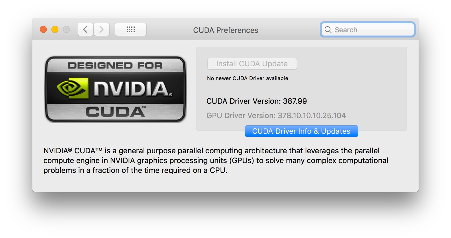

Ok little update now .. I have updated the CUDA & its still the same ..

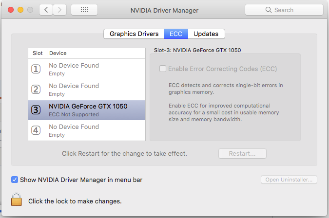

I have unplugged the ati card as well ..

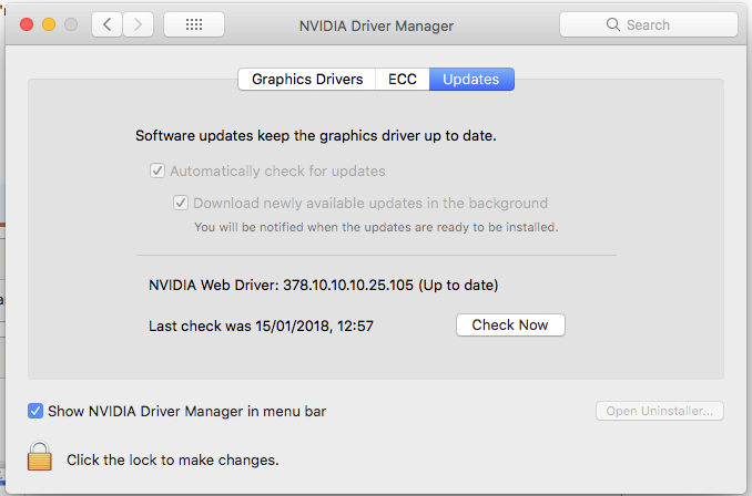

Yes upto date but still not working 🙁
It may be you pick a wrong card that not compatible with the MacOS web driver.

Even though I don't think x4 lane will make a card unaccelerated. Did you try to put the card back in slot 1?
why do you need the 5770 connected in slot #1? remove and put the NVIDIA in slot #1 to see if that fixes. make sure monitor connected to NVIDIA card and/or remove the 5770 from the system.

Of course, the driver match your MacOS version now. However, the MacOS version itself seems "wrong" (this is an iMac Pro specific build, not sure if will cause any issue on other Mac).

You're in a weird position with the 3,1 hacked update to emulate a 5,1. That MIGHT be what is causing your build number to be 17C2120 vs 10.13.2 (17C205).

Figure out how to get your build to reflect 10.13.2 (17C205) vs what you have currently. Not sure what hack you're applying, but the problem likely stems from there. Your build number is likely incompatible with the NVIDIA web drivers. MacPro5,1 and MacBookPro11,3 (with an NVIDIA GeForce GT 750M) both show build number 10.13.2 (17C205).
I believe 17C2120 is a custom OS build for iMac.

[doublepost=1516035605][/doublepost]ok my system have just done a update .. & now my system shows as this ..
macOS 10.13.2 (17C2205)
17C2120 is not compatible with NVIDIA web drivers. The NVIDIA web drivers are tied to specific macOS builds. Fix that if you want to use the NVIDIA 1050 card. Your 3,1 > 5,1 hack is what is causing this. If the 5770 is working, stick with it and remove the 1050. (You're lucky that setup is working without issues given the hack.)
Figure out another method to get around it. Downgrading to 10.13 or 10.13.1 MAY help fix the issue, then you could use an older (likely compatible) web driver version. macOS 10.13.2 is extremely segmented with all of the patches at the moment. Booting your system like it's an iMac is doing nothing to help.
Your NVIDIA 1050 (unless flashed) does not have an EFI and will not have boot screens. You would need to follow all of the directions/suggestions for that setup, which are throughout this forum. Search for them and read the sticky.
