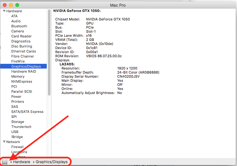

It looks a bit strange to me there is no computer's name at here. May be something is wrong at the OS level
This may be related to the iMac specific OS running on this hacked/upgraded 3,1.
