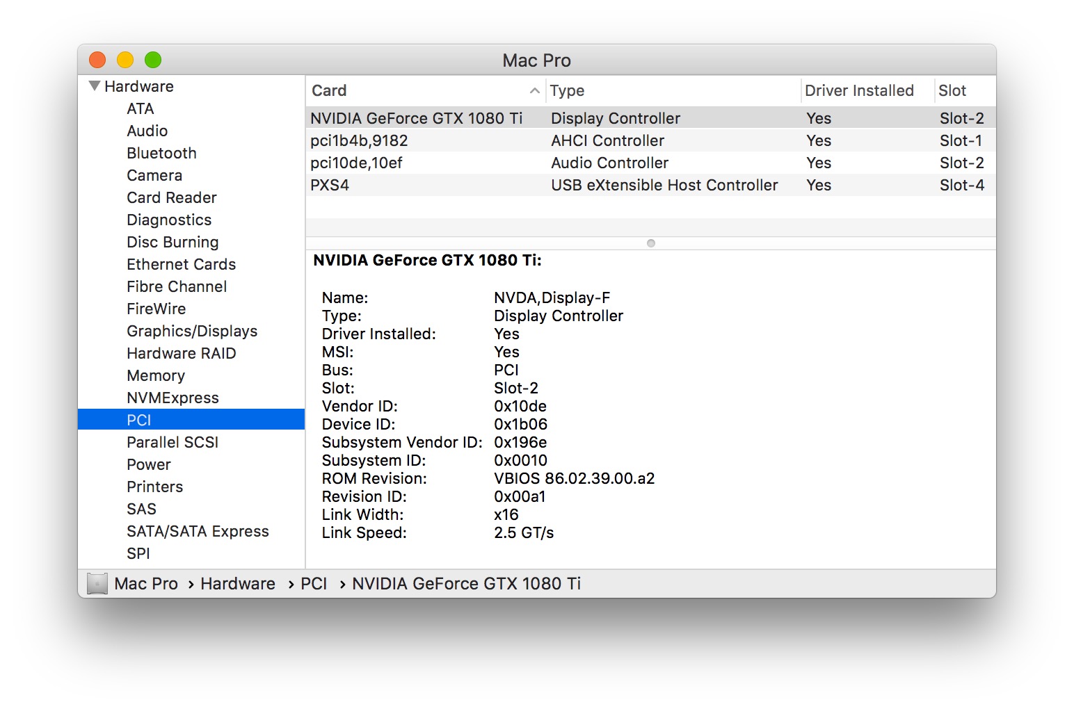

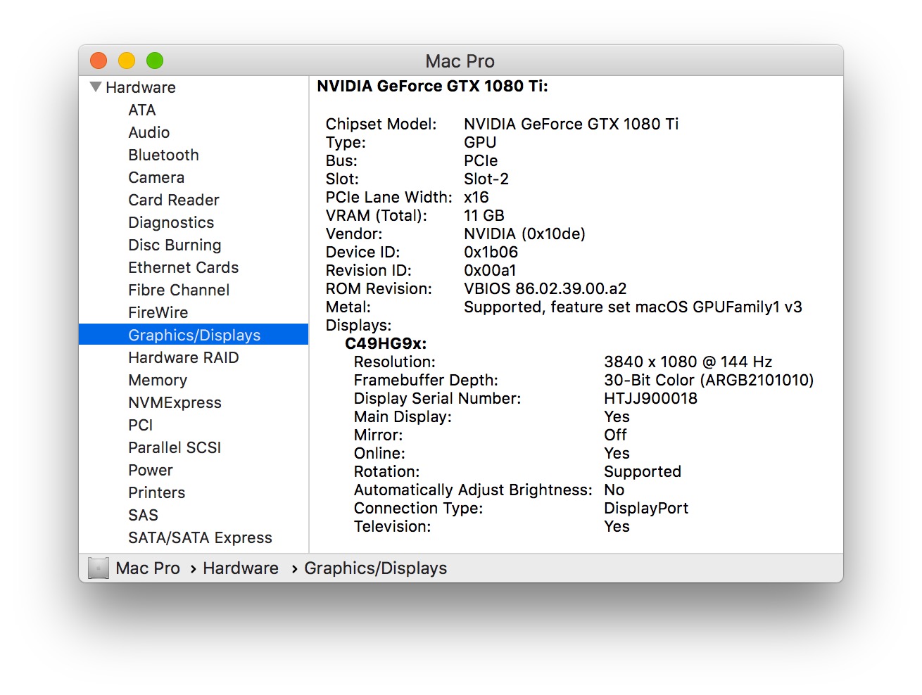

Did you check if your card is properly recognised under MacOS (when the monitor still connected to GT120), something like this.

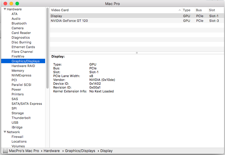

Your driver is NOT installed completely/properly. Based on your picture here...
It shouldn't say "Display" for your GTX 950. Also say's "No Kext Loaded".
You can most likely resolve your issue by doing the following:
Check to see if SIP is enabled or disabled.
Open a terminal window and enter the following "csrutil status" without quotes.
I'd be willing to bet it says disabled. If so enable SIP by doing the following....
Boot to Recovery OS by restarting your machine and holding down the Command and R keys at startup.
Launch Terminal from the Utilities menu.
Enter the following command:
csrutil enable
Re-boot....
Re-install the web driver. The correct driver is 378.10.10.10.25.104. During the install you will have to allow a Gatekeeper exception by going to System Preferences -> Security & Privacy and clicking on "Open Anyway".

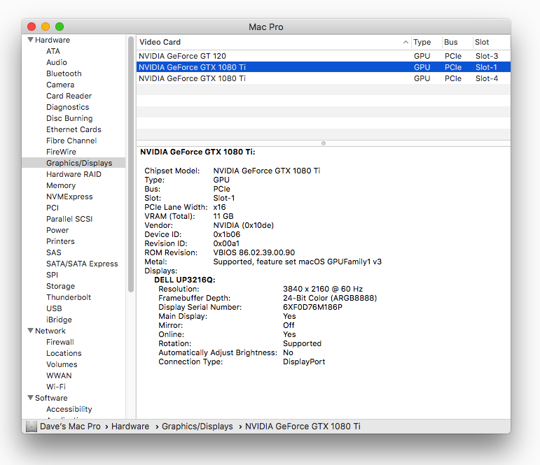

When the driver is properly installed it will identify your card properly like this. It will NOT say "Display".
If you plan to use BootChamp for bouncing between Windows and macOS you will now have to disable SIP by...
csrutil disable
Re-boot....
