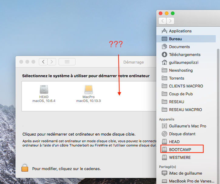

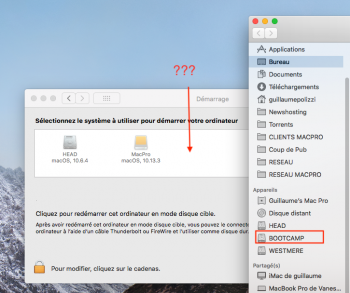

in fact to be more precise : i cannot see, well high sierra, cannot "see" the bootcamp partition in the disc selection screen under mac os high sierra settings (ive uploaded a picture to show you what it can actually see). I really don't know why it's that way but for me the ONLY way to go into my bootcamp installation is to use the "alt" key at the start up.. hence the NEED of a bootscreen...:/
it sees it's own disc and another one called "head" which has snow leopard on it.. but not the bootcamp disc (but finder can see it with no problem, it's not "elligible for boot disc in the settings of high sierra for some unknown reason).
i'll add to that, in windows, the bootcamp app which normally gives you the option to boot back to mac os is absent too...
it can only see the disc "head" with snow leopard on it but not he one with high sierra.. to put in another way, they completely ignore each other from a booting point of view but finder and explorer can see their disc with no problem...
Maybe it's because i've installed bootcamp not from high sierra (because it prevented it saying the machine was too old.. so i've installed bootcamp from my snow leopard disc called "head" that was the only way..)
thank you for your input on that...
If i need to ditch the GT120 to make the GTX 970 it would be a shame, i've bought it to offer me a bootscreen ahahah what a shame..
ps: sorry the pictures are in french but i guess you can tell i was in system settings-> booting order 😉

ok i've found the "mystery" behind this bootcamp issue....after days of research google finally decided to bring me to that page : https://kb.paragon-software.com/article/204 which explain WHY bootcamp disappear from boot disc selection in high sierra.
Truth is if you have an NTFS driver like paragon or tuxera or whatever it disables your ntfs drive in boot selection screen. They say Osx is at fault here not their driver.. hum.
Anyway. Mystery solved but my problem is still here because if i install "only" a non flashed card i can boot to windows now from mac (by disabling the NTFS driver) but i can't go back to mac osx (it will always boot to windows first) and windows 7/10 cannot see APFS drive so no boot selection in bootcamp app on windows... argh too bad.
