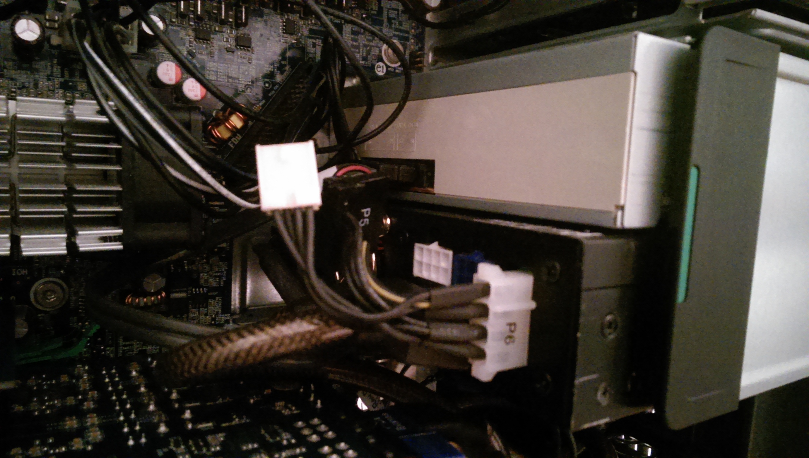

You're going to need a molex to go into the PSU that way it turns on when you turn on the computer. I'd convert SATA to molex and use the power thats there, I's also route the power lead in that little corner between the MP PSU and the optical bays. You'll probably need to pull the panel that hides the wires from the PSU to the main board it's just a couple torx screws.

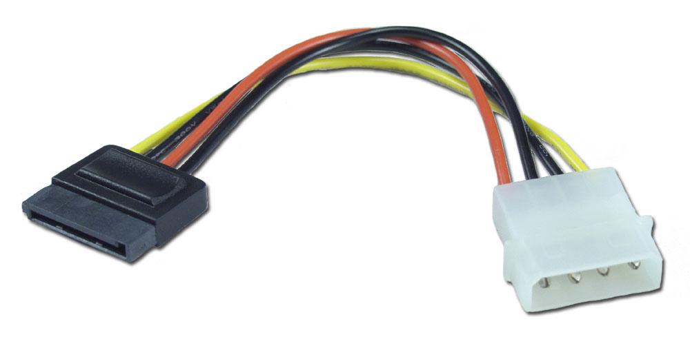

Just get one of these
And then I have all the cables necessary?
I use that with my sata to 8 pin? But I only have a 2 data to 8 pin cable...

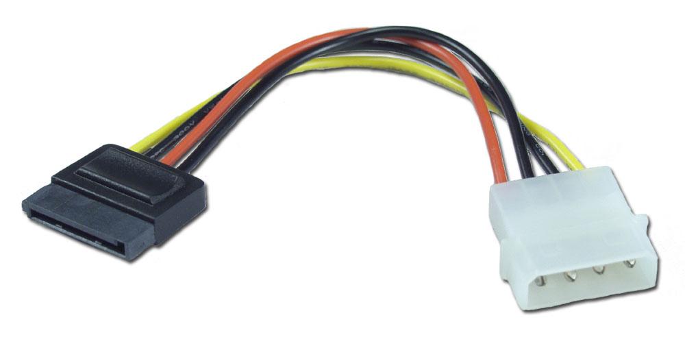

you need a male SATA to Molex (http://www.amazon.com/Manhattan-4-p...9196&sr=8-14&keywords=male+sata+to+male+molex) connector to go into the new power supply. You'll plug it into what ever optical bay you slide the PS into then into the PS on the other end. The power supply has all the other required cabling to go to your card, when you get it apart you'll realize what I'm taking about. The other cables you bought weren't expensive and they just might be handy down the road we all have the odd connectors and adapter cables laying around, no you won't need them but you just might in the future.

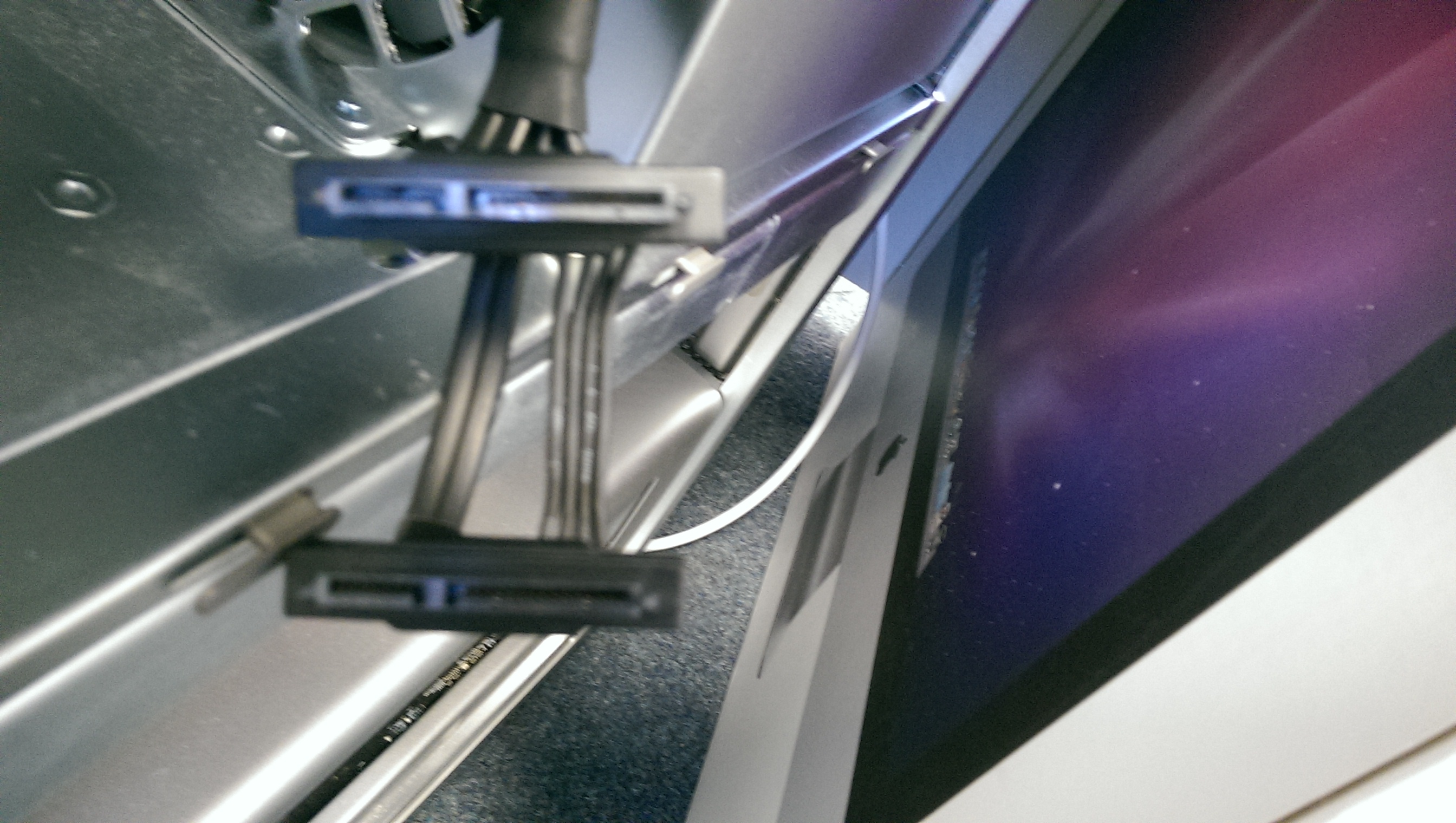

I'll take some pictures of the optical bay connector today before I go home and upload them when I get home.
Take the cable I liked and put it in here on the big side then plug the other end into the new power supply

OK,
I purchased this one because it has prime shipping. I'm assuming its the same thing: http://www.amazon.com/Manhattan-4-pin-Molex-Female-15-pin/dp/B001AQGEMQ/ref=sr_1_14?ie=UTF8

The cable is in the optical bays the top one is connected to the optical drive, the bottom is free. The cable to go to the card will come in the box it's PnP you'll see when you get it.
