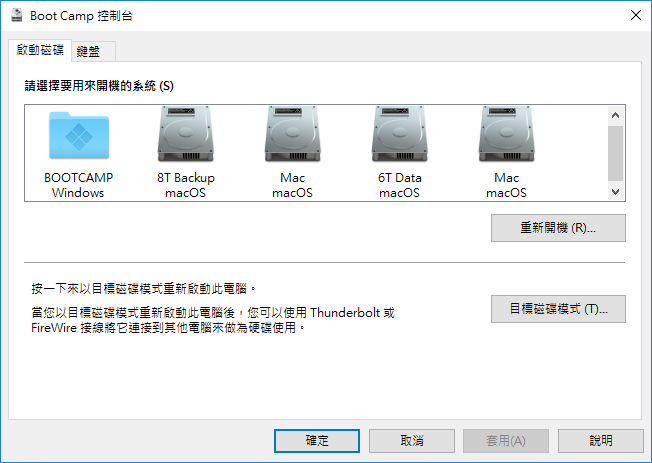

There is no macOS option in Windows Bootcamp?
And I never say that install bootcamp on the Windows side can fix the GTX1080 issue.
I was answering your question about how to switch between OS.
If the macOS side isn't working yet (e.g. nothing display through the GTX1080), you have to fix that in macOS side order to dual boot properly.

There was an option in Windows Boot Camp like yours.
Although you never said to install Boot Camp on Windows side to fix the GTX1080, I still had to install that because that is the only way for me to switch from Windows to Mac OS back to Windows.
It was NVRAM which fixed the issue ultimately. I didn't do anything else other than installing Boot Camp for Windows.

Happy to hear that your problem is now fixed.
So, with Bootcamp apps, you can now switch between OS without boot screen (it's faster than holding option during boot anyway).
