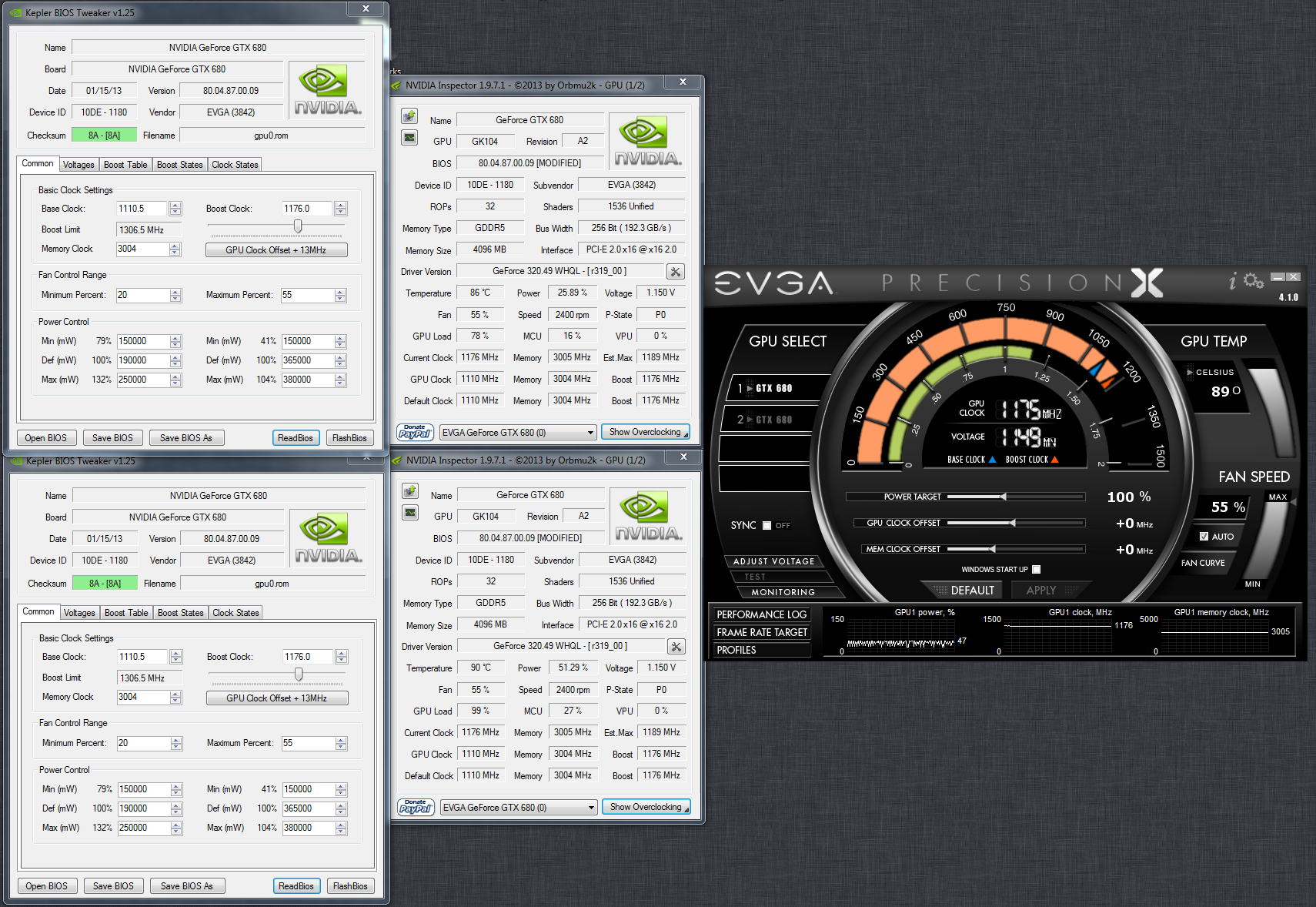

I overclocked my cards BIOS directly with Kepler BIOS Tweaker. No need to run Precision X but it seems to work also. I'm running the same specs & speeds as a Classified card without any issues.
If you OC with a utility in windows like Precision X then you're only OC'd in Windows. If you OC the BIOS of the card with Kepler BIOS Tweaker then you're OC'd in Windows and OS X.

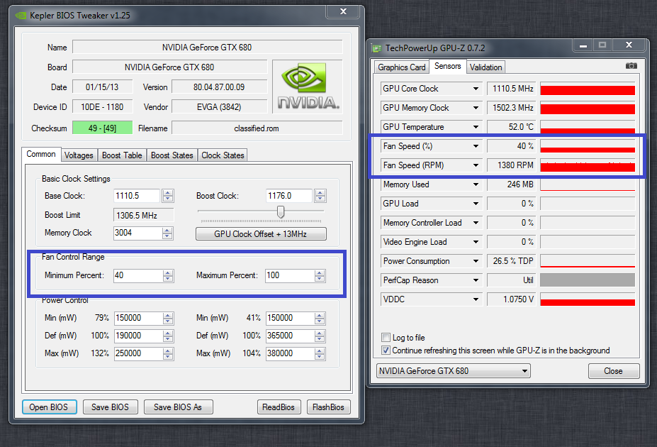

PCI Fan Speed
Can someone look at what their PCI fan speed idles at with the GTX680 in place?
With the legacy AMD card the fan idles at 800 RPM (e.g. quiet), where with the GTX in place idle speed in my case is around 1400 RPM (e.g. annoying growl). But that said the card I purchased was an open box return and there was a splash of heat sink compound at the edge connection. Thus I'm wondering if someone was playing with an after market cooler and didn't get the card back to factory configuration...
Also I tried playing around with the GTX's default fan speed. Didn't help. Also with clock speeds in an attempt to lower power dissipation. Also didn't change anything.
I notice that on boot the GTX leaves its fan at low speed, where the AMD runs maxed out until the system boots. The result is that the GTX drives the PCI fan to crazy high speed some time after boot things cool down and the PCI fan gets to the number cited (1400 RPM). Does this sound normal for the GTX?

Hi,
This is not normal your PCI fan speed should be 800 rpm. Luckily there is a solution to this and that is to stress your card/cpu so that the PCI fan goes above 2000rpm after which it goes back to its normal behaviour and will remain to do so until you turn off your computer. Even a reboot will not result in the high PCI fan speed (notice also the CPU fan shows a similar behaviour but is less noticeable compared to the PCI fan).
Use Kepler BIOS Tweaker to verify the fan speeds have not been tweaked by a previous owner. I have my minimum set to 40% but stock is 20% to 30% from what I've seen.

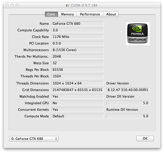

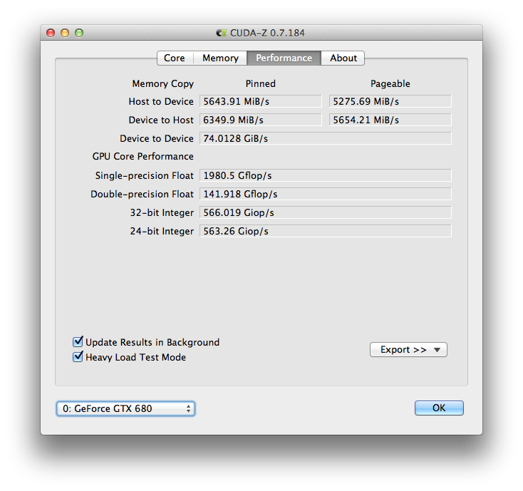

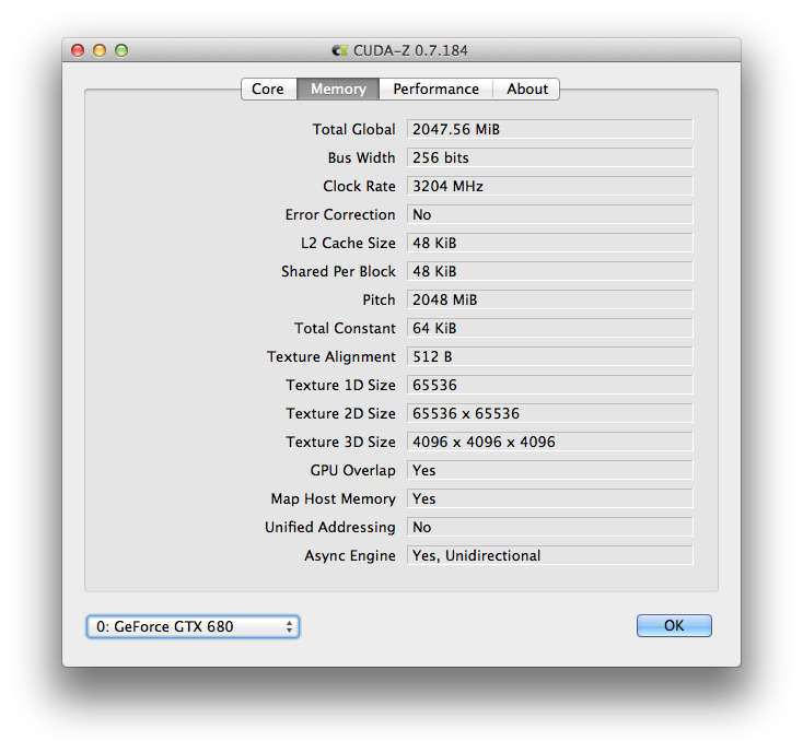

I wonder if this approach could be used to overclock my real evga gtx680 mac edition in OSX. Has anyone tried that? Using MSI Afterburner in Windows 8 to overclock the card in windows. The biggest improvement I've seen at least with benchmarks is overlocking the RAM.
Decided to answer my own question. Used cuda-z to verify. Again this is the real evga mac edition 2gb:
cuda-z is reporting the boost clock, not the core clock for some reason. But everything else is correct.
Core is now 1110: Boost 1176: Ram: 6408
Power Output threshold appears to have been increase but I'm not sure how as I did not change anything in that area. It might be something thats done automatically when modifying the rom in kepler tweaker?
Also, more importantly EFI did not get touched and boot screens are intact.
