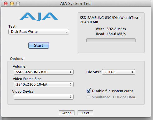

With the same SSD ( Samsung 830), this is my result on the rocket 640L
I will make some RAID test this week ...

Black Magic Disk Speed Test
Been hammering it, restarting into Windows and god knows what and I hasn't missed a beat.
So 100% working, as it should do. Good times!

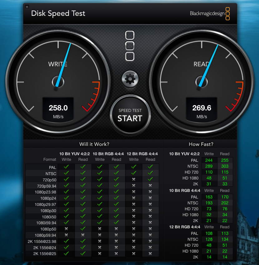

Hello,
Have you ever test your card with Black Magic Disk Speed Test to know how your SSD can get speed with incompressible data?
Sorry for my english, I'm french.
Thank you.

I don't see much point to be honest, it will bench the same as it does on review websites? It works and works well is all that matters.
And I didn't notice a difference, my mac stays asleep 99.9% of the time I'm not using it.

Je pense qu'il faut vraiment en avoir rien à faire du temps de démarrage d'un ordinateur pour ne pas s'apercevoir qu'on peut parfois perdre 10 secondes par rapport au SATA II natif avec certaines cartes PCI Express 2.0 x2 or x4.
Samsung 840 Pro 256GB in SATA II
Mac Pro 3.2GHz 2010
QuickBench version 4.0.1
Read: 273.498 MB/S
Write: 261.111 MB/S
SATA II is the fastest SSD I've ever had. I've tested a Crucial C300 256GB Plextor M3 256GB and under the same conditions and the new Samsung 840 256GB Pro is by far the fastest. It saturates the SATA II read and write almost as one with 26x MB / S. I've never seen a new generation of SSD to be as fast as SATA II, especially on a Mac Pro.
SATA III with the PCIe 2.0 x4, it must tear grave.
