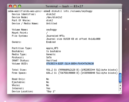

Type "diskutil info /Volumes/volume_name" and copy the Volume UUID (bunch of numbers).

Should be like this:
Alternatively, you can get it from Disk Utility.app,
Just a note. You need to create the fstab file for my instructions to work. Use that sudo nano command Chrysaor wrote down in the first post. Try typing LABEL= this time.

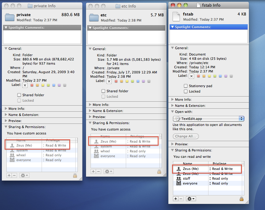

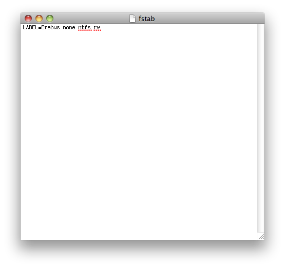

Thanks for your help Chrysaor I would have never known Snow Leopard could do this was it not for your thread. I (finally) got this working albeit a different and probably more dangerous way...
1. opened terminal and typed
Code:
open /private/
2. gave myself read/write permissions the manual way for private, etc, and the fstab file (see attachment) by highlighting each folder and file and then pressing command I
3. typed
Code:
LABEL=Erebus none ntfs rw
were Erebus is the name of my bootcamp partition and then saved the fstab file.
4. rebooted.
