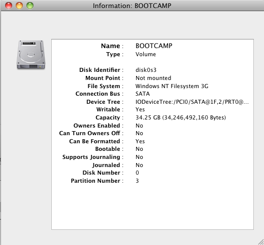

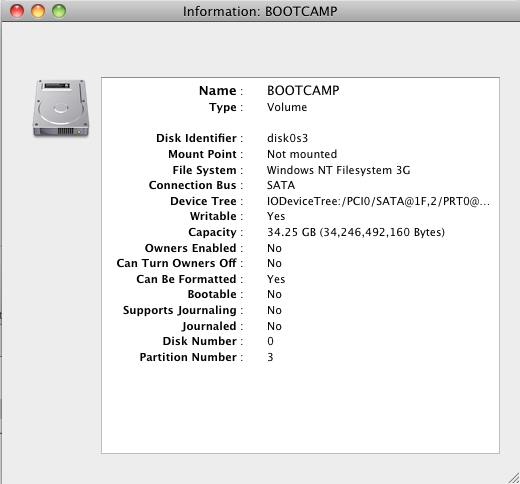

I don't know if something has changed in SL since the last post, but none of the above works on either my internal drive's Bootcamp partition (made under 10.5). I cannot get a UUID from the command line or from Disk Utility. The drive is not mounted and there's no information about it. Disk Utility sees the partition, but cannot verify or repair. I tried running chdsk while booted in Windows, but that cannot be done as it is the boot partition, i.e. it cannot be unmounted first. I attached a screenshot of what Disk Utility gives when I ask for information. I also tried using the Label=BOOTCAMP method, but that did not work either.
Any suggestions would be appreciated.
