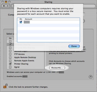

Just writing to mention that there is a *potential* bug that causes some headaches in OSX 10.4.2.
In System Preferences -> Sharing -> Windows Sharing, you now have to "Click Accounts to choose which accounts can use Windows Sharing." When you click on this, a list of accounts on your Mac will appear, and you select the ones you want to enable, then type in the password to authenticate the account.
The bug occurs when you type in your Account password and authentication fails ("Incorrect password") -- which isn't correct because your Account password *should* work in this instance. To fix this, go into your account settings (System Preferences -> Accounts -> My Account), and force a change of password for your account. This will enable you to authenticate yourself for Windows Sharing.
Just mentioning for everyone's benefits. Caused a lot of frustration here trying to figure out why I couldn't authenticate myself!

Okay, I figured out what it was.
On the Sharing folder, you have to make sure that the account is shared. Simple, but not always so obvious to MacNewbies:
Click on "Accounts..." and tick the box of whichever account you want to allow in to the Mac:
Thanks for the help!

Well spotted that man! I remember doing that now when I upgraded to Tiger, but it completely slipped my mind that it might be an idea to update this guide....I'll get right on it 😱 😉

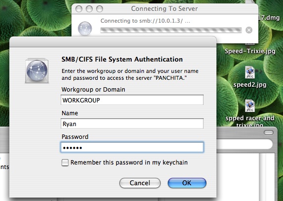

connect to PC
So is there anyone out there who can help. What does it take to connect to the PC (XP). Does xp have some silly thing that prevent 10.4 from connecting to the shared files...
Can you do this?
Connect to servere GO>connect...
enter IP address of PC on network (airport)
- smb://10.0.1.3/
type on
WORKGROUP = workgroup (PC computer workgroup title)
NAME = user name on pc (Ryan)
Pswd = *******
but then I get the error dialog
"Cannot connect to serve because name or password is incorrect"
but it is correct!
what am I missing... I have set up the PC and mac as directed. I can ping wach computer seperatly. I can connect to mac from PC and push files.
I need to connect to pc from mac... but can not.
Any advice?
much appreciated!!
thanks
- smb://10.0.1.3/
You don't seem to be specifying a share to connect to, which *could* cause a problem. The address should be smb://ipaddress/sharename. Also in the WORKGROUP field you should be putting the name of the PC, not its workgroup.
Thanks Edesignuk... I'll give it a try. If this doesn't work not sure what will, it seems like I have tried all angles... I am thinking my windows is not letting me connect for some reason.
cheers,
skillz
