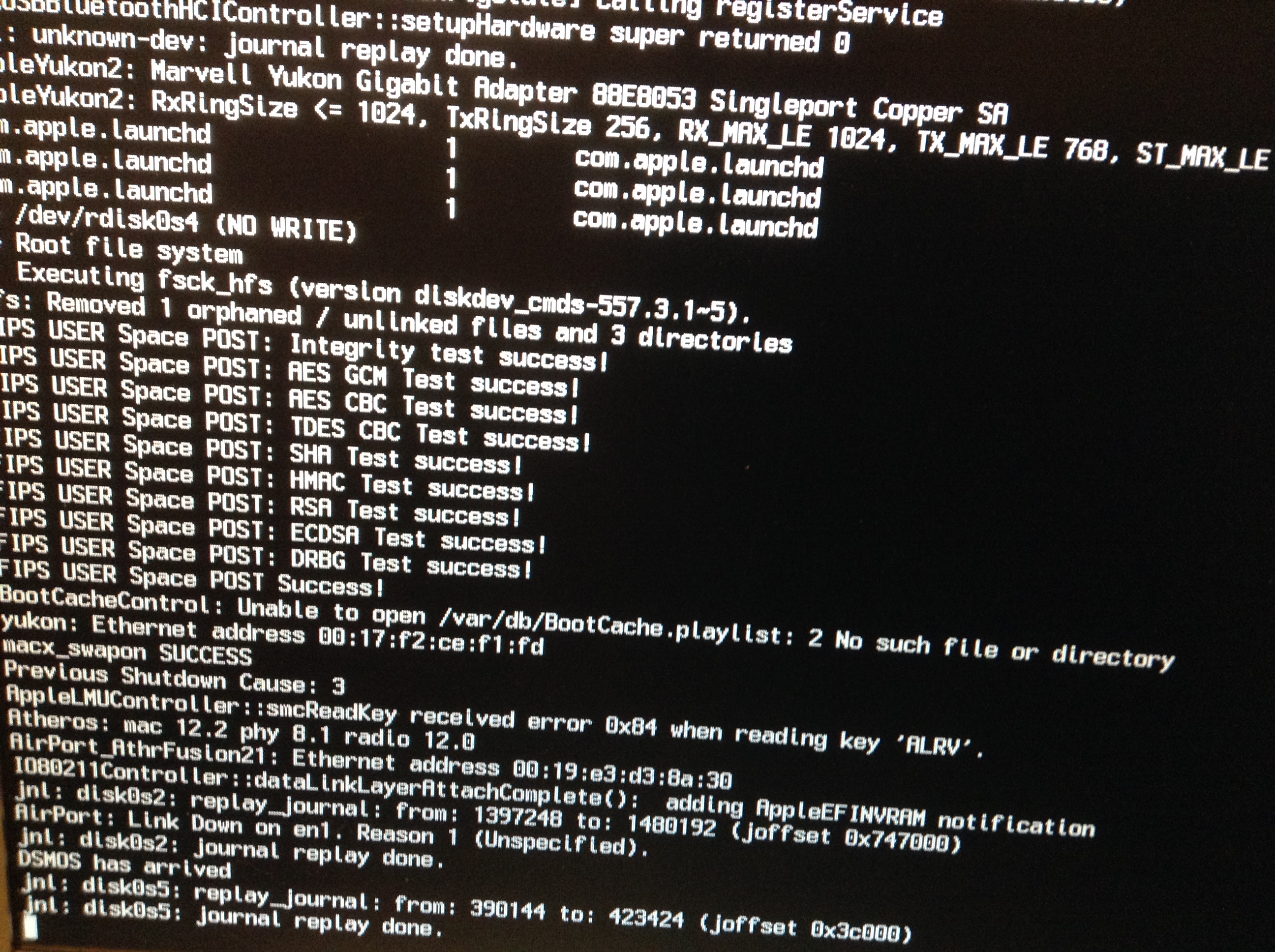

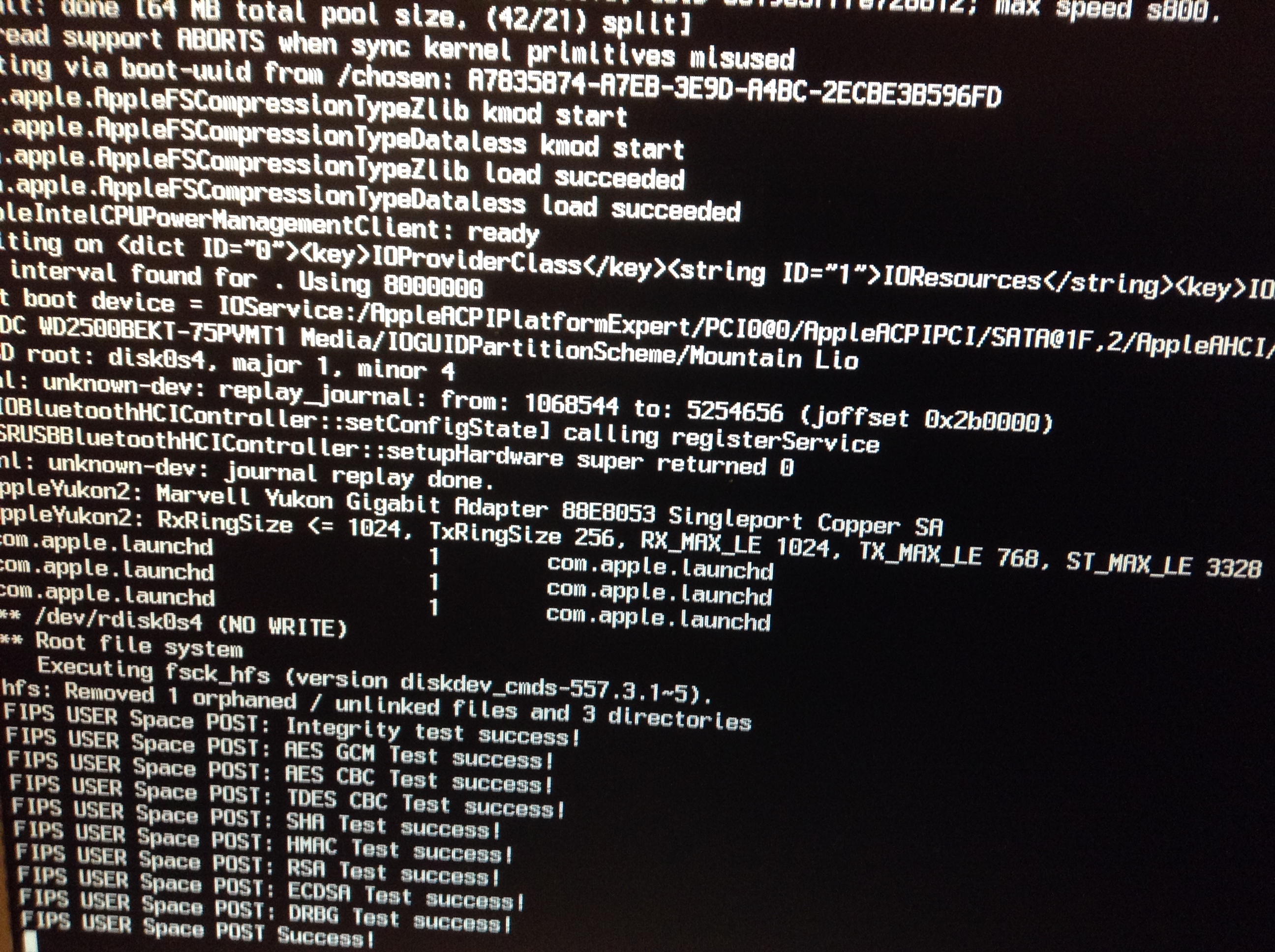

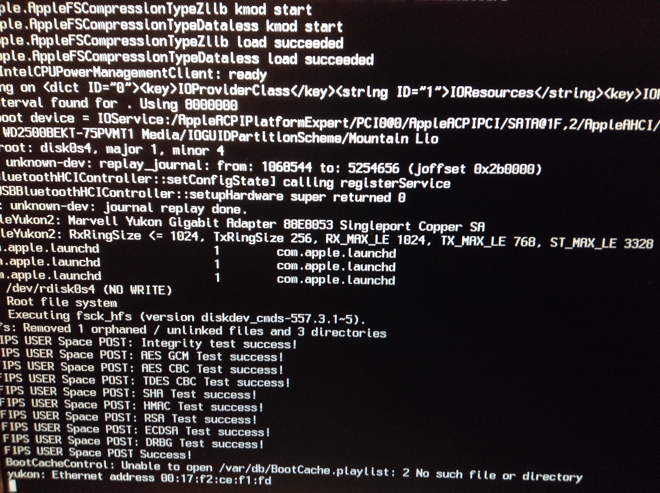

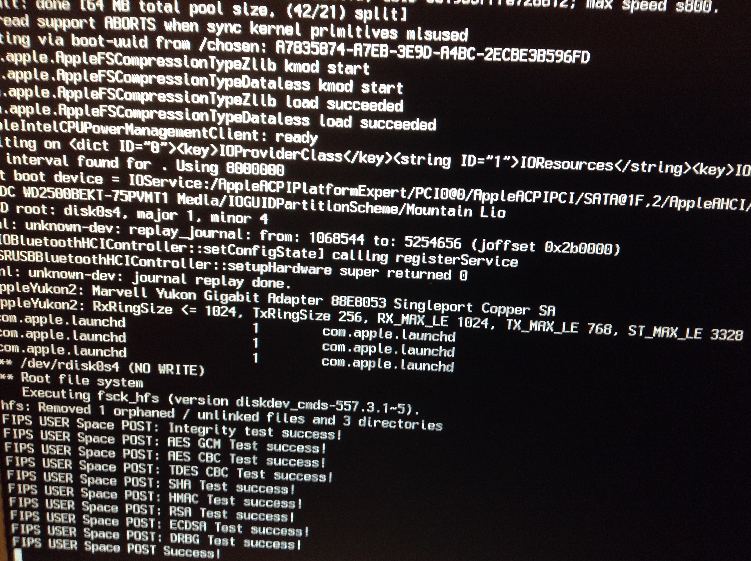

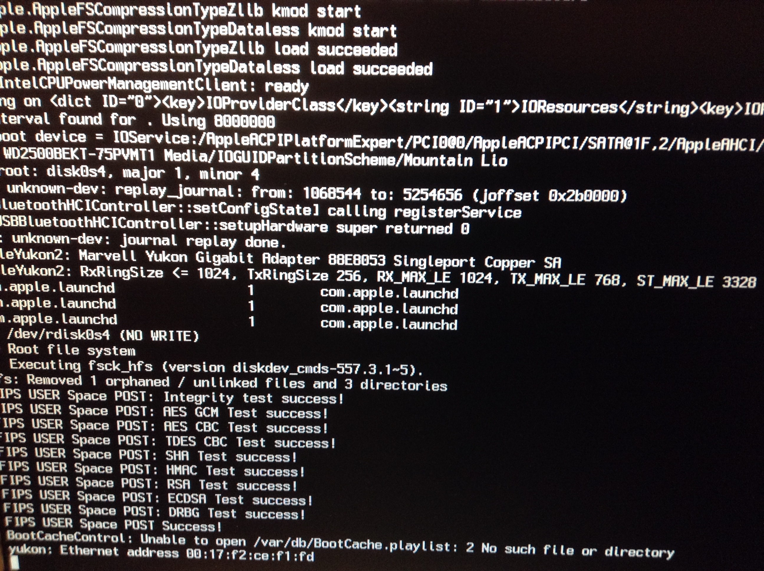

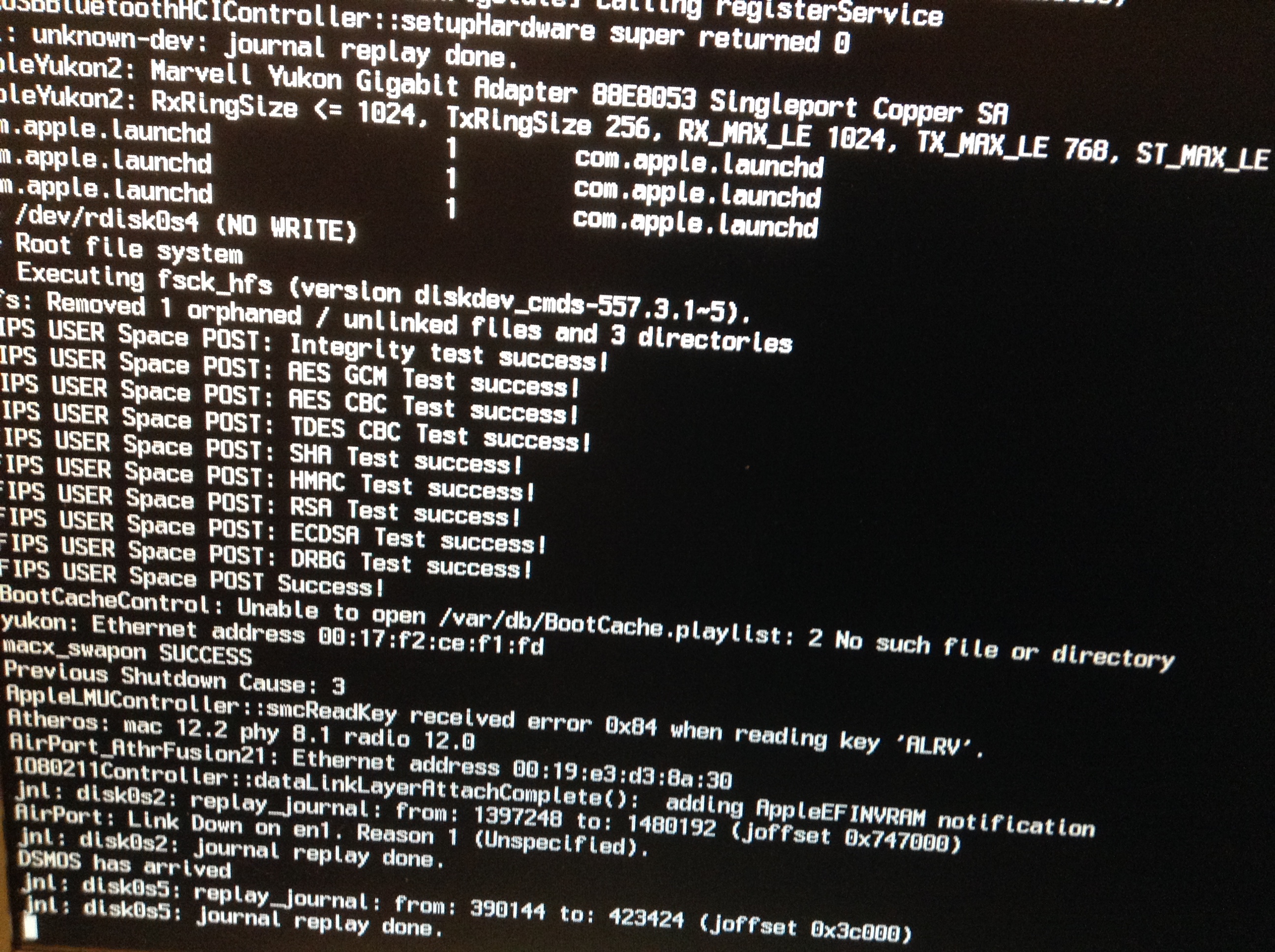

Cannot boot Mountain Lion after successful Install
ok I have taken several snapshots, since I cannot cut and paste from the screen.
3 jpeg files have been attached; the last one is where it gets stuck.
Please let me know if you get some clues about what is the issue here.
Thanks in advance for your help.

Well, only the last image is interesting. As the last line is about journal replay it seems to be related to the hard drive.
Anyway at first you should try booting into safe mode - this is done by holding shift, until a grey progress bar appears (you should disconnect any external hardware). If you are able to boot the system this way launch disk-utility and repair the drive AND the partition your booting from (not just the permissions).
If you still can't boot your system boot from the installer again and apply the previous steps with the installers disk-utility.
