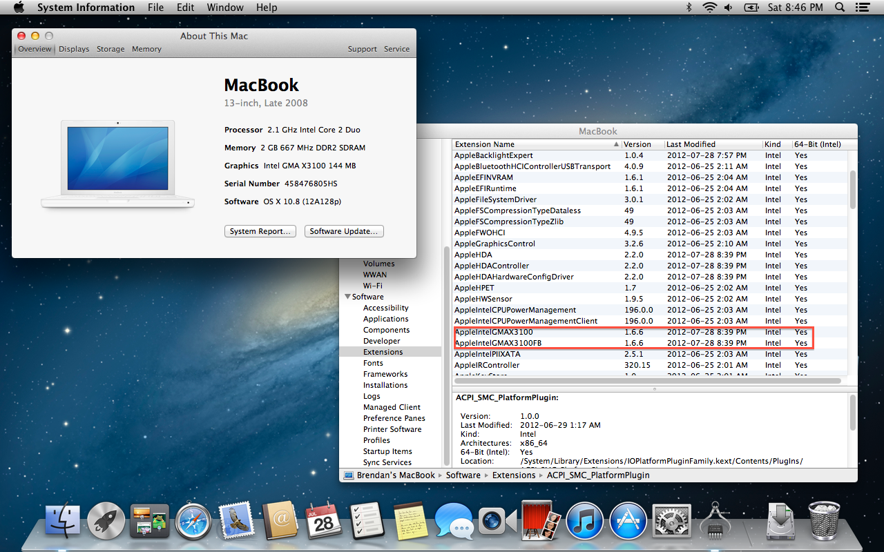

Installation completed successfully. Working on 8-12, will update this post when I try to boot.
Update: There were a few hiccups installing the kexts like the computer not wanting to restart. Graphics work as intended but sound does not. Most or all system sounds seem to be working but that's it; nothing from files or Safari.
Updated Update: Sound works. I don't know why because I didn't do anything.
