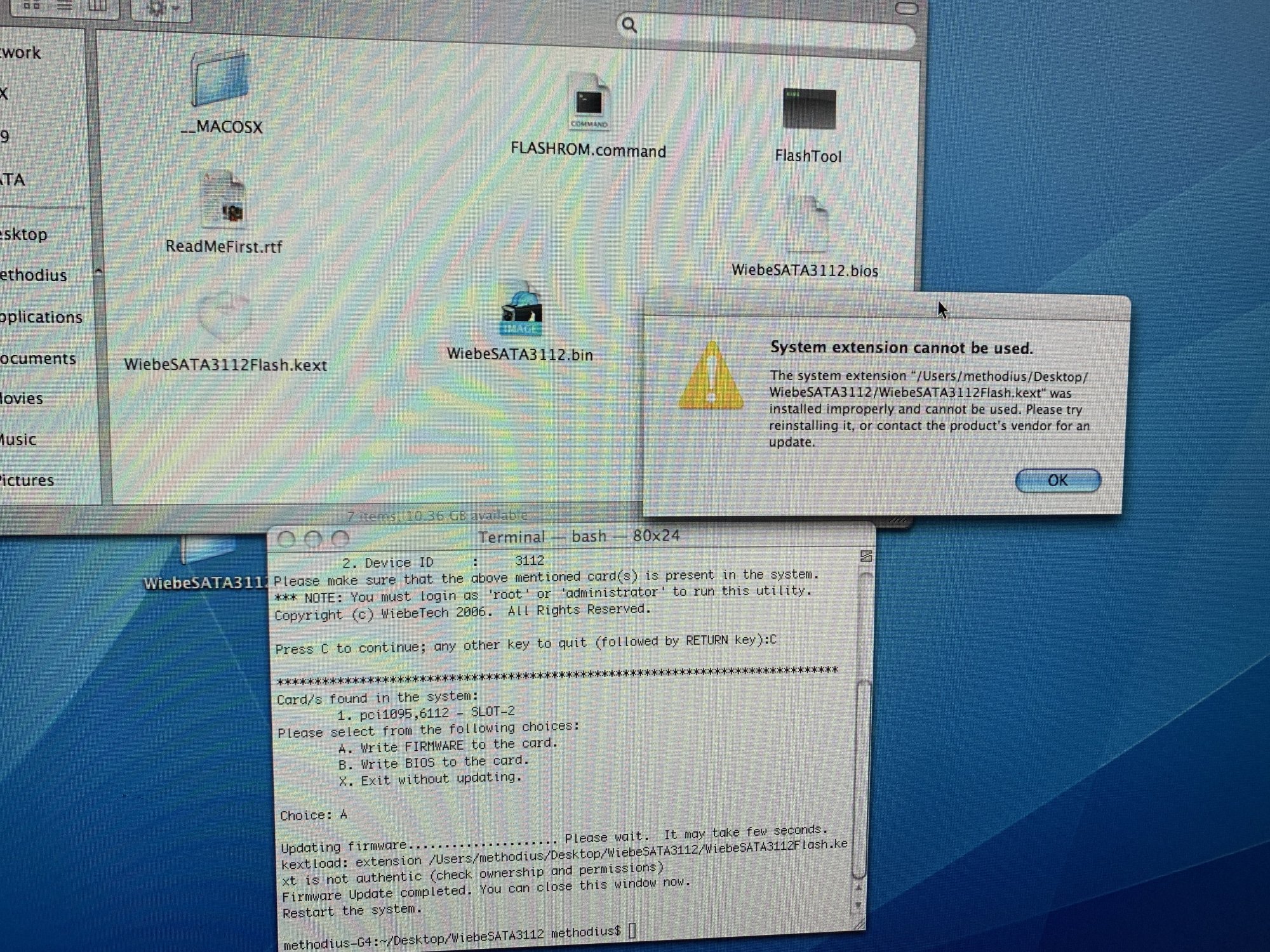

Ok I tried my luck with Wiebe flasher on Tiger and while it does find that there is a card , it complains that the flash kext cannot be used. Anyone else use the Wiebe flasher ?

The WiebeTech's flasher supports only chips from SST, ATMEL, PMC, WINBOND.
PS: I don't like the link preview on this forum. It doesn't represent the content in the link. I've forgotten how to disable it and I don't have time to figure out how to do that. So just click the link, it will lead to the right comment in that thread.
The WiebeTech's flasher supports only chips from some brands.
Thanks for that . It seems to answer why it wouldn’t work on the kext that came with it and would need a patched kext.

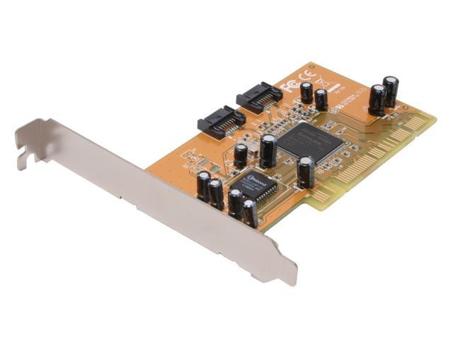

Hi everyone. It is possible to flash SUNIX SATA2000 with Sil3112 chip in Ubuntu PPC using flashrom? I do not have access to other PC with PCI cards.
Has 1mb chip(128KB)
Supported by Flashrom.
Can I use Firmtek ROM? https://www.firmtek.com/download/
Has 1mb chip(128KB)

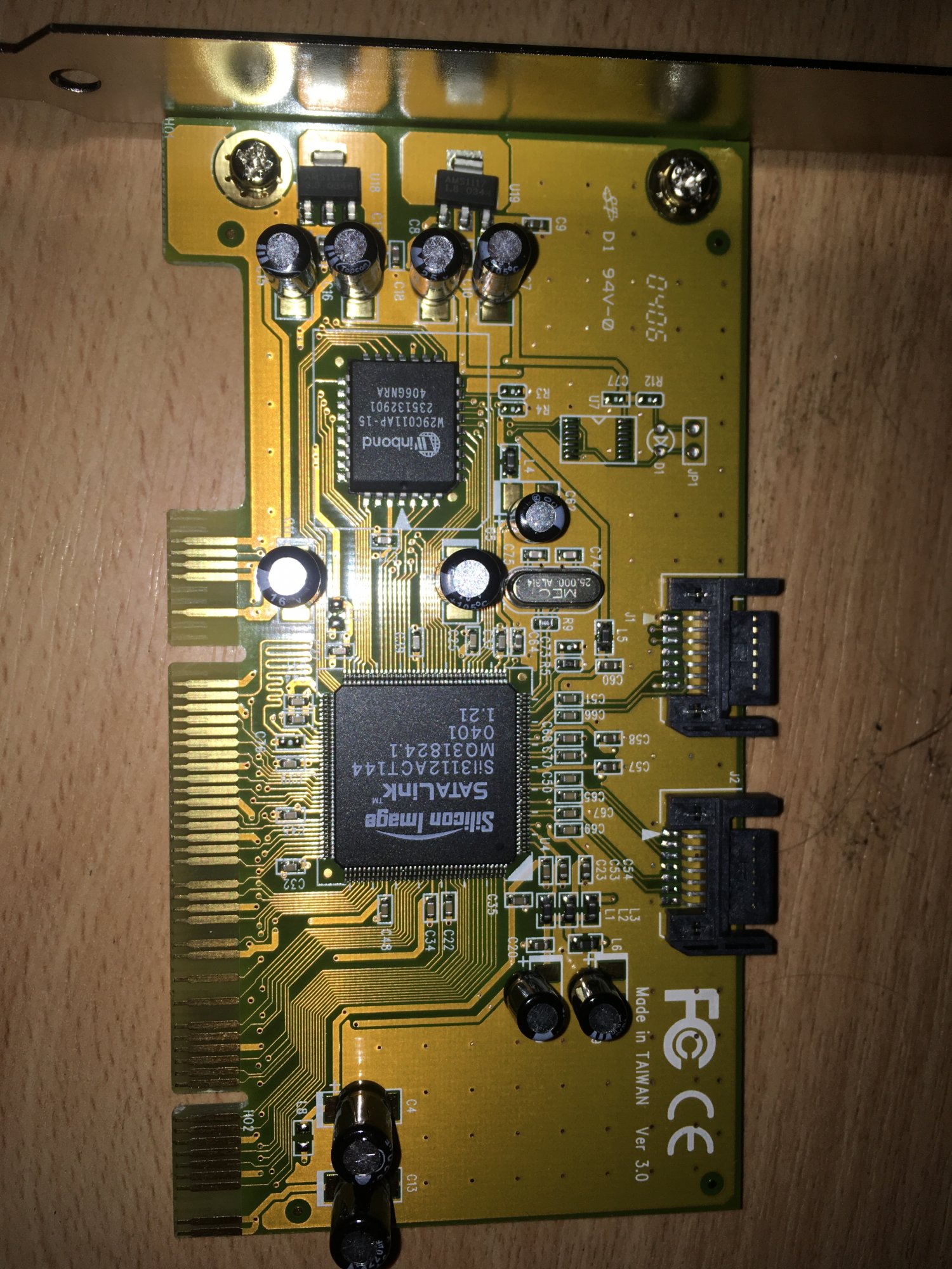

Hi. I need some help! My QS will refuse to boot with card installed.(common problem here) Has anyone found a solution?
Card is not flashed yet.
It's one of the two small 3-legged chips right up by the bracket plate. Your card is a different design from most and I'm not sure which of the two governs 3.3v as it is usually in the bottom left hand corner with the other chip in the top right hand corner of the PCB. There is a guide of sorts on the MacOS9lives forum but the site is struggling to load today so I can't link to the pictures. Basically, you will need to identify which one governs the 3.3v power input and replace it with an MIC29150 chip. Note also, that the pinout on the MIC29150 is not in the same order as the chip on your card so that you will have to use trailing wires and flip a couple over. If I get time tonight and the MacOS9lives site stops playing up, I will link to the thead.
Reactions: adam25255
OK, got it. I need to swap that left one... Thank you. Can I use this chip as well? https://www.tme.eu/sk/en/details/mic2940a-3.3wt/ldo-unregulated-voltage-regulators/microchip-micrel/ or it has to be 29150?(Need more accessible kind of chip, I cannot get 29150 at the moment, shipping takes3-4months)
AM1117 is 1A
What is the minimal current that I need?
3,3V is on the upper left.
And can I attach regulator to card bracket and pull wires to PCB?
