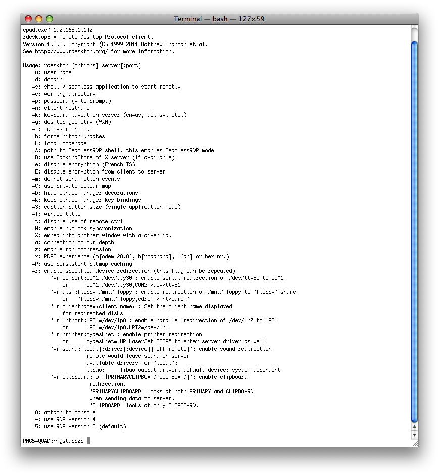

Now to test and see if everything is working. Type the following into Terminal and cross your fingers! Of course change USERNAME, PASSWORD, and IP_ADDRESS to your specific values.
Code:
rdesktop -u USERNAME -p PASSWORD A "%ProgramFiles%\ThinLinc\WTSTools\seamlessrdpshell.exe" -s "c:\windows\notepad.exe" IP_ADDRESS
Hopefully you'll see a Notepad window on your Mac floating by itself. Assuming it worked, lets expand that command and actually make it useful.
Code:
rdesktop -A "%ProgramFiles%\ThinLinc\WTSTools\seamlessrdpshell.exe"  -u USERNAME -p PASSWORD -r sound:local -r clipboard:CLIPBOARD -r disk:Mac=/Users/MACUSERNAME -r printer:"Brother_MFC_8820DW"  -s "C:\Program Files (x86)\Google\Chrome\Application\chrome.exe -no-sandbox"  IP_ADDRESS
That may look intimidating but it's not. Lets break it down.
  • rdesktop -A "%ProgramFiles%\ThinLinc\WTSTools\seamlessrdpshell.exe" <-- enables seamless mode and points rdesktop to the helper program on Windows
  • -u USERNAME -p PASSWORD <-- embeds the username and pw into the command so we don't have to enter it later. Use "-"as a password to have rdesktop ask every time if you don't want to save it.
  • -r sound:local <-- forwards sound on the Windows to your Mac
  • -r clipboard:CLIPBOARD <-- enables clipboard sync
  • -r disk:MacHome=/Users/MACUSERNAME <-- shares your home folder to Windows, of course use your actual username (you can share as many folders as you like, just repeat the command)
  • -r printer:"Brother_MFC_8820DW" <-- shares your printer with Windows. You need to use the name listed in CUPS. go to 127.0.0.1:631 on your Mac and click the Printer tab to find out the correct name to use. (you can share as many printers as you like, just repeat the command)
  • -s "C:\Program Files (x86)\Google\Chrome\Application\chrome.exe -no-sandbox" <-- sets what program you want to use on your Mac. the "-no-sandbox" is specific to Chrome to work properly in seamless mode. omit it for other applications
  • IP_ADDRESS <-- the ip address of Windows of course

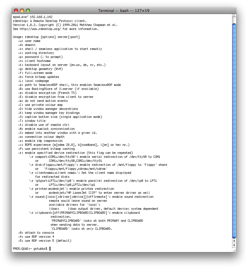

You can always type "man rdesktop" in terminal for a full list of all commands.

For Chrome:
rdesktop -A "%ProgramFiles%\ThinLinc\WTSTools\seamlessrdpshell.exe" -u USERNAME -p PASSWORD -s "C:\Program Files (x86)\Google\Chrome\Application\chrome.exe -no-sandbox" IP_ADDRESS
Notepad:
rdesktop -A "%ProgramFiles%\ThinLinc\WTSTools\seamlessrdpshell.exe" -u USERNAME -p PASSWORD -s "C:\Windows\notepad.exe" IP_ADDRESS
When I put rdesktop -u USERNAME -p PASSWORD in first instead of middle of the command, I get a list of different terminal functions I can use.
Figured out why I was getting the command usage, I forgot -A in the command with rdesktop -u -p
When it goes to connect I receive the same error as my post above with the broken window.
