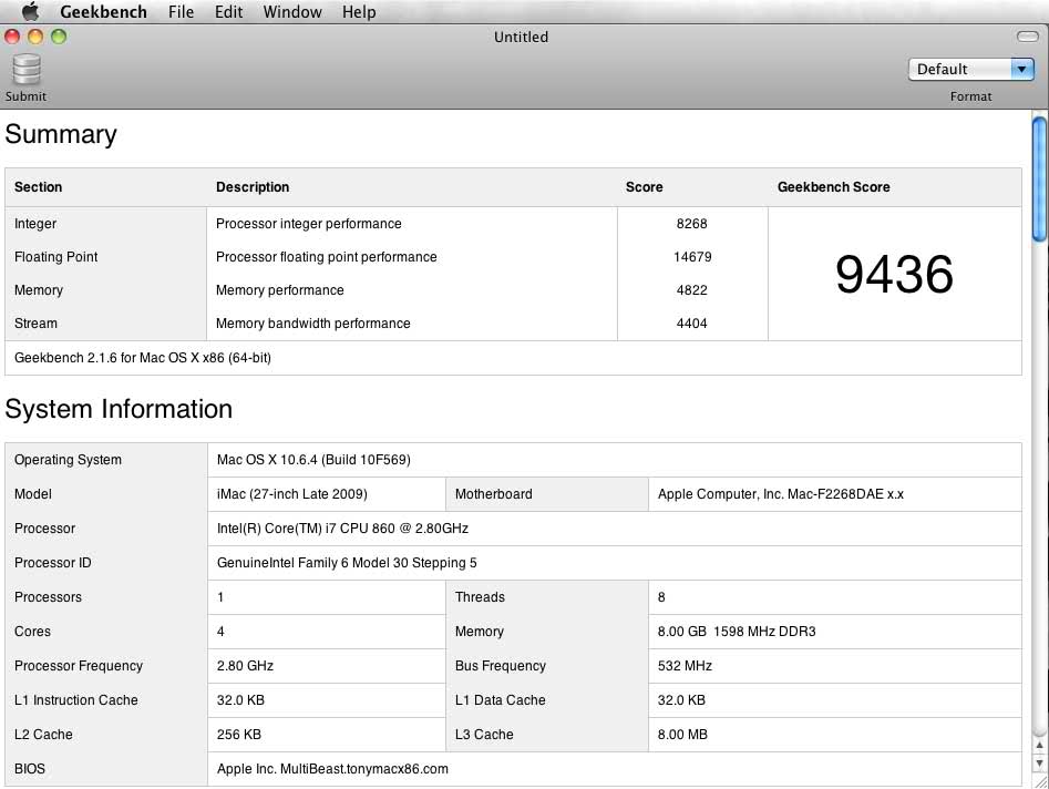

I'd like to add to this as someone who's lurked on here for 7 months desperately awaiting a 2010 mac pro release.
Please note the following:
-I had $3000 in apple gift cards that were a xmas present from a client
-On top of that cost wasn't an issue- HOWEVER I was unwilling to spend $4500 on 18+ month old technology like many of you.
-The computer was for business purposes and needed to be 'stable'
-However I also have a 2.4ghz 2008 Imac and a 2.4ghz 2008 Macbook that, while slow, could get me by for a few days in a pinch down the road of something went wrong.
I grew more and more upset like many of you on here, and had sworn against a 'hack pro' mainly for the same reasons as most (though the 'ILLEGAL HARMZ AAPL!11" comment above is just hysterical)
Finally after stumbling onto Tonymacx86's iboot + multibeast install method I decided to take the plunge as I understood this.
Aside from one CRITICAL error of using first a samsung optical drive instead of a Sony Optiarc or a Pioneer which are both compatible and this taking me 5 days to troubleshoot (had I realized this during the initial build I would've simply bought a Sony, as I now have in the system for a whopping $19.99 which works flawlessly) the build/install was very easy for anyone who's built machines and can follow any sorts of directions.
My hardware includes:
-Coolermaster 690 II Case
-i7 860 Cpu
-Gigabyte P55A-UD4P motherboard
-BFG NVIDIA GTX 260 "OC Maxcore" GPU
-M-audio fast track pro (I mention because this took any issues/work of getting onboard sound to work out of the equation - this was moved over from the imac setup)
-8gb OCZ Gold 1600mhz ram
-(1) Intel X25-M 80gig SSD for OSX OS/Applications
-(2) Seagate Barracuda 32mb cache 7200rpm drives partitioned with -500/500gigs on each drive in a software raid 0 array as scratch disks for -1TB for OSX and 1TB for Win7 (to be installed on another 80 gig X25-M this week)
Corsair HX750 Modular Power Supply
-Targus ABC10 Mini USB Bluetooth Dongle
-Magic Mouse
-Apple Alum. wired full keyboard
-Sony Optiarc Dual Layer DVDR Drive
-Zalman CNPS 10x Performa CPU Cooler
(en-route)
30" Cinema Display snagged for $1,299 from the refurb shop (Currently running a 22" Samsung along with output to a 32" Samsung HDTV in 1080p off the card. Zero issues)
Western Digital Studio II External eSATA drive which will be run in Raid 1 for files.
Total cost of the build excluding the external WD HD and the 30" Cinema display was right around $1,700
Performance so far (after figuring out the optical drive woes which caused kernel panics) is rock solid. CPU temperatures sit at 32 degrees C at idle, peaking at 40 degrees under load.
Geekbench performance is, at completely stock clock speeds is shown below.
All in all this will tie me over until a new mac pro that's actually worth picking up releases. Photoshop/After effects snap open with the SSD, sleep works fine, and the only thing that I've noticed that I *CAN'T* do is wake from sleep via the bluetooth magic mouse. So I have to hit a key on the keyboard.
-i7 860 Cpu
-Magic Mouse
(en-route)
I'll live.
Nice rig! But you most definitely have to overclock your i7 just slightly. I have my i5-750 running at 3.2GHz with Turbo Boost enabled and I'm at 9238. And it's not just numbers; it also feels much faster than the stock 2.66GHz.
You did use Geekbench 64-bit, didn't you?
