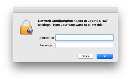

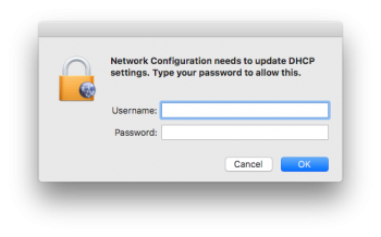

That said, I'm posting because I nearly got caught by this. I download Handbrake last week and was surprised to see a dialog on launch asking me to enter my password to "install additional codecs". As a longtime Handbrake user I was certain that this was *not* normal, so I declined. Shortly afterword I was shown another dialog, independent from Handbrake, purporting to be from the system "Network Configuration" which needed my password to "update DHCP settings". As this was also something I was unfamiliar with, I again declined but the dialog immediately reappeared upon clicking cancel and I had to restart the computer to make it go away. So yeah, if you see any suspicious password dialogs, do NOT enter your password.
If you rely on the suspicion system of security it is only a matter of time before you get hosed. These hackers are good at looking not suspicious, and the meaning of these dialog boxes is far from clear, making it close to impossible for most users to tell one that's legitimate from one that is not.
