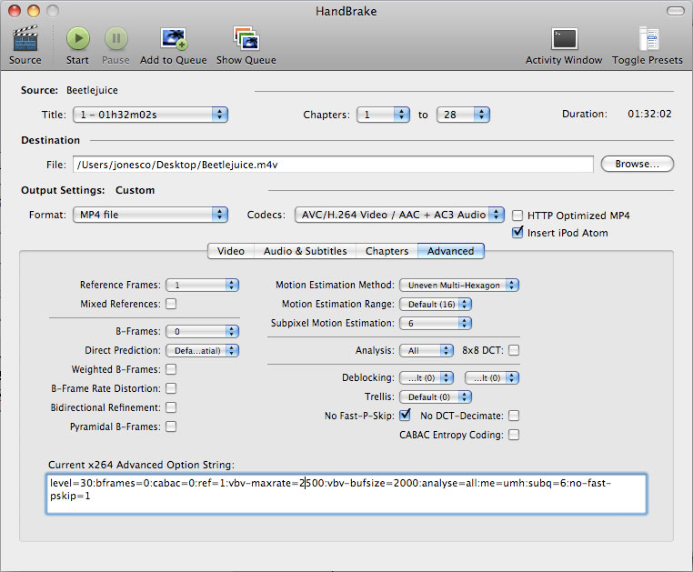

Um, for those of you starting out with the iPod preset then jacking up the bitrate, be sure you are also changing the vbv settings in the Advanced Panel.They are directly related to the average bitrate you use. Or try removing them altogether if you want. Though you then risk the chance of local bitrate spikes that could cause your iPod to drop frames on playback for complex scenes.

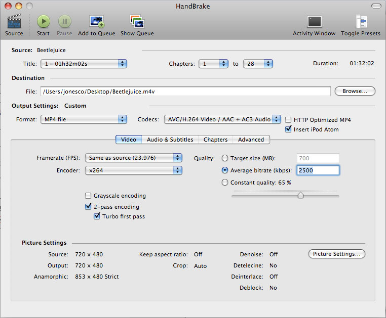

Can someone please tell me what I'm doing wrong? I believe I'm following the directions of the original poster exactly, but none of the resulting files from the 2 movies I've tried ever sync to my iPod. I start with iPod High-Rez on maximum resolution, change to strict anamorphic, set the bitrate at 2500, change to AAC +AC3 audio, choose 2-pass, and go, but none of the files will sync to the iPod. Handbrake reads: Source: 720x480, Output: 720x460, Anamorphic: 853x460 Strict. Any help is greatly appreciated!

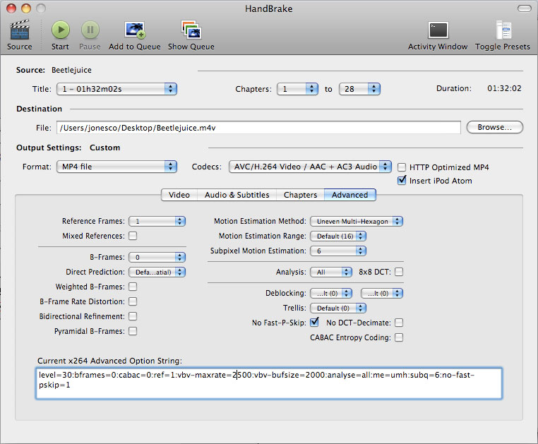

vbv settings
So you are saying to increase the "vbv-maxrate" to 2500 (if that is what you want the bitrate to be) from the hi-res ipod setting of 1500. What about the vbv-bufsize. It is 2000 in the hi-res preset. Would you increase it to 2500 (500 more than it's original setting in the hi-res preset?)
Before:
vbv-maxrate=1500:vbv-bufsize=2000
After?:
vbv-maxrate=2500:vbv-bufsize=3000

well, if the vbv-maxrate is less than the abr. vbv will be ignored pretty much, which means you open yourself up to bitrate spikes that can cause frame dropping.
rhester is the vbv guy for iPods over at the handbrake forums, but it seems to me going with 2500/3000 is better than leaving it. vbv is in many ways as much art as science in practice. The best place for a discussion of vbv is really in the HB forums as its a rathole not best gone down here. Realize that many movies will play just fine if you simply remove the vbv part of the opt string, you will really notice it mosly on very complex scenes like the beggining of Harry Potter and the Order of the Phoenix. That first five minutes can cause frame dropping in a big way if not properly controlled.
Before:
After?:
What do they do?
Thanks
Okay, so with an abr of 2500 on the iPod preset, it is sane to change the vbv-maxrate to 2500, but leave the vbv-bufsize at 2000. 3000 allows for too long of a buffer which the ipod does not have. So you would use this:
vbv-maxrate=2500:vbv-bufsize=2000

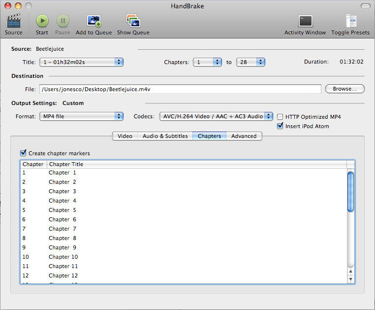

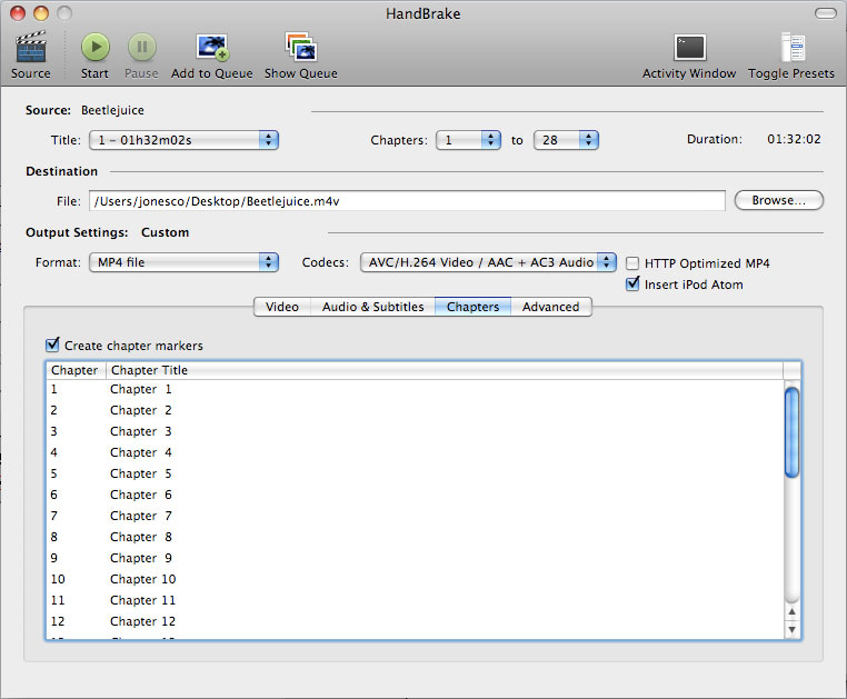

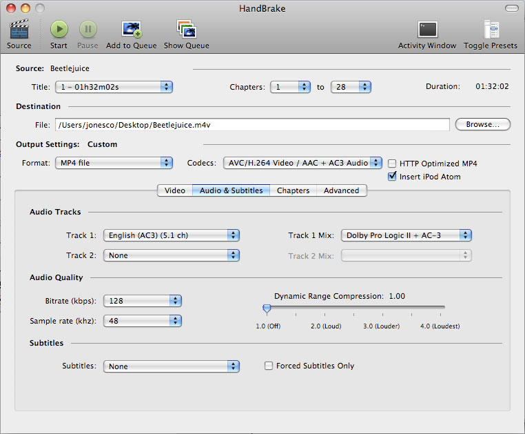

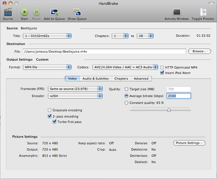

I made some screenshots. From what I can follow, these are the settings to create a high enough quality, itouch & iphone compatible .m4v (.m4v is the same as a .mp4) with stereo and AC3 (that's 5.1) audio that shouldn't be that large (file size).
Please let me know if I missed something.
