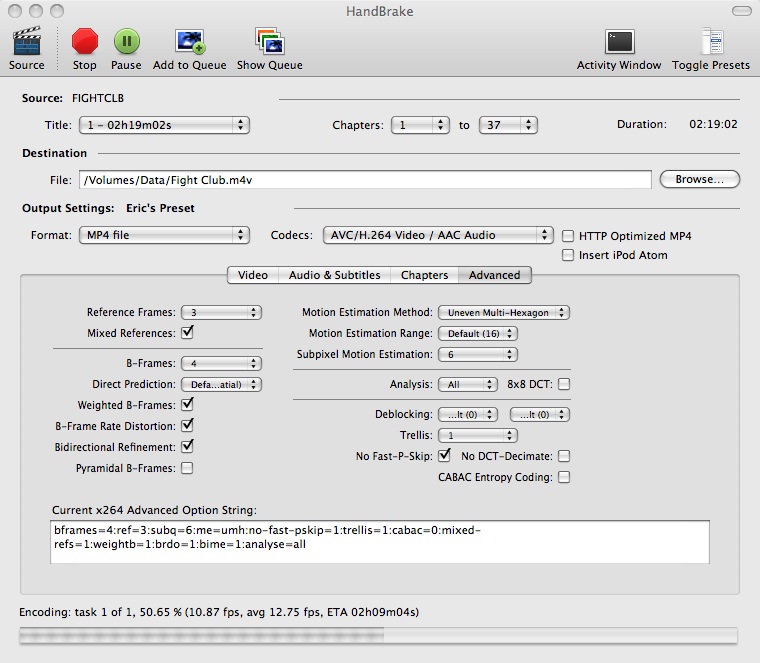

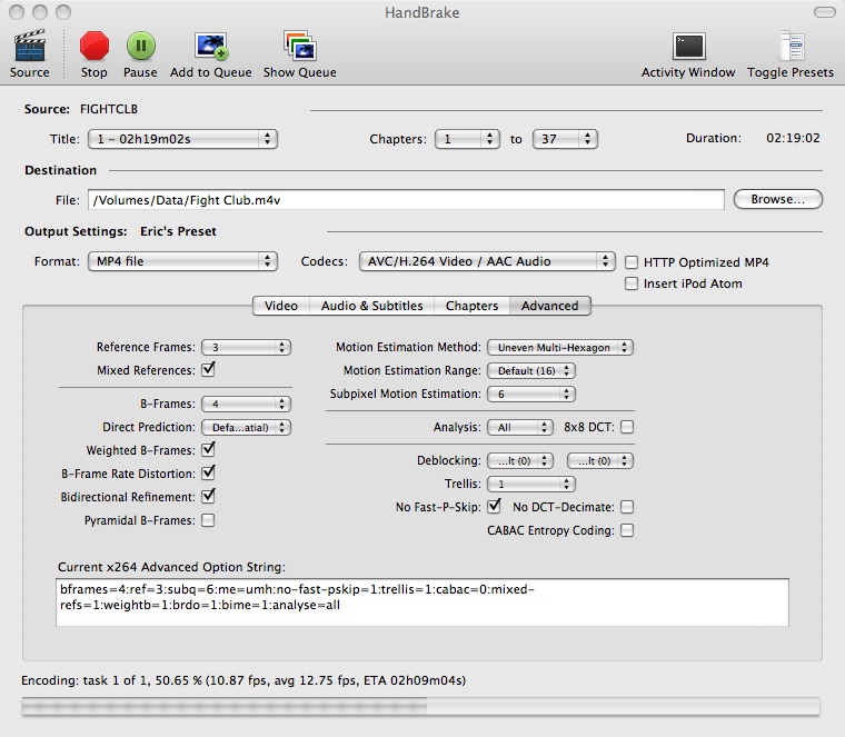

Click on the AppleTV preset, then go to advanced options and change everything so it matches this screenshot. On the "video" section use constant quality at anywhere between 66-70% (I use 66%) It will take longer but the encode will be higher quality and have a lower filesize. Enjoy.
