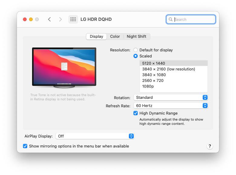

An update, I installed the Big Sur public beta and now have native 5120x1440@60 in the preferences pane. Don't know if there was something up with my previous Catalina install or if this fix was introduced with Big Sur, but very happy to report that it now works.
Check output of AGDCDiagnose command. It will tell you that you are using two connections of HBR2, not one connection of HBR3. The 5K2K display is interesting because it can use both types of connections for full display resolution. The LG UltraFine 5K display can only use dual HBR2 for 5K. The 5Kx1440p displays can only use single HBR2 (or dual HBR2 with PBP mode but that doesn't act like a single display).
This means HBR2?

Yes, but that section is for EFI which occurs during boot. For after boot, during macOS, look at the "Connections:" section where it will say HBR or HBR2 or HBR3.

It looks like your display is connected with two HBR2 connections - the EDIDs included in the AGDCDiagnose output will verify that both connections belong to the same display and that one connection is for the left tile and the other connection is for the right tile.
