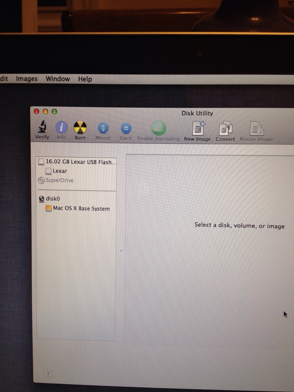

I only see disk 0 (1.9 GB ) and the superdrive in disk utility. She then plugged in a USB stick and it popped up right away.
I was not their to troubleshoot, I have an SATA dock I could have used to try test all the drives. I've changed many hard drives in macs before but never installed an SSD. I would hopping it was some stupid error.
I'm guessing logic board is bad or her boyfriend broke on connector. I hope apple has pitty on her tomorrow and fixes it since its only a week out of warranty.
She will find out tomorrow.

It's hard to say... need more pictures of it. Also, for the posters above, I meant, it is detected by OS X installer, but since the partition/filesystem is not recognized by OS X, then it won't install. It needs reformatting into an OS X applicable partition.
