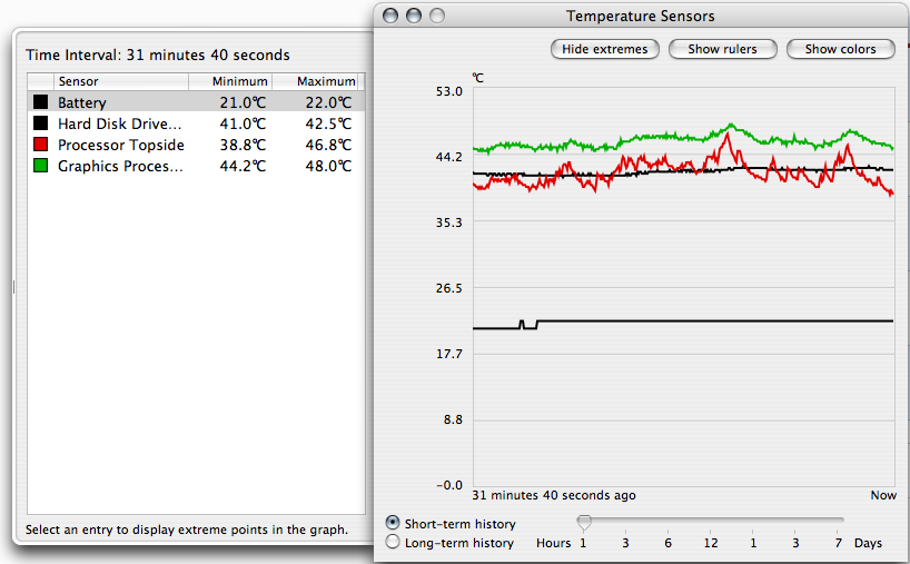

The Delong adapter sports a temperature-sensor and the temperature of the mSATA is about 20° higher compared to a mechanical drive and the temperature management of the PowerBook get close to be out of balance.
"G4FanControl" helped me to elevate the mSATA's temperature threshold to a level adapted to normal working temperature of mSATAs, which consecutively lifts up GPU/CPU temp to levels up to 65°C and makes the aluminium-case really feel hot but still keeps the fan off.

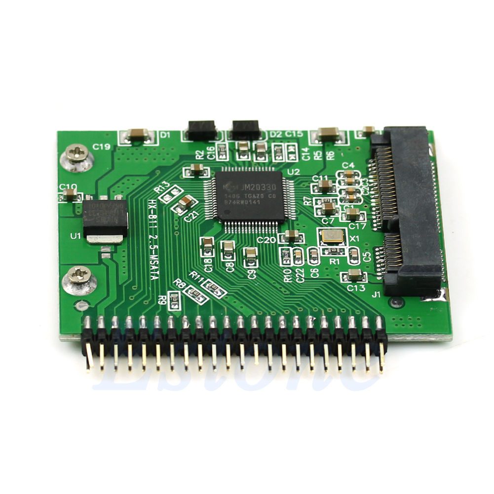

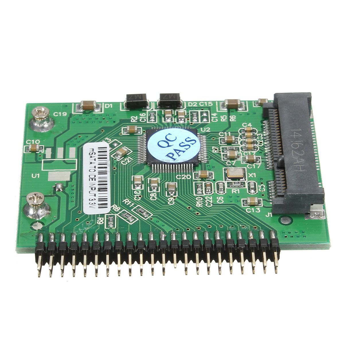

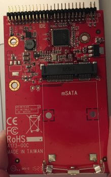

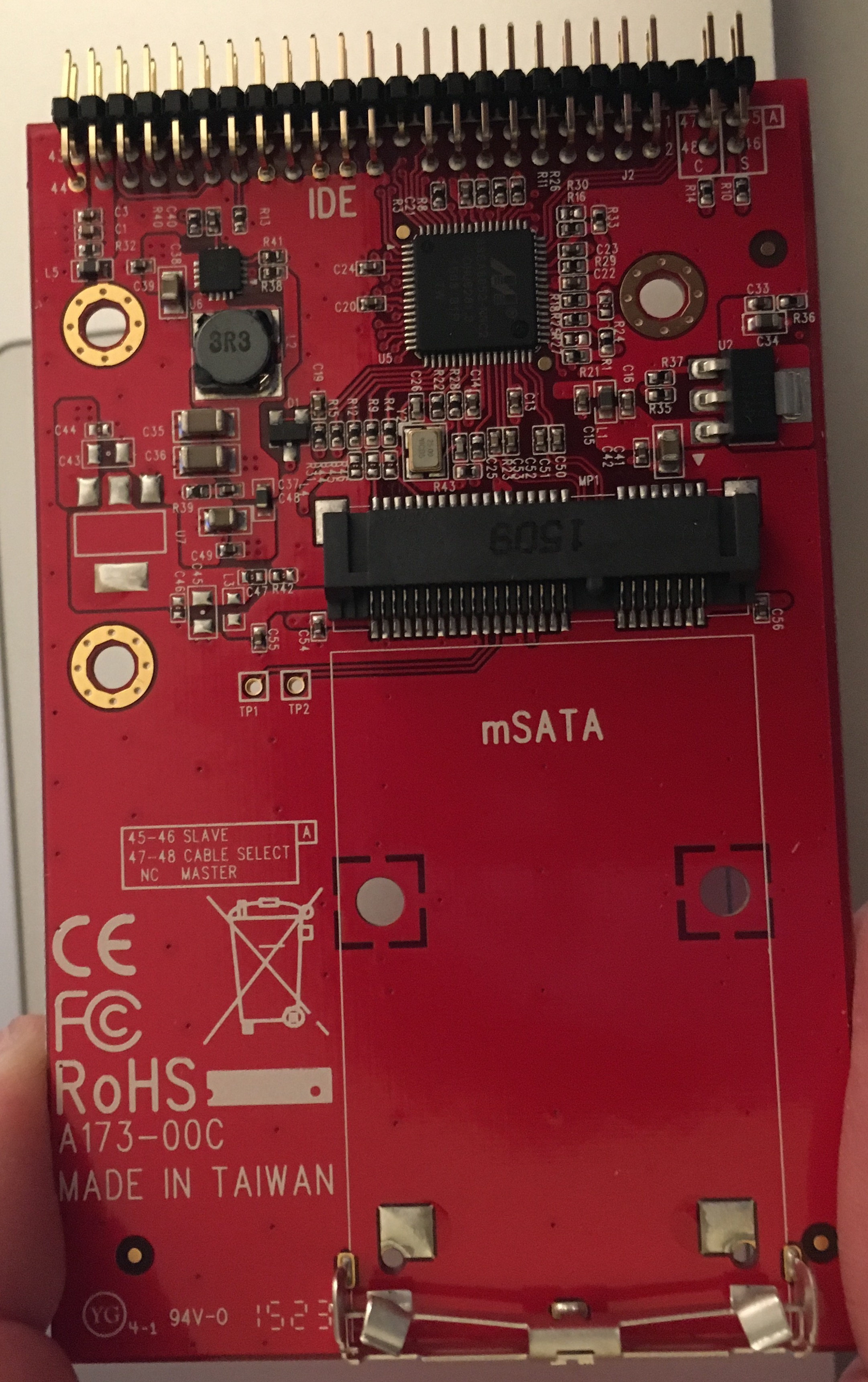

Here are two of the converter boards, one is 3.3v and one is 5v (assuming fleabay lets me use their pictures). If you compare them, they look the same except you can see the 5v one just has a regulator added (big power-looking chip on the left). A buck converter is usually more efficient, and it will have more components, including an inductor.
I have a 12" powerbook.
My Delock-Converter's components look like the ones on the upper of your pictures.http://www.delock.de/produkte/F_981_mSATA_62495/merkmale.html
Could you tell more, which one is more efficient and also more about that "buck converter" ...
