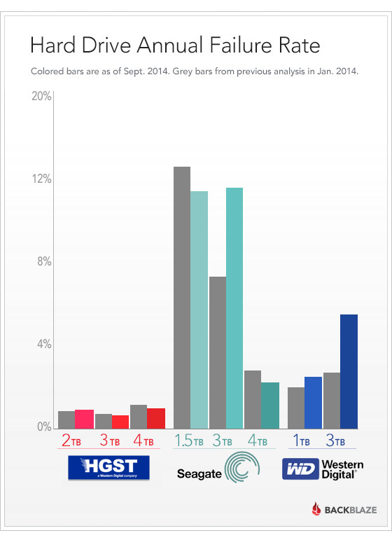

I prefer Western Digital (and their other brands, like Hitachi) myself. The statistics shows Seagate currently has a substantially higher failure rate than other brands. But hard drives quickly becoming a thing of the past...
