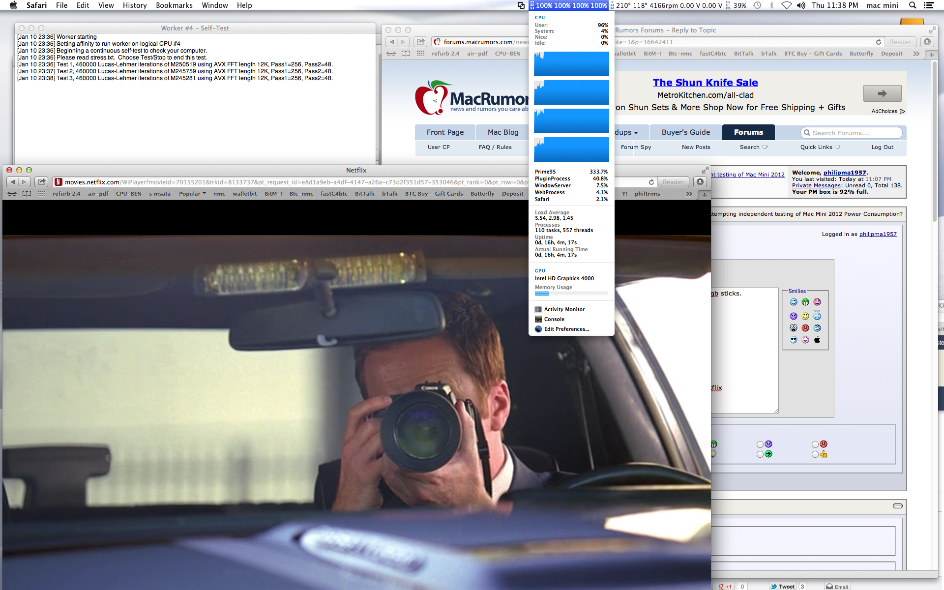

My base 2012 mini pulls 12 watts on idle. one mod that of 8gb ram a pair of these 4gb sticks.
http://www.newegg.com/Product/Product.aspx?Item=N82E16820104257
the same mini pulls 13 watts with light net typing like this answer.
now if I run prime 95 which pushs the cpu a lot it pulls 26.9 watts running
if i run it with 1 thread out of 4. = 26.9 watts
if I run it with 2 threads out of 4 = 33.33 watts
if i run it with 3 threads out of 4 = 37.0 watts
if i max it to 4 threads out of 4 = 37 watts if i run the max prime 95 and toss in netflix
the machine is maxed watts are 40 and the mini will show watchable net flix in 1080p. while the cpu is maxed and the kill-a-watt read 40-41 watts.
no 2012 machine can do this just a base 2.5 mini it does run hot maxed look at the thumb nail.
so running the base mini is between 12 to 40 watts. and no one (a few I suppose) will run it at 40 watts. 24/7/365.
I do not sleep my mini just my monitor. But it will sleep under 2 watts.
