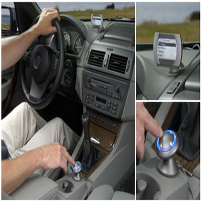

The combination I talked about using, (Alpine CDE-9852 with the KCE-422i), works fine. As with any of the iPods, you can no longer control the iPod with the actual device, but only with the head unit. You also have to turn off shuffle to enable control, but I like to just shuffle my music anyway, so I don't bother. Charging also works and doing an electrical test it showed that it doesn't put off too much power either. Side not, but I figured I'd mention it, I use a Harman Kardon Drive + Play in my other car and that also works with the iPhone. Every so often it throws temper tantrums and I have to reboot both the phone and the unit, but usually it works. I have to make sure the iPhone is unlocked and at the springboard first when plugging in either the Alpine or the Harman Kardon Drive + Play, and that drastically reduced failures; usually, if I'm at the springboard, it works right away with problem. :)
^ Harman Kardon Drive + Play ^
