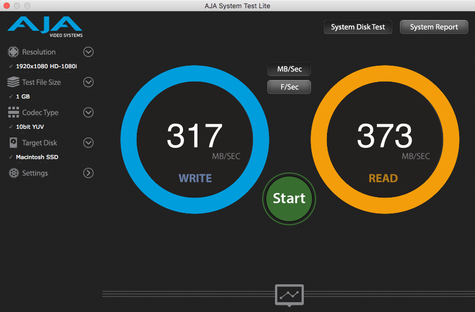

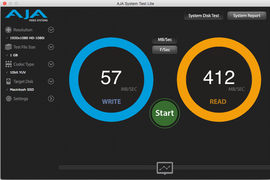

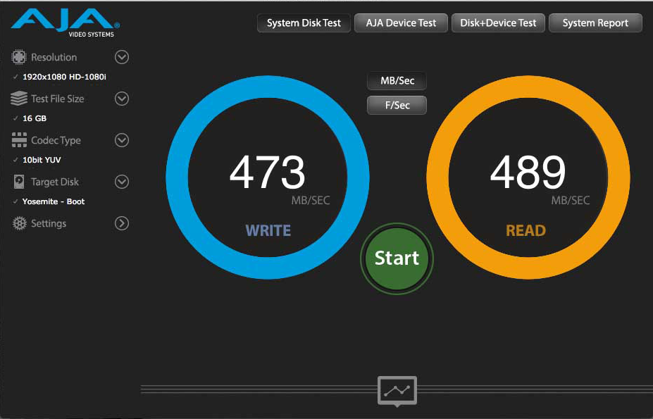

I just purchased an OWC Accelsior S and I'm really underwhelmed. I'm getting 50-70 MB/s Write Speed using a Sandisk SSD Plus. When that drive was connected via the stock SATA connectors on my 2010 Mac Pro I was getting 120 MB/s. Is there something I should know?
I am running Sierra, 12 Core Mac Pro, 3.46ghz.

I've got one too (Accelsior S), and the speed has been as promised. Do you have TRIM enabled on your SSD? If not, then the writes to SSD will eventually suffer a lot. SSD cells/blocks have to be emptied before they can be written to. SSD does this emptying at the time when the TRIM function tells them to do so, and when it is ok to do so.
You might want to tick trim function on (terminal: sudo trimforce enable), and then find a way to manually trim all SSD blocks. There are graphical software and there was another way to do it. It might have been the single user mode and fsck -fy. Please verify this last one from google/internet before trying.
You should get your SSD write speeds up.
I did go to terminal and type sudo trimforce enable. but that didn't change anything.
[doublepost=1509563781][/doublepost]Update, so I moved the accelsior from PCI slot 2 to Slot 3, and the ran SUDO TRIMFORCE enable again and now I am getting much better speeds.

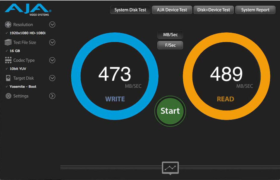

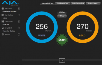

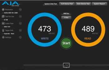

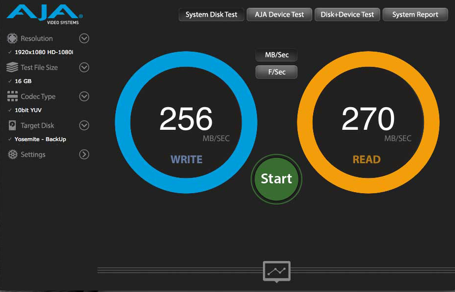

I am running five Samsung SSDs. One SM 951 and four 840 devices. All have TRIM enabled. Two are mounted on the SATA bus. The other three are on PCIE cards. Attached are my write/read speed readings. The first is an 840 on the SATA Bus. The second is an 840 on a Velocity x2 PCIe card.
Note: You may have guessed from some of my previous posts, that I am no fan of OWC.
TinyGrab Screen Shot 11-4-17, 4.37.30 PM.png TinyGrab Screen Shot 11-4-17, 4.42.15 PM.png
Lou
Did you try to enable TRIM yourself? It is not self enabling except with an SSD identified as an Apple device.
View attachment 732304 View attachment 732305
Lou
