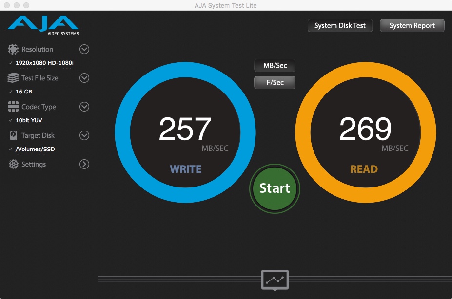

I am running five Samsung SSDs. One SM 951 and four 840 devices. All have TRIM enabled. Two are mounted on the SATA bus. The other three are on PCIE cards. Attached are my write/read speed readings. The first is an 840 on the SATA Bus. The second is an 840 on a Velocity x2 PCIe card.

I just installed the AJA utility and ran it on both of my ssd’s (both on sata, no trim enabled) and got identical results to yours 😀
Maybe because I never really delete anything.
I have a sonnet tempo card and ssd on the way, so hopefully that should show double the speed.

Got my Sonnet Tempo card......
SSD in SATA port
SSD in PCIe port
Still not enabled Trim......🙂
Reactions: djjaes and h9826790
