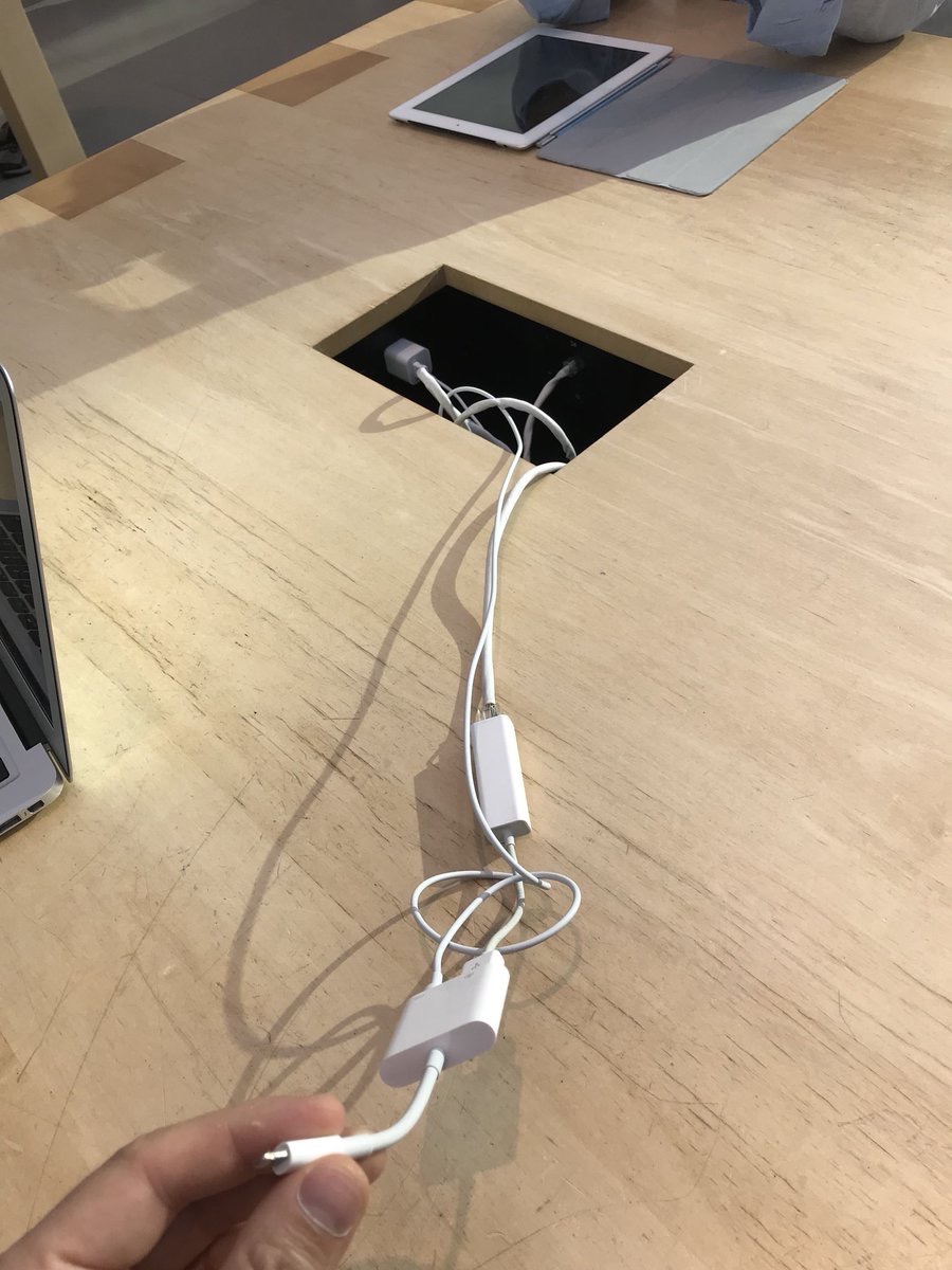

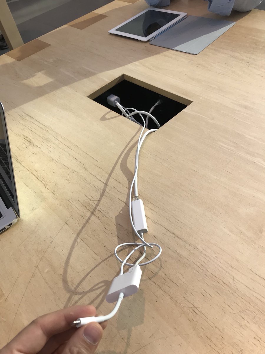

It works. I just saw them using it at the apple store the other day. Plugged up my iPhone 7 and voila.
