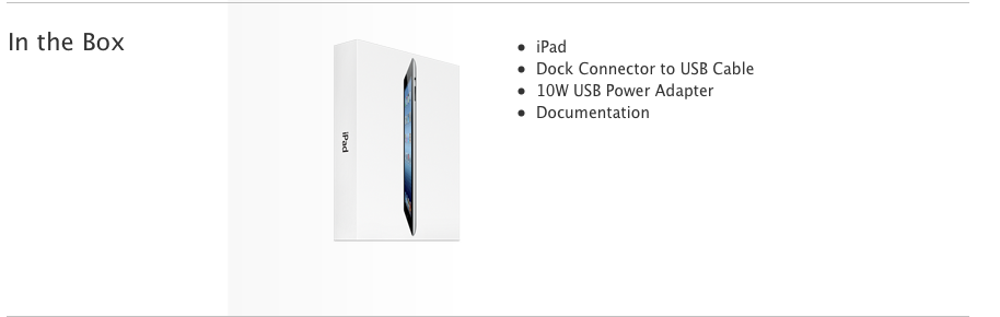

I wonder if the new iPad will come with a more powerful charging brick to compansate
Same 10 watt charger. It's a bigger battery than the MacBook Air 11", which requires a 45 Watt charger. I'm betting that this will take forever to charge, and will be nearly impossible with the iPhone charger which I used to carry for portability's sake.

The battery has been increased 70% in size and we still get a 10W charger.
I hope it doesn't mean we have to wait 70% longer for the iPad to charge. The iPad 2 - approximately 4 hours to charge; the new iPad - possibly 7 hours.
