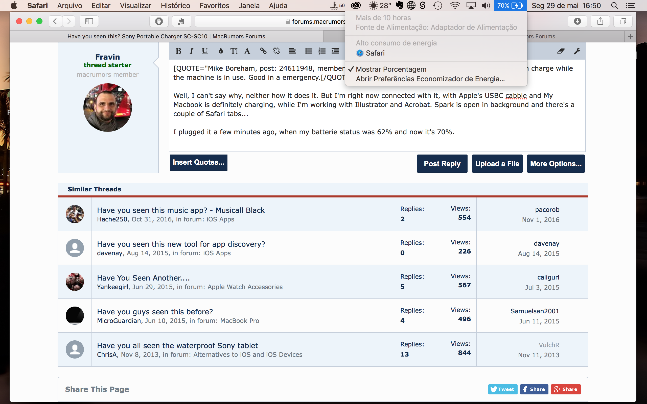

Well, I can't say why, neither how it does it. But I'm right now connected with it, with Apple's USBC cabble and My Macbook is definitely charging, while I'm working with Illustrator and Acrobat. Spark is open in background and there's a couple of Safari tabs...
I plugged it a few minutes ago, when my batterie status was 62% and now it's 70%. I'll post a new screen capture a few minutes latter. Sorry, but my system's language is Portuguese...
In System's Profile it says:
Informação do Carregador AC:
Conectado: Sim
Voltagem (W): 15
Carregando: Sim
That could be translated as:
AC Charger Information:
Connected: Yes
Voltage (W): 15
Charging: Yes​

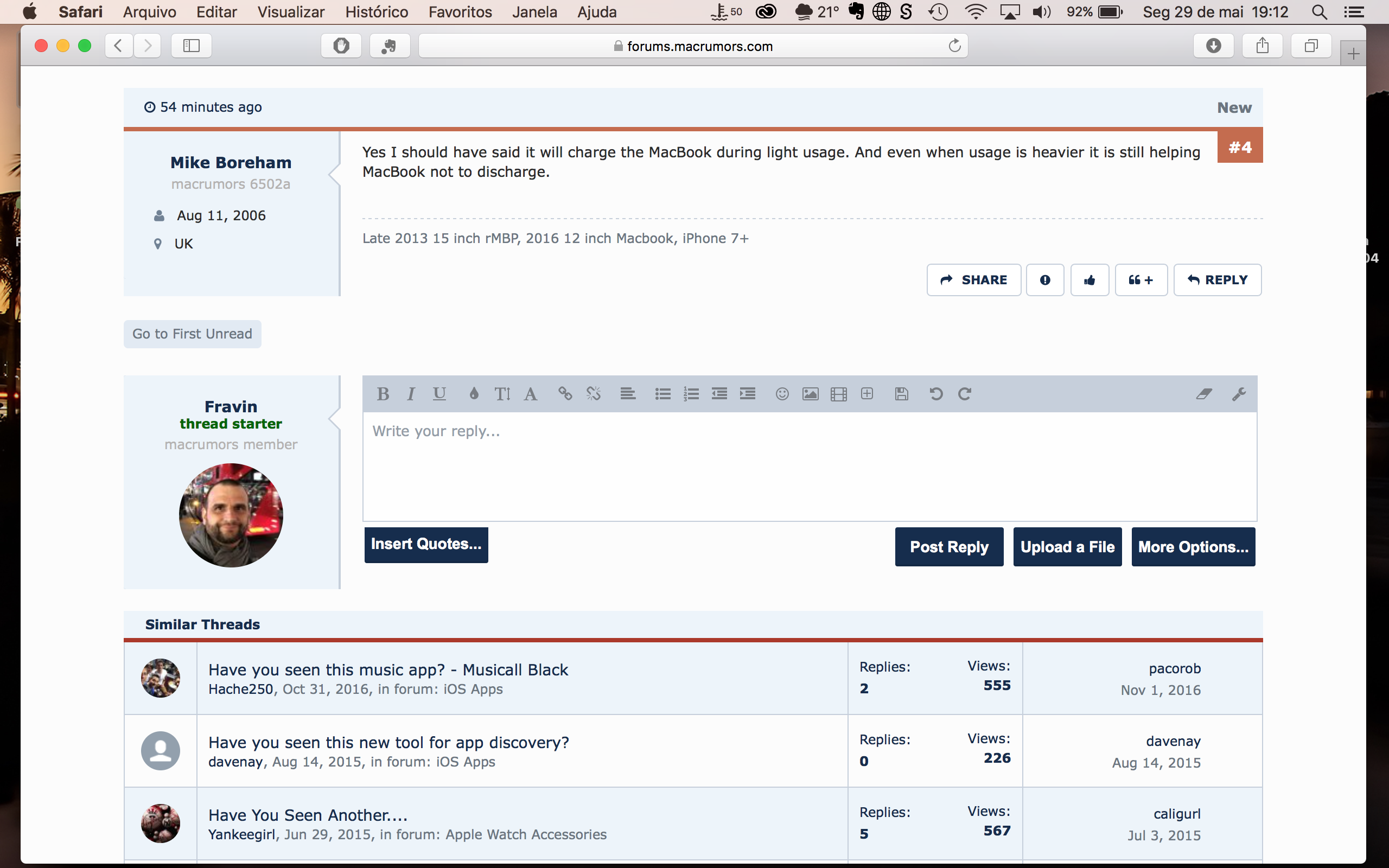

Yes I should have said it will charge the MacBook during light usage. And even when usage is heavier it is still helping MacBook not to discharge.
Take a look...
93% after almost two working hours...
