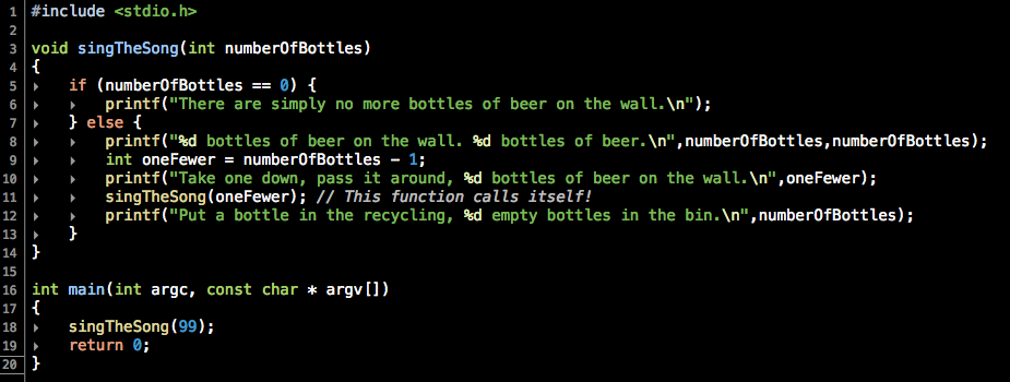

OH, where this came from was in trying to explain this program, and how that last printf does the recycle bin part:
Code:
#include <stdio.h>
void singSongFor(int numberOfBottles)
    if (numberOfBottles == 0) {
        printf("There are simply no more bottles of beer on the wall.\n\n");
    } else {
        printf("%d bottles of beer on the wall, %d bottles of beer.\n", numberOfBottles, numberOfBottles);
        int oneFewer = numberOfBottles - 1;
        printf("Take one down, pass it around, %d bottles of beer on the wall.\n\n", oneFewer);
        singSongFor(oneFewer); //This function calls itself
        // Print a message just before the function ends
        printf("Put a bottle in the recycling, %d empty bottles in the bin.\n", numberOfBottles);
int main(int argc, const char * argv[])
    singSongFor(4);
    return 0;
Apparently many people can't figure out how that last printf works, without calling itself or recursing somehow... I guess it sort of recurses, and blows through the stack. How would someone program around that if they only wanted it to happen once?
But if 'sum' were local to the function, main wouldn't have access to it for the final print, unless it passed it to main on a return.
The Suming function already returns sum at the end of the function. Not only does it do that, but main assigns that returned value to a new local variable named sum (which shadows the global variable of the same name).
All the weirdness here with that variable makes me think a mistake was definitely made somewhere. Properly written, there shouldn't be a global variable called sum and the Suming function should declare a local variable called sum before using it.
It works by the same mechanism as above, the function is not allowed to reach the bottom and return, instead it's called again and new stack frames are added until the end condition is met. At that point the stack "unwinds" backwards until all stack frames are gone. The variables in each stack frame are local, unique copies with values that reflect the state at the moment the function was called.
Consider this function that prints a string in reverse, putchar() prints the first character in the string, what ever that was at the time the function was called. The variable *string is a unique copy in each stack frame, keeping the state from the time the function was called.
Code:
void reverseString(char *string) {
    if(string[0] != '\0') {
        reverseString(string +1);
    putchar(string[0]);
Since *string is a char pointer, string +1 just advances the address to the next character. '\0' is the null character which terminates a C string.
