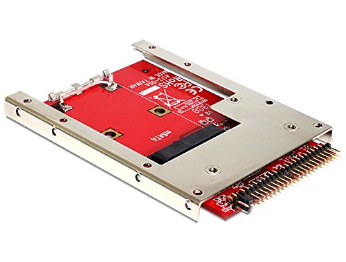

Buy any mSATA SSD and an IDE enclosure. I have the same model laptop as you and used a 128GB Samsung mSATA SSD and a cheap no-name enclosure from eBay with excellent results.

what do you mean by "cheap no-name enclosure"
Glad I saw this thread, the hard disk in my iBook just died. Bought a 128gb Samsung mSATA and an enclosure for just short of £25. Hopefully will get the system back up and running.

Any standard height mSATA SSD should be fine. For the record, I've never seen any other than the standard height, but I just say that in case you would stumble onto something abnormal. The adapter I bought specified it at 1.8 inches or something like that.

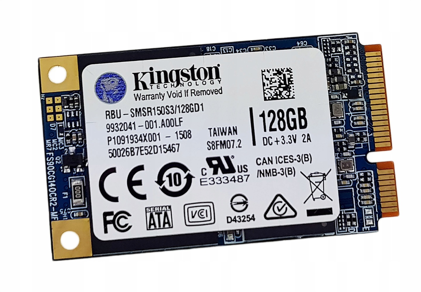

I just bought the same case type that Hughmac mentioned. Now is time for mSata drive. I'm thinking about Samsung (photo above) and Kingston 128 GB (photo below).
4f72bd0648eb89ad05f9590e2152
ok - thx again.
Either should be fine. They're the same capacity, and any minor speed difference between them will be negated by the fact that you're using it on an PATA bus. I'd buy whichever is cheaper.

I use the cheapest 240 GBytes one from Amazon + the best mSATA-IDE44 converter on my 17" GHz PB.

That converter makes the battery last longer AFAIK

I’m using a 250GB Dogfish 2280 m.2 with a generic m.2-to-IDE enclosure (similar to the mSATA-to-IDE enclosures, except for m.2) on my A1139 PowerBook. By and large, it’s worked well.

Thanks to the advice I gleamed from this thread, I have an SAMSUNG SSD PM851 mSATA 128GB in a 2.5" IDE converter working in my iBook. Performance isn't bad at all, boot time is seems very fast indeed. So glad to finally have the system back up and running! The msata adapters are definitely the way forward, the SSD cost me all of £18 and the adapter less then £5. If any of my other systems go down, I'll be swapping the mechanical drives out for one of these.
