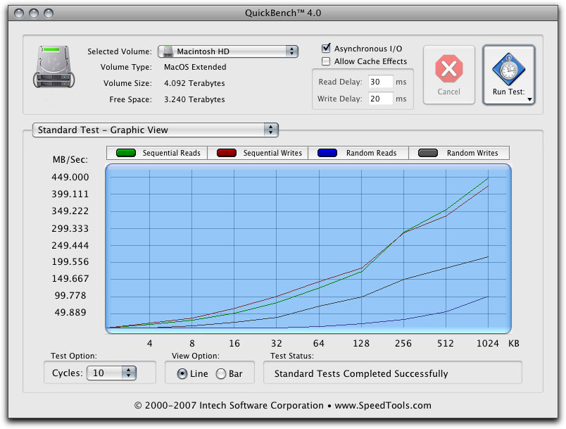

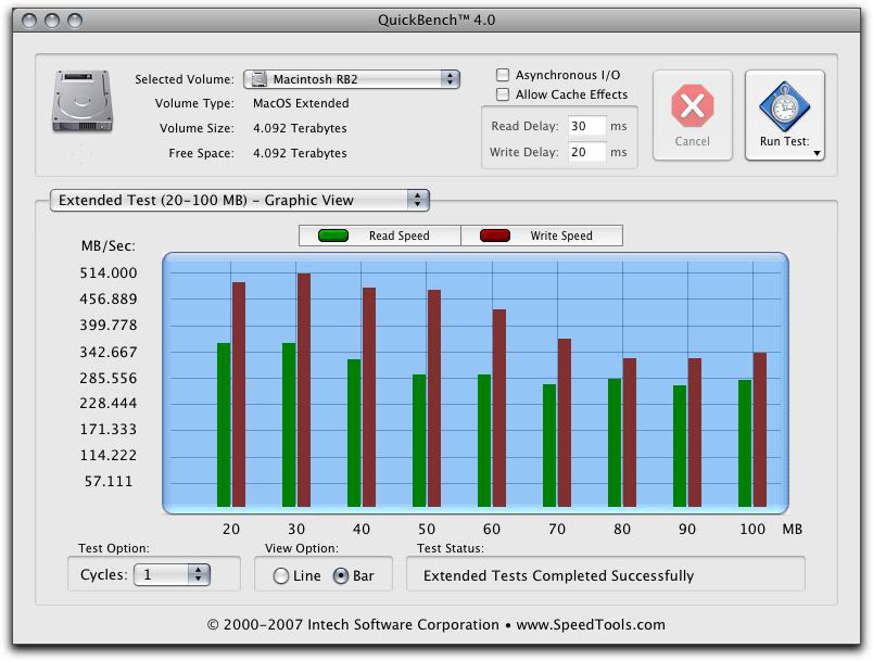

I just got four 1.5TB HD154UI F2 EcoGreen Raid Class drives for $97 each and configured 3 of them into a RAID0 configuration. This is a step along the way of my project to fit 12 HDDs in a Mac Pro case - gracefully. 😉
Anyway, I thought it might be useful to share with the gang how they profile as setup in Apple's software RAID0 configuration. I selected 128K block sizes for the RAID because when I'm working it's usually with large data like video or large images. This will waste a little extra space and add to the margin of error when calculating folder and files sizes in some software but should be worth it for larger files.
So without more verbosity here are the benchmark results:
The red patterned bars are Writes and the red solid bars are Reads.

Oh, nice, I didn't know that Samsung had finally released their high capacity new generation HDDs. How do you like them? I'd been eagerly awaiting the next tech bump from Samsung. Also, I didn't see on the website where drive speed was - are these guys 5400 rpm (like I presume the 'green' moniker refers to) or 7200 rpm?
Companies making green drives are a little tight about that in specific but I know they're variable speed. Probably around 3500 RPM ~ 5600 RPM but the density is now at 500 GB per platter so they achieve essentially the same data rates as a 7200 drive with 386 GB platters. A little faster in some areas, and a little slower in others.
So far I like them OK! They run 5c to 8c cooler, rated higher (60c instead of 50c), and they're between 100 MB/s to almost 200 MB/s faster than the drives I'm coming from (in a 3-drive RAID 0). They're a little slow to spin up to ready but I mostly leave my machine on 24/7 so I don't care so much about the difference. Samsung says they take 13 seconds to be ready but it's really more like 9. Some drives are like 5 and 6 I think tho. This might matter more to me when I have all 12 but there might be a sunny side to that too - the breaker at the mains won't pop when I turn on my machine. 😛
I don't believe there is such a thing as man-made global-warming (it's all a scam to initiate a global tax structure in order that the money might be used for war and tyranny) but it's nice that my power bill will be 50¢ less a month I guess. 🙂
In all they're heads and shoulders above my 1TB WD Green drives and probably profile more like a 1TB black. So, yeah, I like'em prety good. 🙂
