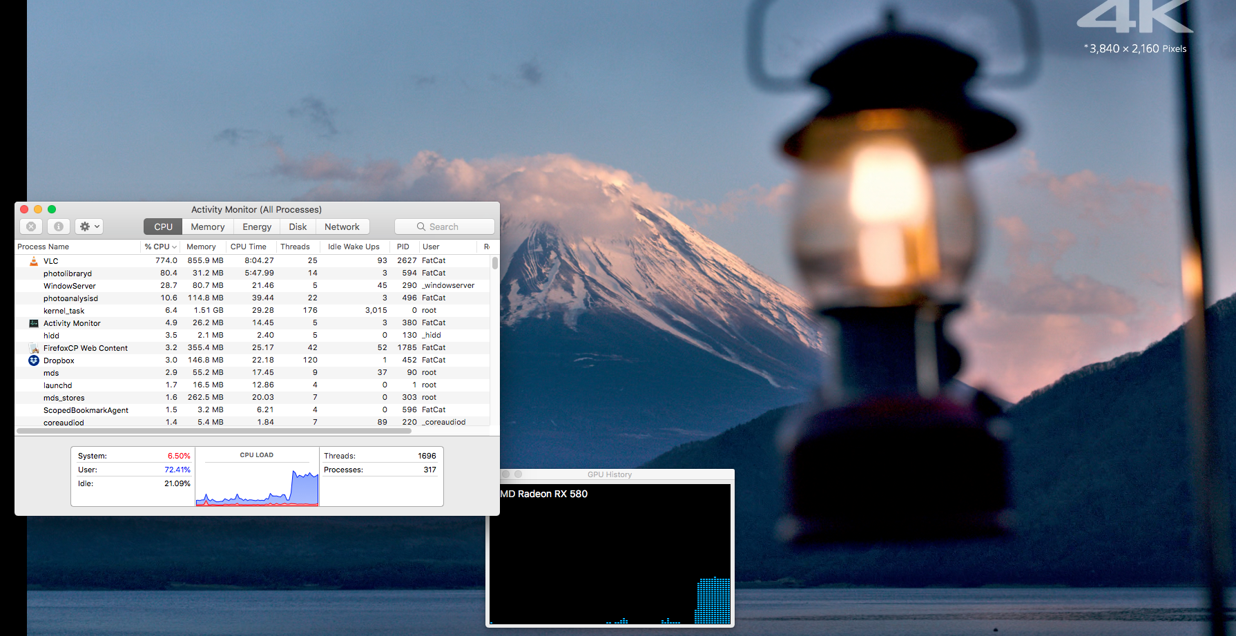

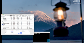

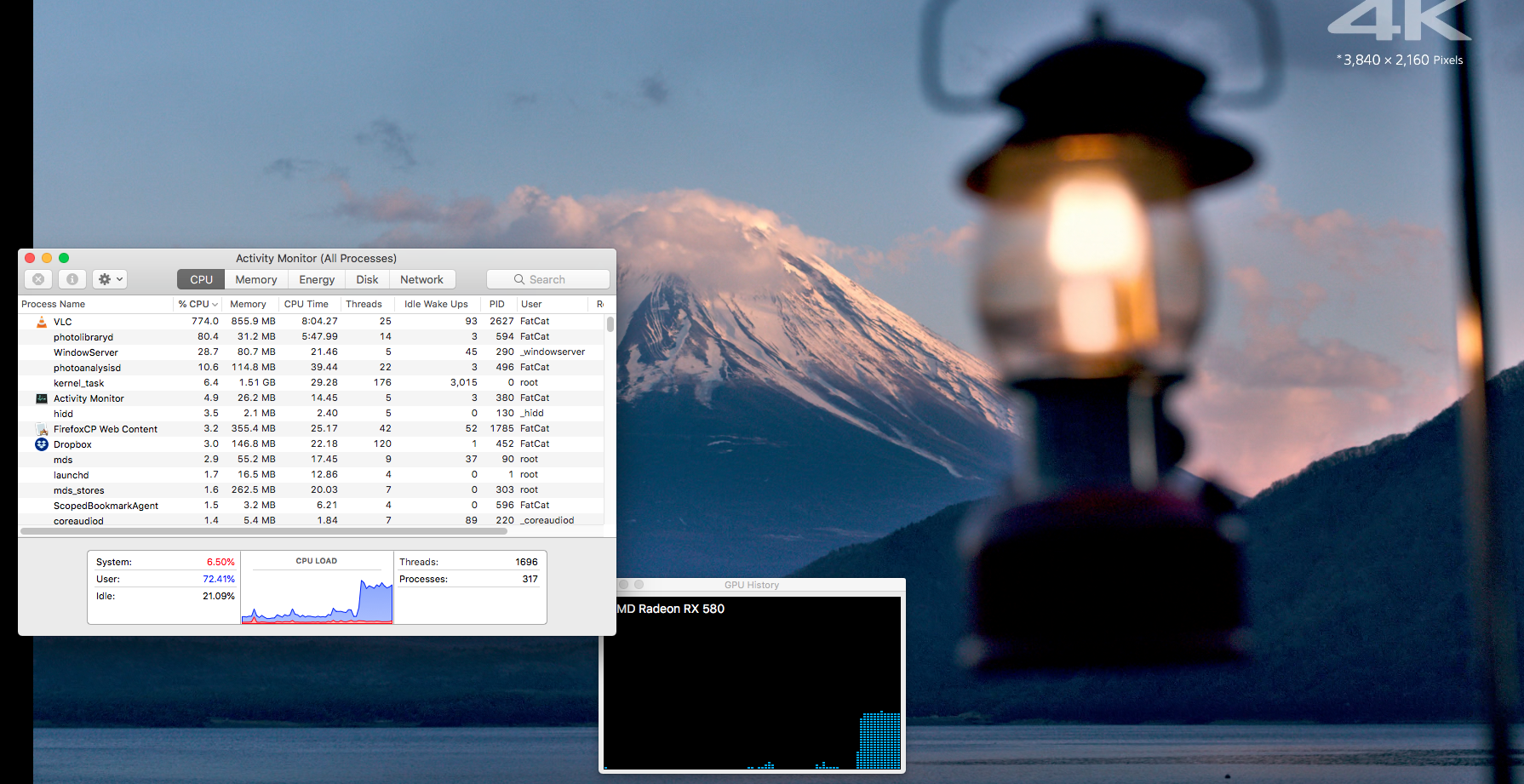

VLC got updated, plays the "Sony Camp 4K Demo" relay well now. osx10.13
not perfect but seems best playback for me, gpu & CPU seems more used (i think?)
Reactions: h9826790
well i tried on windows and depressing to see 1% cpu use and same or less gpu use to play the same file.
yes your correct but for me QuickTime cant play the file back without drooping a lot of frames at least it looks like VLC can brute force it.
Strange, in my case, all QuickTime, IINA, VLC can do hardware decoding smoothly. And QuickTime is the best because of no over saturation issue.
