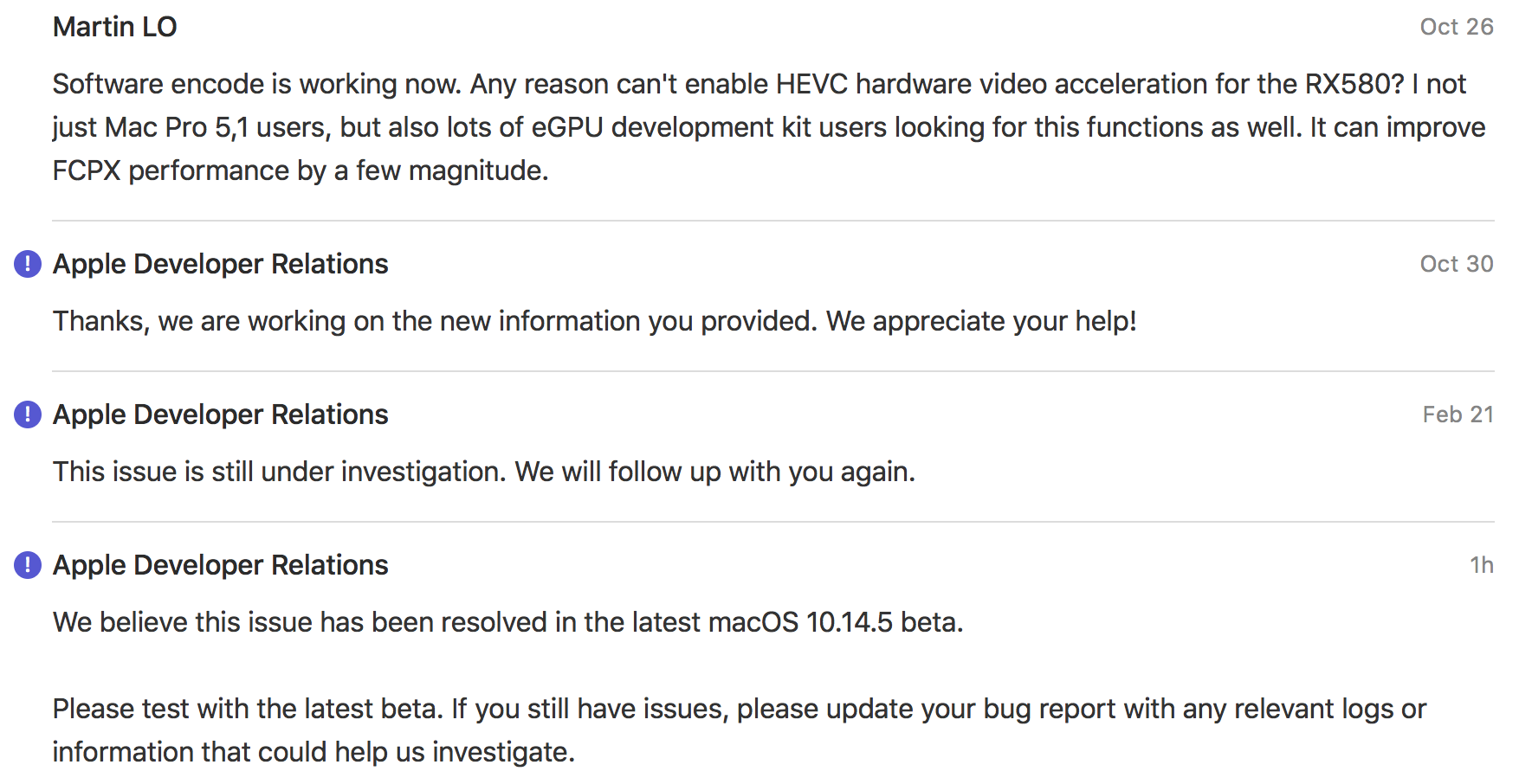

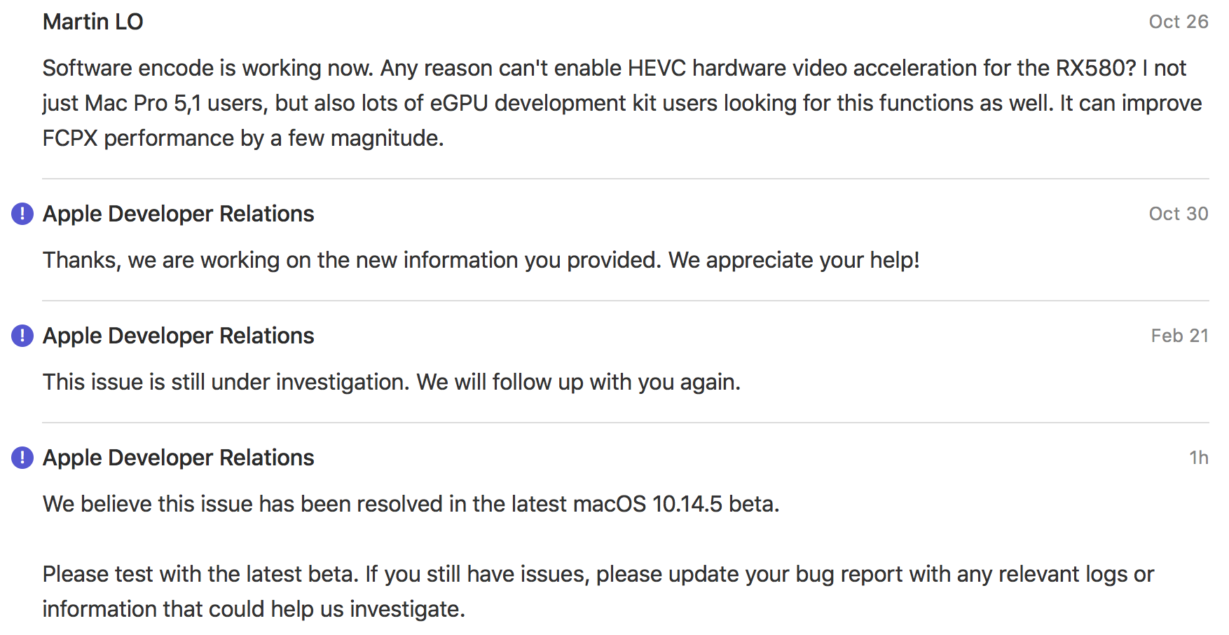

Please try the latest Mojave beta. I just got this yesterday.

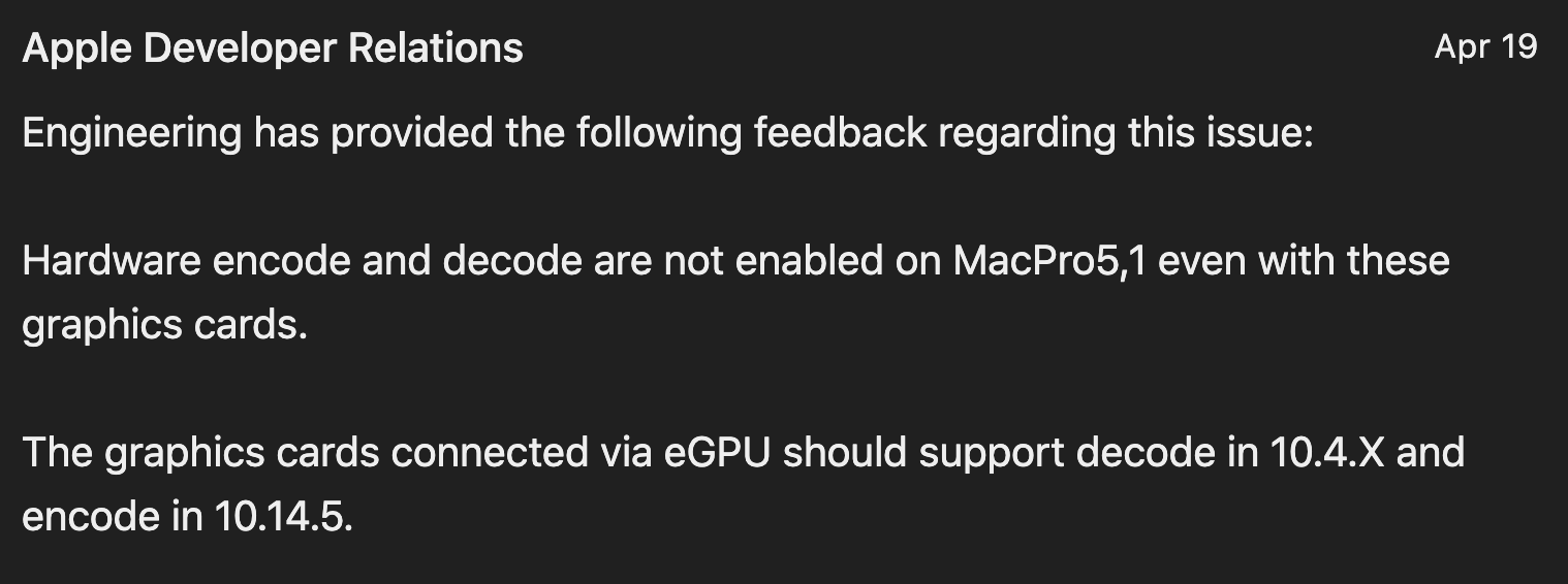

After my post earlier, I went ahead and updated my test system to 10.14.5b to see if we might have gotten lucky w/ some H.264 or HEVC acceleration. From what I can tell, it's still the same. While GPU usage is pretty high in QT Player on those Sony videos (probably 70-90% sometimes), so is CPU usage, at 300-500% or so. Trying to play back in FCPX 10.4.6 is a bit choppy and I was even getting a momentary "blink" to a black frame every few seconds.
I'm encouraged that you got that response, but I'm curious what exactly they're referring to...
The bug report is about "GPU hardware encoding fail". So, despite I asked them to "enable HEVC hardware video acceleration" in that particular reply. May be they only enable something like H264 encoding, but nothing else.
The bug report is about "GPU hardware encoding fail". So, despite I asked them to "enable HEVC hardware video acceleration". May be they only enable something like H264 encoding, but nothing else.

Okay, so it doesn't appear to be working for me. Have you tried it on yours yet? Do we know for sure what Developer Relations actually means when they say the "issue has been resolved"??
Not yet, I just switch back to my Mac Pro 5,1 few hours ago. Have some work to do right now. And will be out of town in the next few days. So, can't update to 10.14.5 beta and run any test yet.
But I contacted Apple again to confirm their meaning of "issue has been resolved".
Apple haven't get back to me yet.
Few more users reported Airplay options shows up in Developer preview, but not working (Airplay Desktop require GPU hardware encoding to work properly).
My own test with Public beta has same result. No GPU hardware acceleration for any H264 / H265 encoding or decoding. And Airplay shows up in system preference.

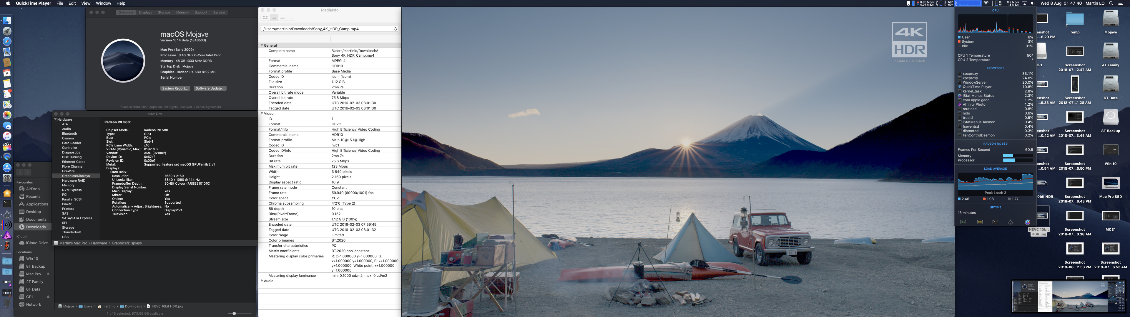

The Vega on iMac Pro can actually do the hardware decoding (and obviously it's a dGPU).
Also, it's confirmed that the RX580 (the same GPU as in the Apple eGPU developer kit) also able to perform HEVC hardware decoding in the current 10.14 beta. I have this GPU in my Mac Pro now. I have done the test by myself (as per the following screenshot). 4K HDR HEVC BT.2020 video can be play back smoothly in QuickTime Player on my Samsung CHG 90 with just the RX580.
I tried to show you the required info in a single unmodded screenshot (I only remove the serial numbers).
The video is the Sony_4K_HDR_Camp.mp4, it's widely available on the internet. Clip info as per Mediainfo shows.
CPU is very low workload (but QuickTime is working). The CPU is W3690 (as per my signature), and definitely not capable to doing any HEVC 10 bit high bitrate decoding in both software and hardware method.
GPU is the Apple recommended (for Mac Pro 5,1), Sapphire PULSE RX580 8GB. Which has reasonable workload when decoding the video. And system info confirmed that was the only GPU installed, and displaying 30-bit colour.
iStat showed both the CPU and GPU usage, plus the monitor was working at around 60 FPS (because the video was playing at smooth 60FPS). If the video was not playing, it will be like this (2.2 FPS in this case). Also, no QuickTime shows in the CPU process because no demand from it.
Or if the playback is not smooth, then it will shows the playing frame rate. I use IINA to play the same clip with software decoding. CPU was stressed to 1000%, only 10FPS (The colour seems over saturated in IINA as well)
And if I was playing around the mouse pointer etc to achieve higher FPS, then it will easily jump to 144FPS because CHG 90 is a 144Hz monitor.
Anyway, I think this is good enough to show you that MacOS can play HEVC 10bit HDR BT.2020 smoothly with dGPU hardware decode. And this is on a 9 years old Mac Pro without Skylake (or newer) CPU installed.
