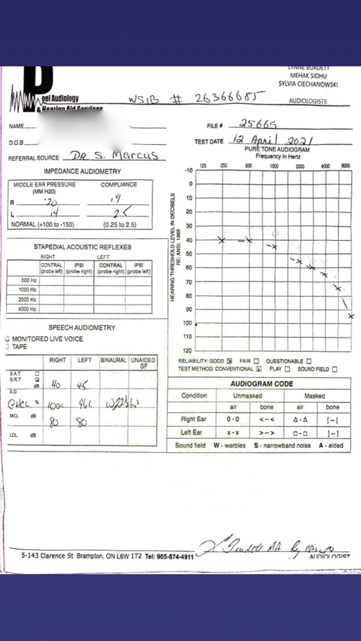

Here's my last hearing test at Peel Adiology who sold the hearing aids and set them up numerous times.

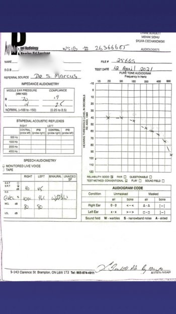

both ears were tested--bad photo of the hearing test.

Yeah, I was wondering if both ears had been tested......

O's are your right ear, X's are your left ear. You have a mild sensorineural hearing loss 250-1000Hz, sloping to a moderate to moderately severe sensorineural hearing loss 2000-8000Hz. Your right ear dips into the profound range at 8000Hz, not the end of the world because there's really no speech at 8000Hz. 250-8000Hz are considered speech frequencies, humans can hearing up to 20,000Hz. Your hearing loss is related to the inner ear or Cochlea. Your word recognition ability is excellent in both ears, 100% in the right and 96% in the left (missed one word). Tympanograms (Impedance audiometry) is normal and it would be unless you had a hole in your ear drum or fluid in the middle ear space.
People with your degree of hearing loss complain about the volume of the TV (or more accurately the people around you complain), they often say they can "hear" but it's not always very "clear". Soft spoken individuals are problematic, and hearing when there is a lot of competing background noise is difficult.
For your hearing loss no manufacturer recommends open domes, semi-open (Tulip) or closed. If closed domes bothered your ears then I would suggest you ask for a set of custom RIC molds to be made. You have too much hearing loss in the low frequencies to use open, if you do use open then you won't get any amplification at 250-500Hz. What'll end up happening is you'll complain you can't "hear" and if they could jack up the mids and the highs you'd perceive the sound as too tinny or sharp (if Phonaks software allowed and you didn't get feedback). Phonak has some of the worst feedback cancellation in the industry, so I'm not sure your problems are going to be solved by just going to their new Paradise hearing aid which really isn't that different from the Marvel you probably had previously. Because of that, their software will get aggressive in limiting the high frequency gain to prevent feedback. In turn if you're not getting the necessary gain 1000-4000Hz, you will struggle to hear clearly. If you are able to make suggestions about what you'd like, I'd look into the Oticon More (absolutely phenomenal) or Resound One.
