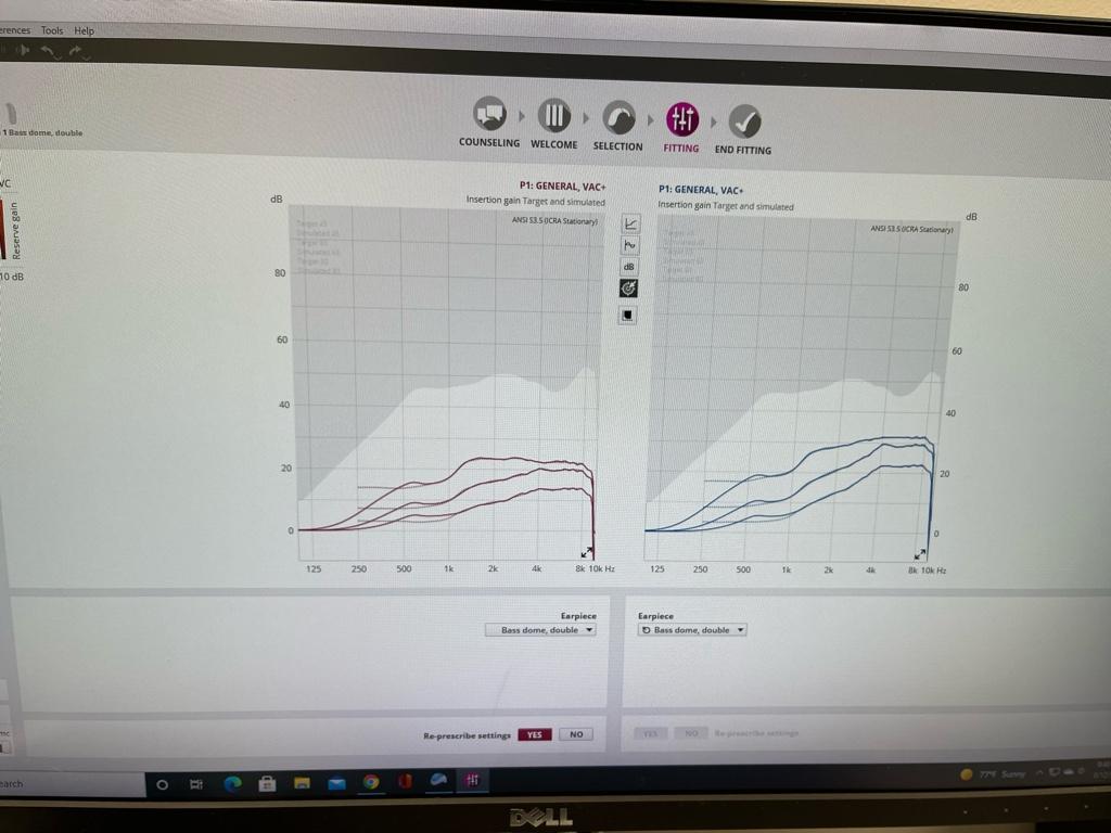

Phonak's software wants to cut all low frequencies in your right ear, doesn't matter open or closed. Which means if you just put a closed dome on the right side you're going to struggle to hear someone next to you on the right. Phonak's targets have never made much sense to me in regards to prescribed gain for a given hearing loss. If the previous audiologists recalculated your prescription for an open dome, your mids and highs are getting severely tuned down to prevent feedback, as I said early. Couple that with no low frequency gain and that right HA isn't doing much for you. I'll attach the difference in prescription from an open vs. closed on Phonak and then what another manufacturer wants to prescribe and you'll begin to understand what I'm talking about.

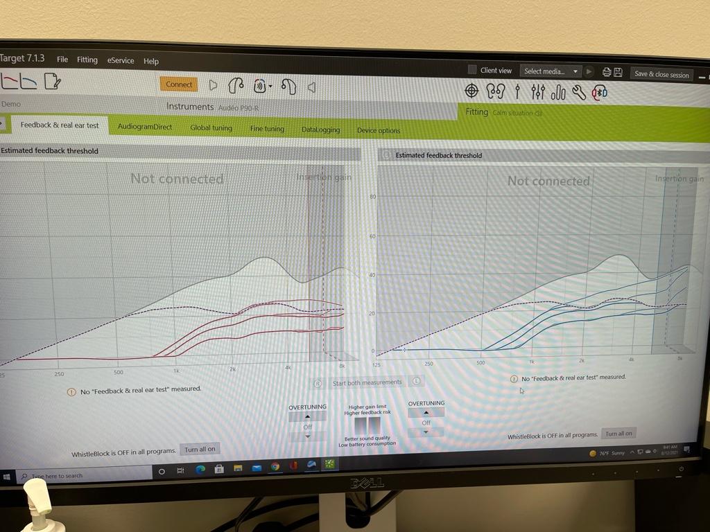

This is your hearing test used when I did this and Phonak Paradise P90's. The first pic is the prescribed gain for an open dome and your hearing loss. The dotted line over the top of the solid red and blue lines is Phonaks feedback manager preventing the gain from reaching the fainter lines which is the target for your hearing loss. Notice there is zero gain below 500Hz and in you left ear (blue) 2000-8000Hz is getting limited to reduce feedback. As I've said before, Phonaks feedback cancellation is some of the worst and most aggressive at using gain reduction (something you don't want if you're trying to get someone to hear better.

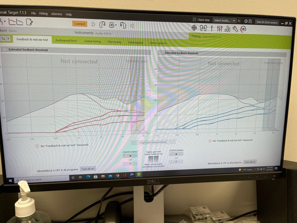

This is with closed domes, which Phonak's software recommends for your hearing loss. Notice how the software isn't crunching down the highs (esp in the left ear) as much. That's because the risk of feedback is greatest with open domes as opposed to closed domes. Nonetheless, Phonak's software doesn't want to give you any gain in the right ear below 1000Hz. Something I don't understand why Phonak does that when you select a closed dome and the patient has a hearing loss at 250 and 500Hz.
This is an Oticon More 1 set up for your hearing loss, notice the difference? This is with closed domes. 🙂
Thank you so much for taking the time and showing me this!
edit: I see substantial gain at 250, 500 to 1,000 Hz in the Oticon More 1.
